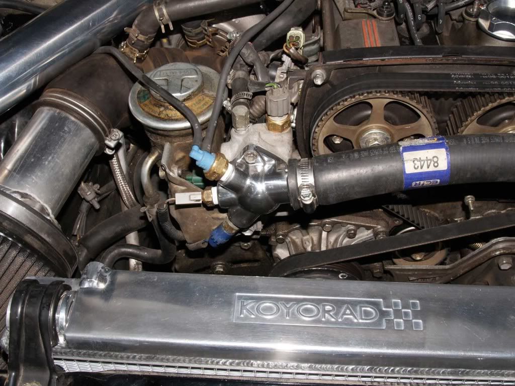

Well, here's a leak that I sprung. It's been leaking for about a month and a half.
The second pic are the parts that are going in. Woo Hoo for polished stuff.
Bling Bling baby!! :D

Where did you order that piece? Mines leaking in the exact same place. Or did you just polish it, cause i know you just got the t-stat seal/ring thing and a gasket.

The T-Stat housing was a spare that I polished. I'm not the greatest polisher type guy; but, I found it to be pretty easy. Valve covers are next! :)

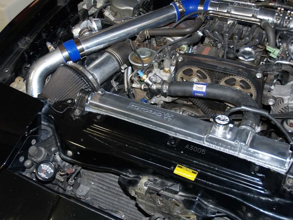

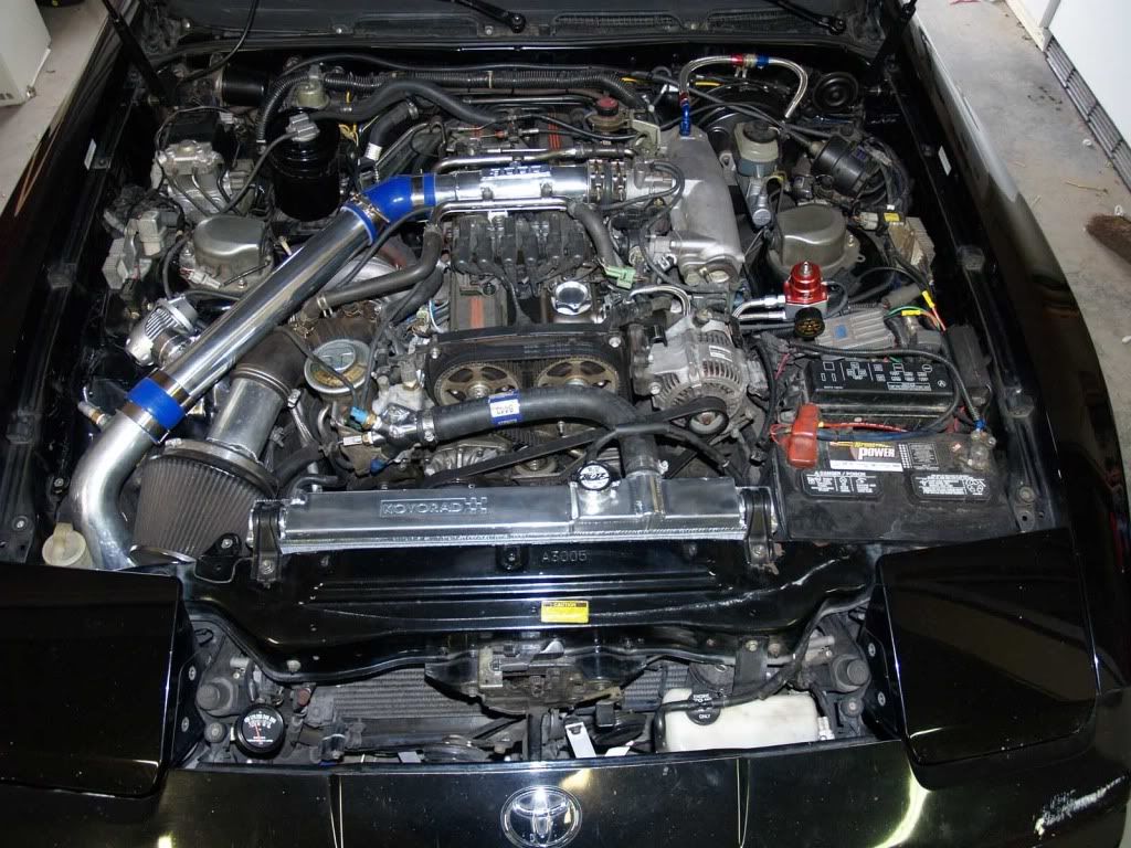

Here are a few new pics. These include shots of the newly installed Polished T-Stat Housing and Temp Gauge.
The T-Stat Housing is in it's typical location. ;)
The gauge is next to the left Head Light.
The last pic is a shot of the current underhood setup.

I didn't even know you could polish the t-stat housing, and hey guess what! Mine leaks there too, yay! Its fun too share a bunch of the same problems, i just used a crap load of high temp silicone, it looks crappy but it works.
If it's aluminum.....it can be polished. BLING'n Baby! :biglaugh:
Yeah, the previous owner used a bunch of silicone sealer on mine. That made a bunch of work for me though. It was a pain to get all of it off. It took a chisel, sandpaper, scotchbrite pad, and around 40 minutes of my time to get it clean enough for the new gasket to make a good seal.
Hopefully, you won't run in to that. I was angrily blaming the previous owner the whole time. Who will you be blaming?! :sarcasm:;):biglaugh:
