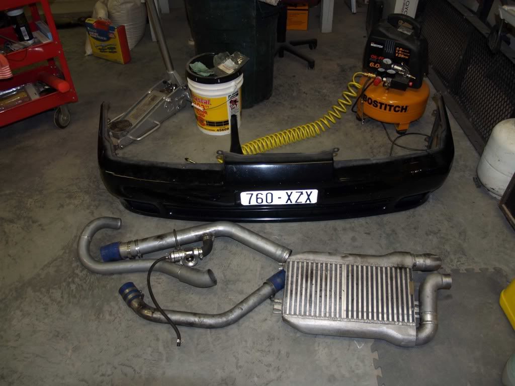

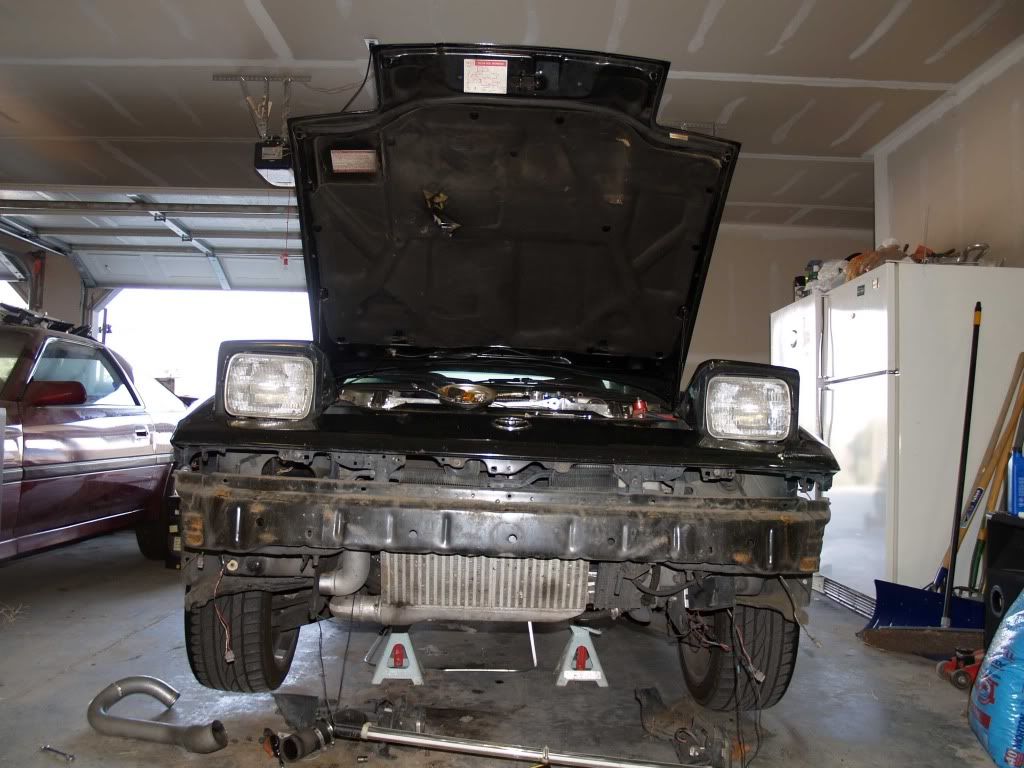

Here's tonight's progress. It's amazing what you can get done without having to deal with an attacking stray dog!
Bumper off shot...
Intercooler and all piping removed...
Old, ugly, IC Pipe and Intercooler...

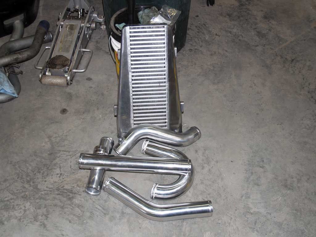

Ok. Here's my new IC and Pipe. The one with multiple bends has the bung for my IAT Sensor welded on it.
Speed Density here I come! :evil2:

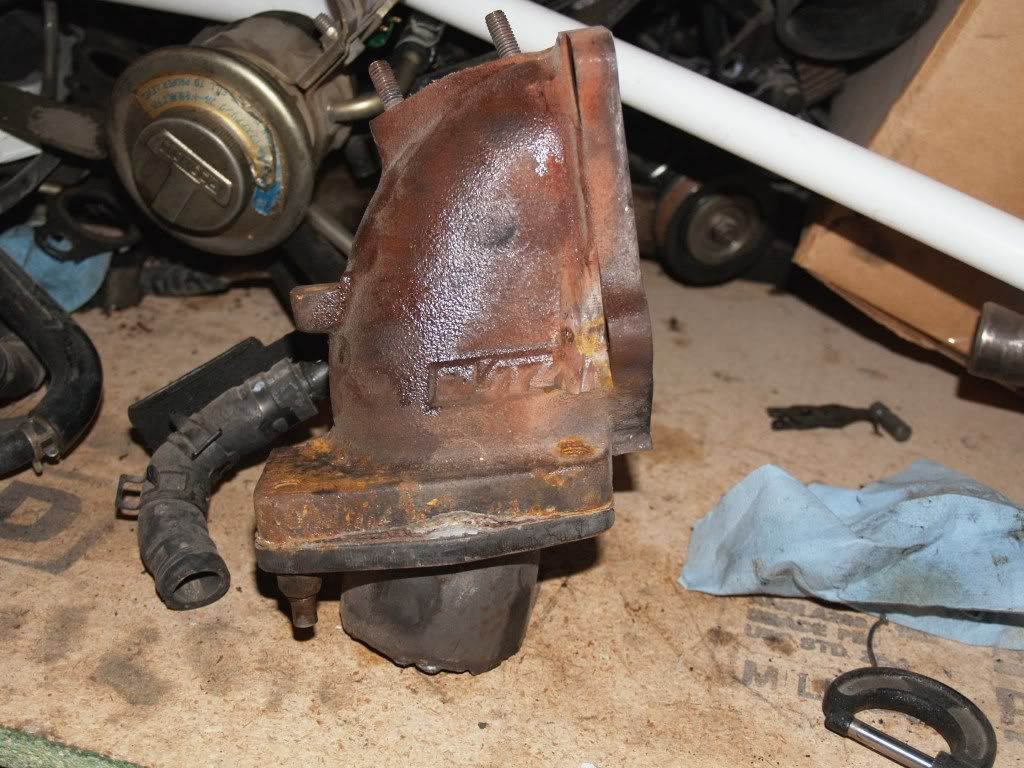

I am currently swapping one of my spare motors into my 89 so I can sell it. I'll need that turbo for that project. However, I do have another one. Its on my 89 right now and I do not know anything about it because the car wasn't running when I bought it.
If you're not in a huge hurry, I can let you know the condition when I get everything swapped around!

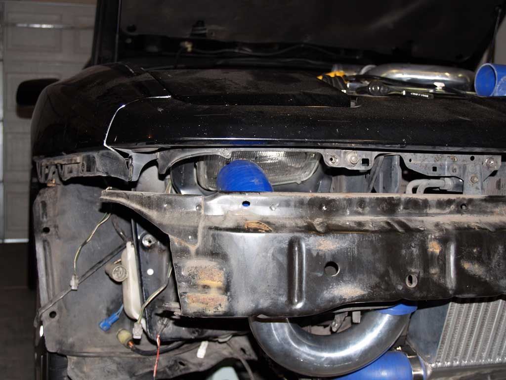

Here's a pic of Test Fit #1.
Everything from the Turbo Inlet to the Intercooler went ok. I had to put a stress bend on one of the couplers; but, it should be fine.
I then started working upward and ran into my first snag. Everything fit nicely with the headlight up; but, as soon as I put the head light down....well....the pic says it all.
I won't be able to get any adjustments made until Monday...

LOL... Yeah, we had the headlight up so we could have more room and forgot to put it down. :biglaugh:
Not that big of a deal. I think shortening the U-Bend and using a 45 instead of a 90 degree coupler will do the trick; but, we'll see...

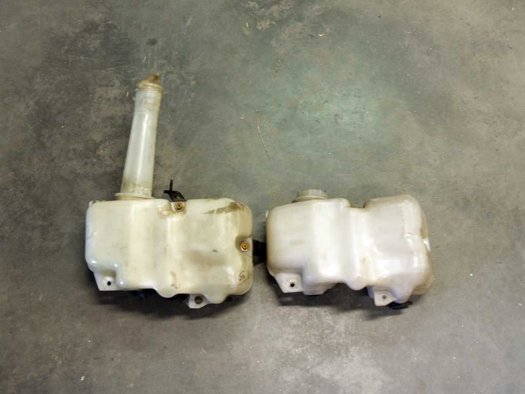

Can you believe that the numbskull that owned the car before me cut the top off of the windshield washer fluid tank to accommodate for the IC Pipe!?!?!!? Some people...
The one on the left is off my wrecked 87. There is a slight difference between the two. The 87 has the Headlight Washers so it has an extra pump. Three pumps total on the 87 tank. The 91 only has two because it doesn't have the Headlight Squirters. Therefore, I had to plug the valve on the third pump so all of the washer fluid wouldn't leak out.
