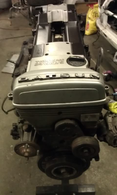

Rod Bearings and Bolts done...i cant start putting the motor back together and hopefully drop it back in soon.

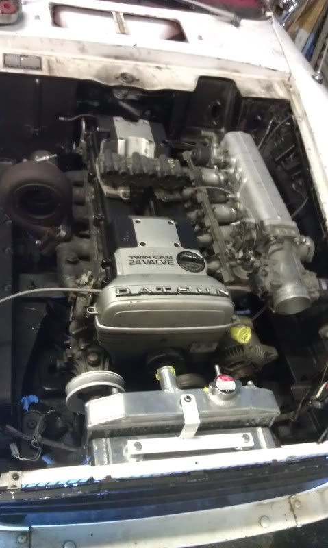

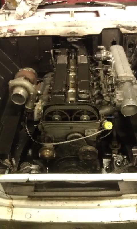

Motor went in this weekend....fun stuff....forgot to take a pic of it in there but i am excited.

motor is bolted down, trans is bolted down. intake is back on. baby steps lol

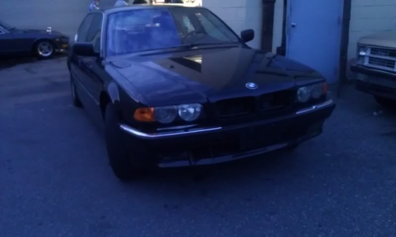

00' 745il ....it kinda just fell in my lap at an amazing price...needs a motor and trans
6,625
You know, I really like that generation of 7, but was never crazy for the stretched wheelbase versions. Can't afford a driver, you see... :p

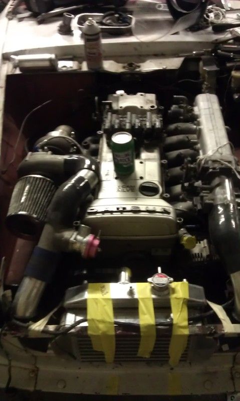

yea it fits....i had in there with the motor already, took it out along with the clutch master afterwards...
for reference

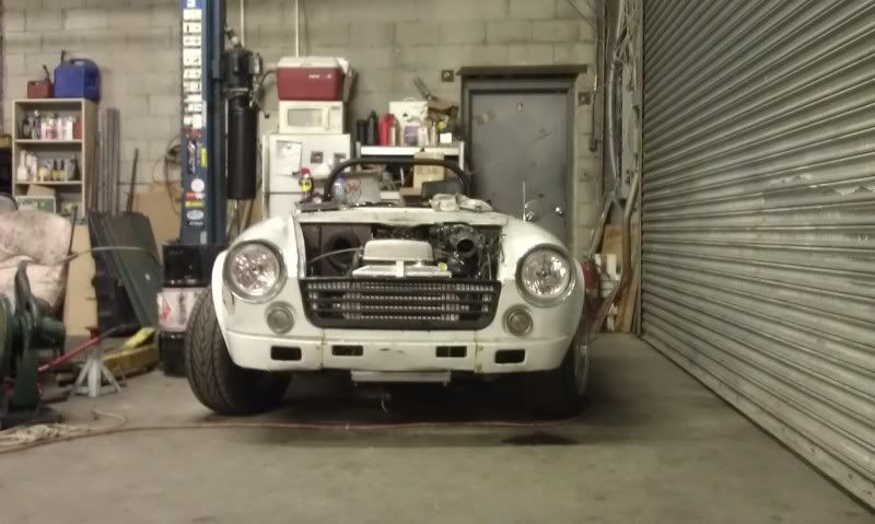

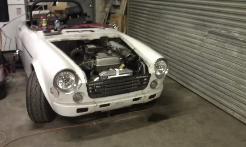

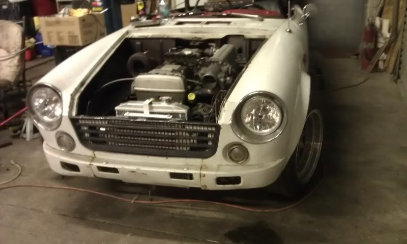

started to put things back together, bought some cheap headlights for the time being....just trying to plan things as i go.
Waiting on a few things then i'll start the wiring process.

Also, is that a double stack radiator setup on that last picture there?
