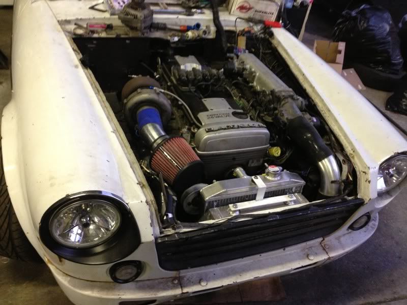

Nope just a small intercooler and a small radiator....we shall see how that goes.
I got a cheapo small t3 turbo for now....
Going to start wiring soon and start working on the fuel. Down pipe is almost done.....points to the ground now.

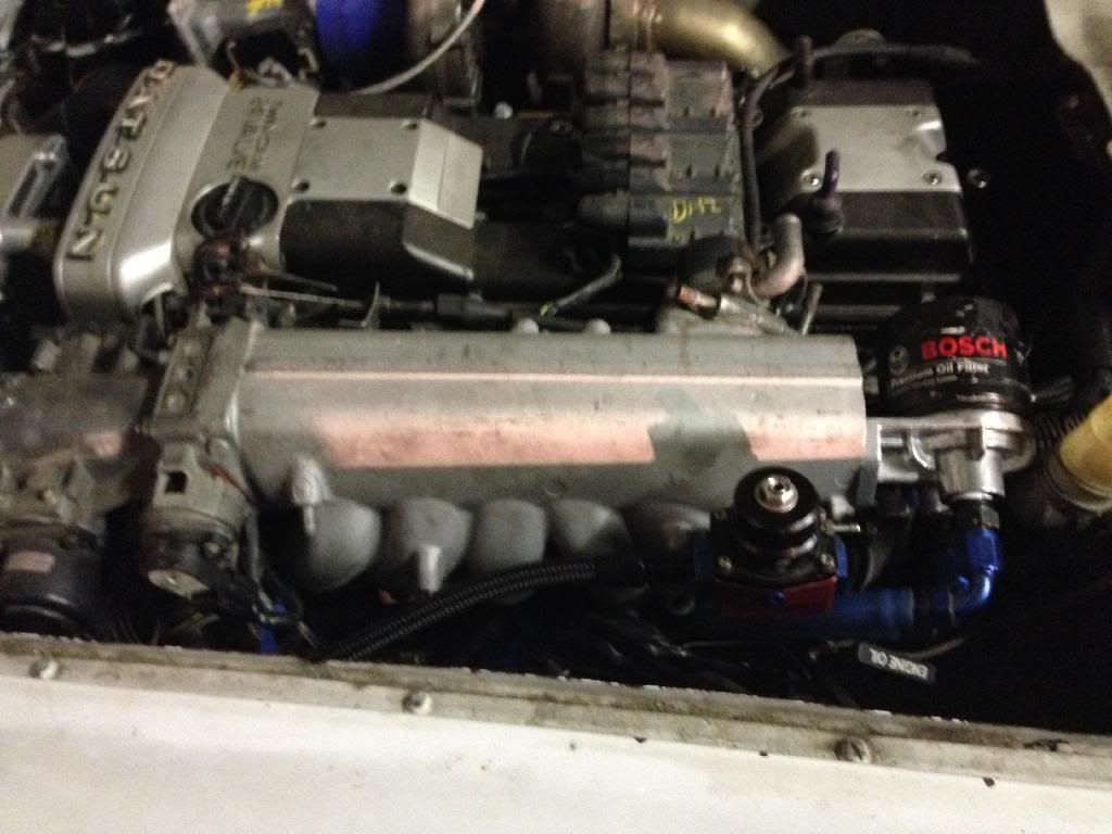

So after a long summer i Finally was able to get back to working on this....

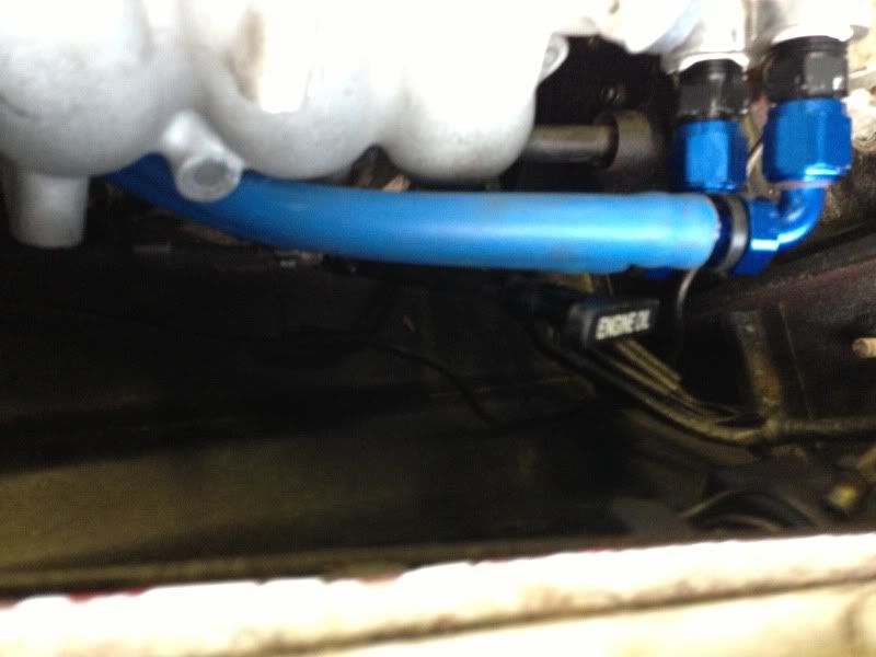

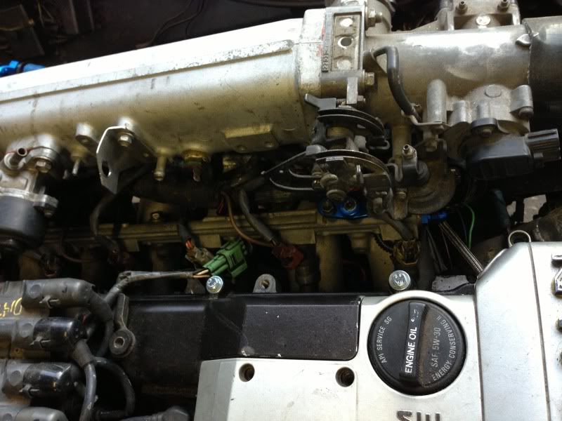

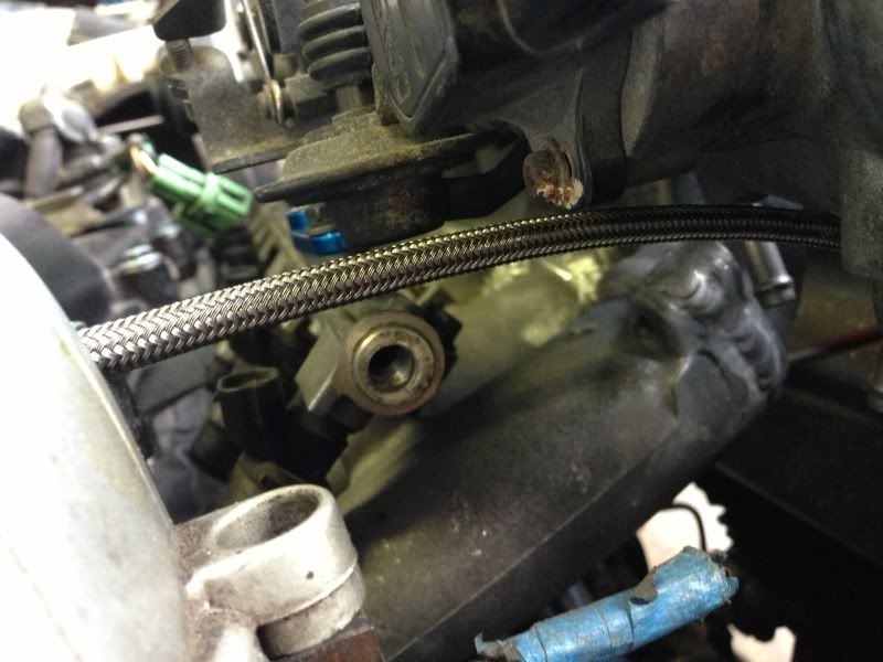

Drilled and tapped the fuel rail since i couldnt use the stock return location because the throttle body was hitting the fitting. Plugged up the original.
I also moved the dipstick and welded a new mounting tap.
I did the oil filter relocation, i'll add a cooler later on.
Added a new filter.

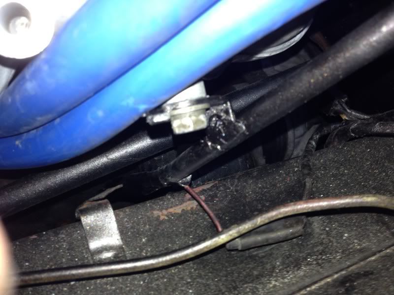

Started to do the wiring.....not the best of pics

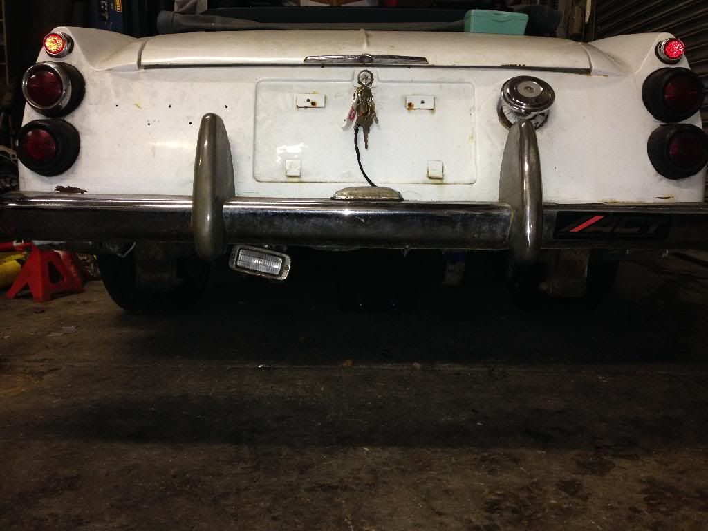

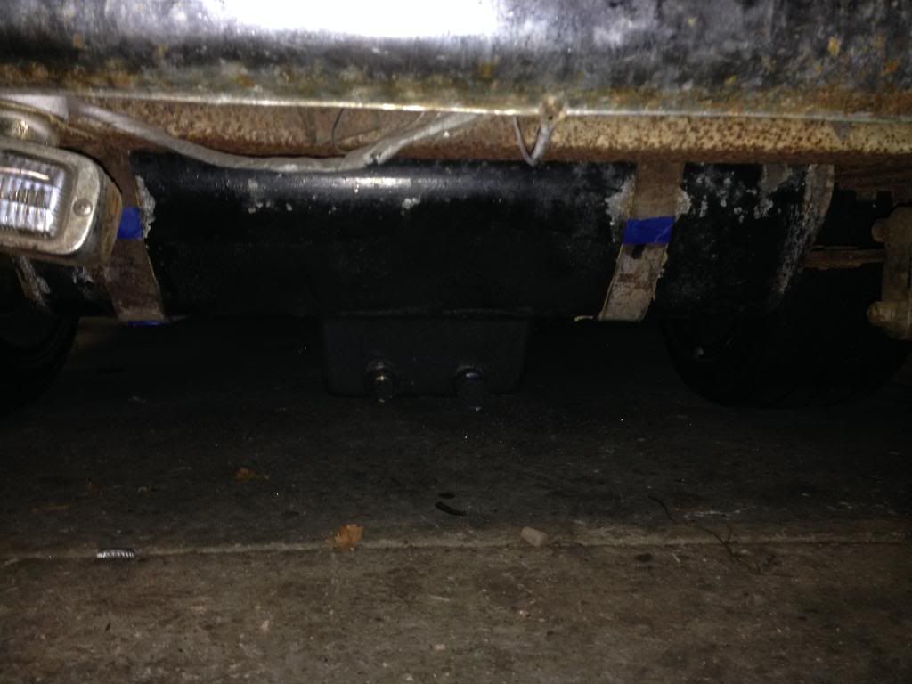

I installed the tank last night, had to remove two broken bolts and re-tap the existing hole. Either way its in there and i had to hold down the insulation with some tape for now. Might look for some 1" leaf spring spacers to raise up the rear just a bit.
I like the fact that you can hardly see it, especially when its dark.
Here's a closer shot. I know I know, everything will be cleaned and taken care of eventually.
Next up pump, filter and lines.

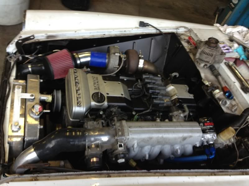

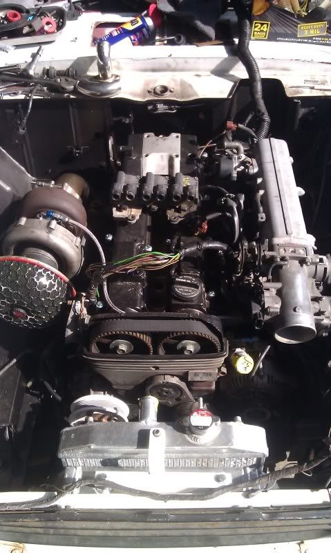

Got the car idling pretty well....coolant system is almost done and ordered some more parts.
Next is clutch system and brake system....

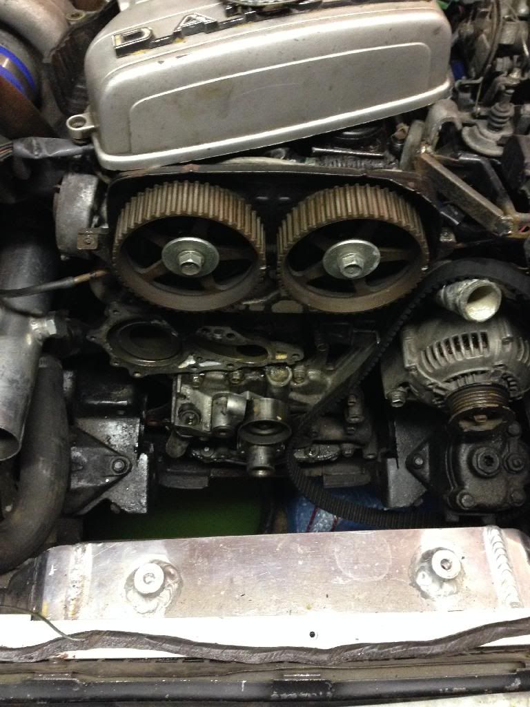

Had the car idle for a while, ran pretty well...However the water pump started leaking a great amount...so water pump swap
