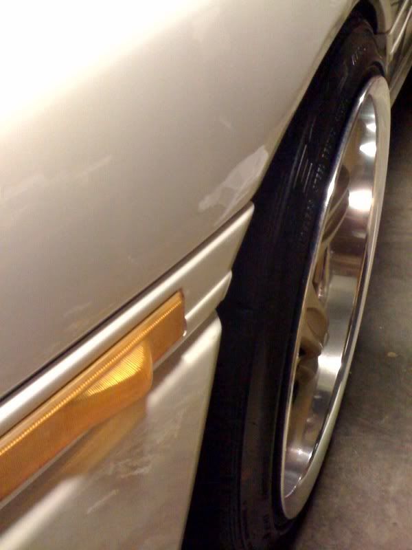

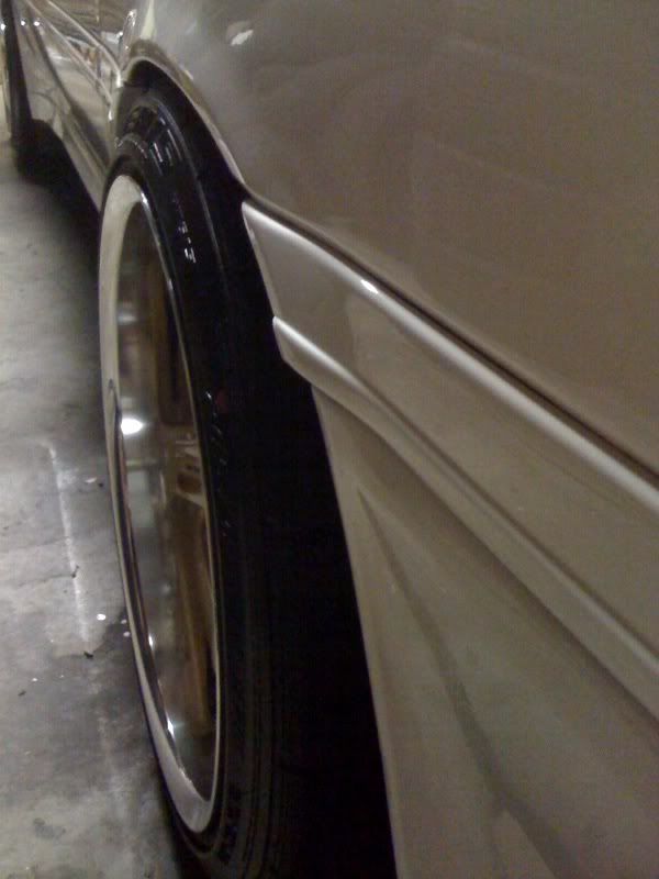

HIDPLANET
89 1JZGTE
Got iPhone snaps of my wheels on the car just thought to share.
Fronts are 18x10+30 Rears are 18x10+24
Fronts now have a 15mm Project Kics Spacer one them bringing them to 18x10+15 and the rears have Project Kics 10mm making them 18x10+14
Rear:
Front:
