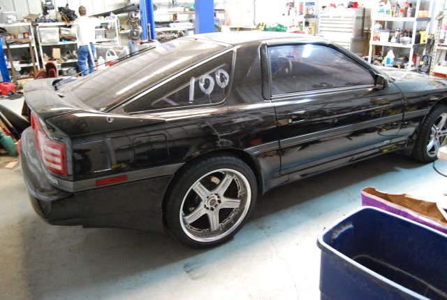

Wheels look good, I have some 19x8.5 +27 front and 19x9.5 +24 rear GTCs waiting to go on. Hopefully it's not too much to get to fit.
This was just a test fit, the wheel seemed to stick out a little bit...
HIDPLANET
89 1JZGTE
A 19x9.5 +24 is similar to a 19x10 +35 or thereabouts so you should be fine. Remember that the camber gets pretty drastic when the suspension travels up so the tire may clear the fenders if you go lower or are worried about wheel travel clearances.
