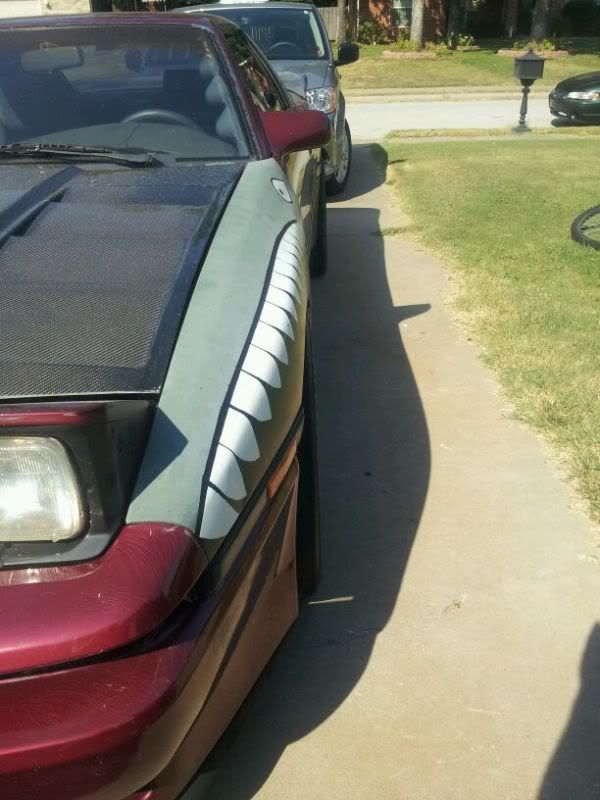

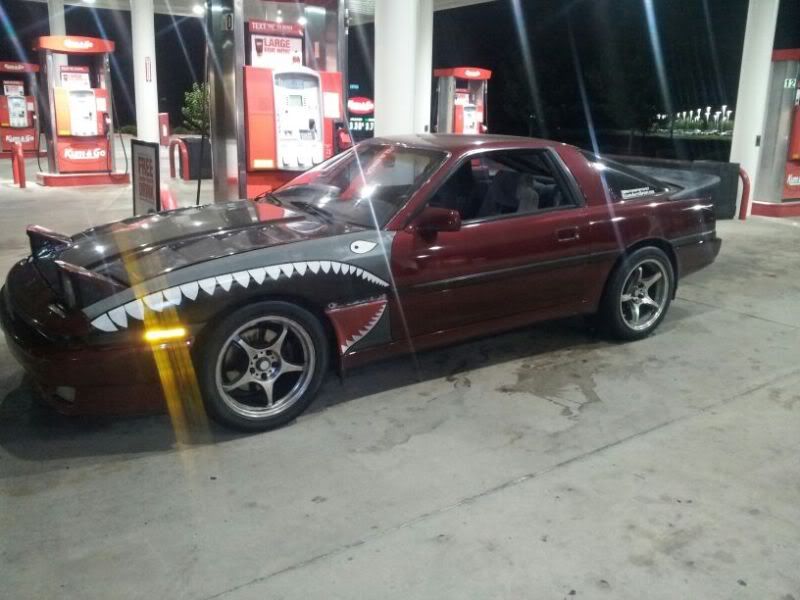

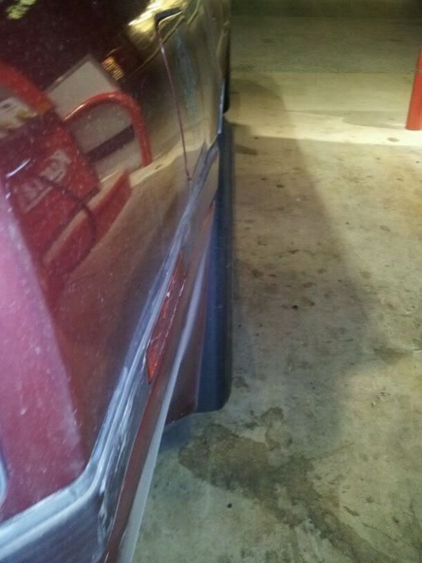

I run 18x10 +25 all round. Had to roll fronts, rears didn't need a roll with 265 but I rolled it to fit 285s.
Here's what the fitment looks like:
