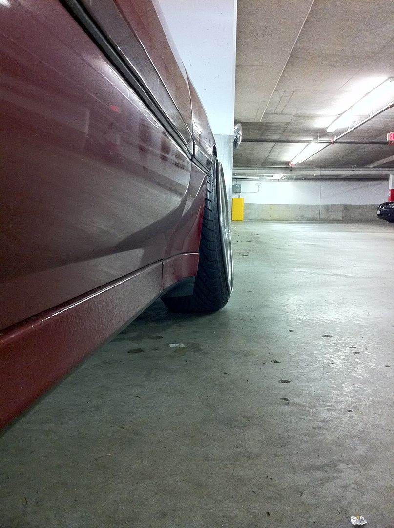

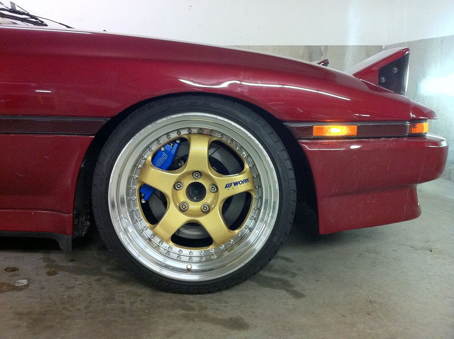

genesis195;1665484 said:
I have still to hold a photo shoot on my car. Weathers not been ideal, but got more shots of the set up. (using iphone haha)
*edit* had my bbk's installed a few days ago. Running on -5~ camber fronts right now as i needed negative camber arms and extended nuts and, spacers to properly fit the brakes in.
<-- a bit exaggerated since it's on a slope.
