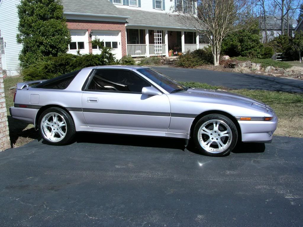

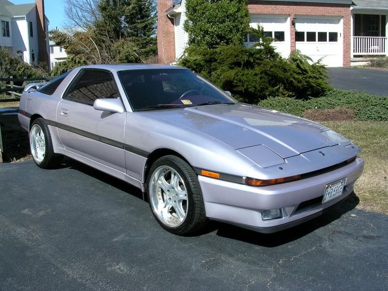

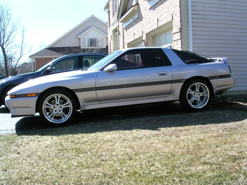

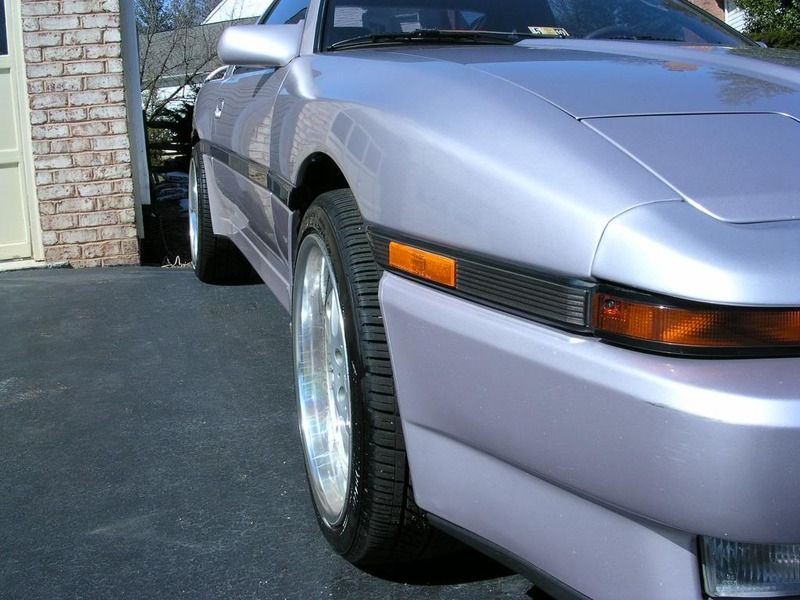

18x9.5 +12 Fronts, 18x10.5 +12 Rears
Tires are 245 front 255 rear (I forgot the wall size), and I will be going a bit wider in the rear later. I'm not dropped yet so I have no rubbing, but I'll probably need to roll my fenders when I do drop it.

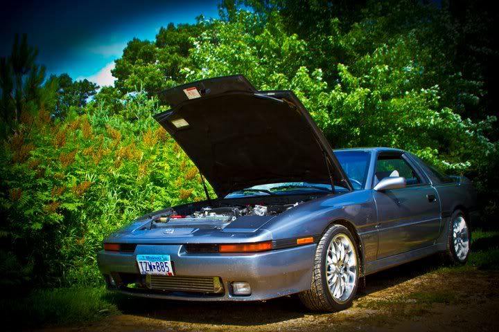

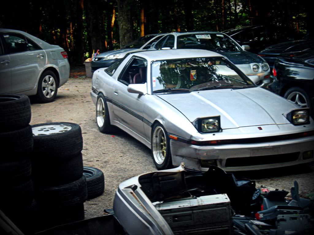

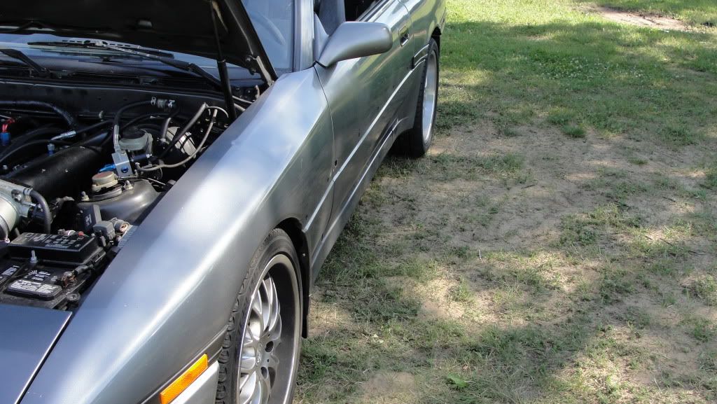

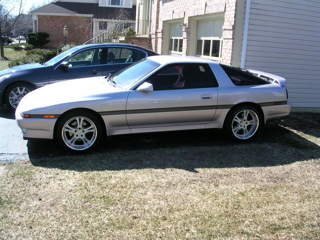

I think these work out nicely with spacing and such...
F- 18x8 +38, 10mm spacer, 235-40-18 Mich Pilot Sport A/S
R- 18x9 +38, no spacer 275-35-18 Hankook Ventus V12 EVO
RPM 505 rims, spaced in front 'cause they hit the ARZ brakes. Not doing spacers for the stance/look/whatever, they were cheap and fit well. People seem to like the fitment, however so I figured I'd post it up!
Current fitment:
older pic with diff tires and spaced out rears:

You dont go by lip size. You go by offset. +35 is will be sunk a little. +25 would be flush.
But yes those wheels would fit no problem.
