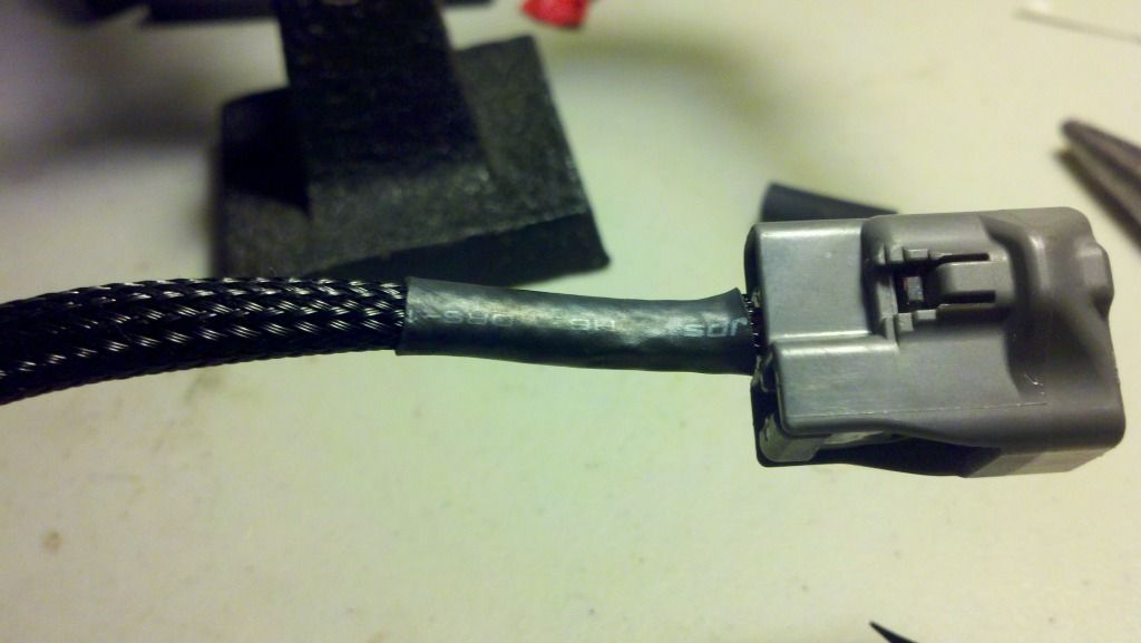

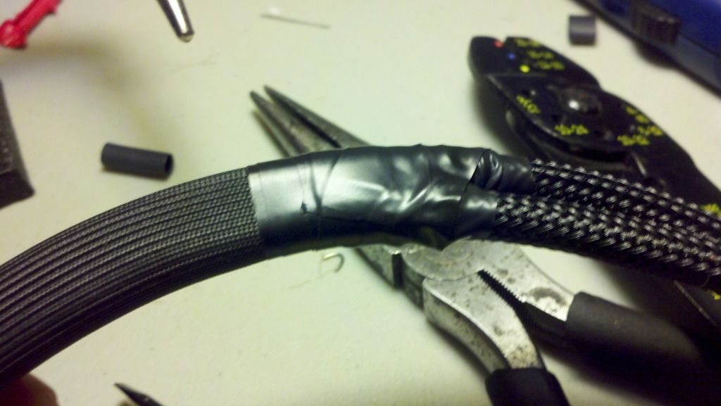

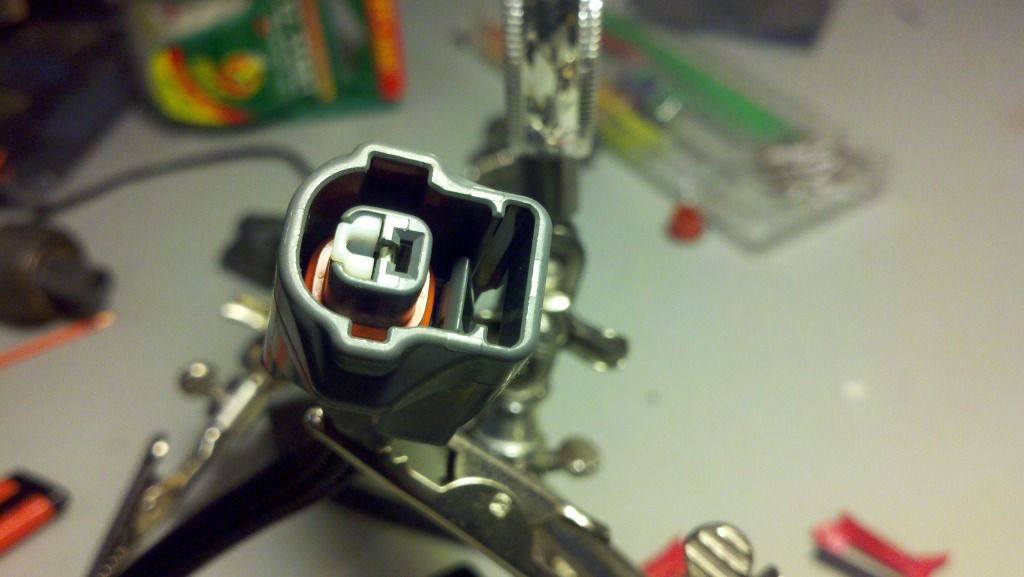

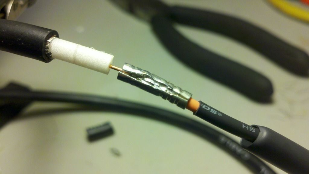

Anyway- Today was raining, so rather than replace the front ball joints on my MR2, I fabbed up a knock sensor rewire kit.
I've had a pair of newer style knock sensors, well, knocking around my garage for awhile, so I decided to make a harness for them. I already have a KS rewire kit on my car using the later style sensors, but I figured I'd
make a high quality kit to sell. This one uses two brand new factory plugs, crimped, soldered, heatshrunk, and mesh-sleeved connections. Then I fire-sleeved the main bulk of the harness till it reaches the firewall.
Finished it with a common ground for the rf braiding, and now I'm just waiting on an order of T-taps to finish the signal wire connection to the ecu end.
YES, I was bored.

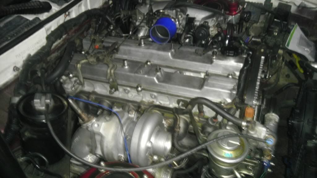

Completely finished one side of the head. Did the shim shuffle and got the exhaust side done and within spec...
Got the block on the stand, getting ready to degrease and paint...

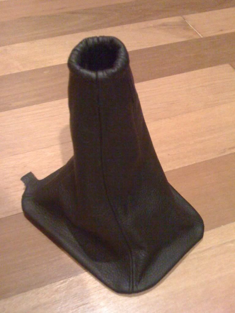

ifyouaint1sturlast;1847578 said:
Looks great! From where?
Is that to my shifter boot? my fathers German mate used to test drive for Opel when the cars came off the factory floor, long story short Germans like to get the job done right, and on time. A friend of his designs clothing funnily enough and she made his whole leather interior in his car as her first car job, oh boy is it amazing. Anyway, the same person made this for me, getting the handbrake one back soon as well

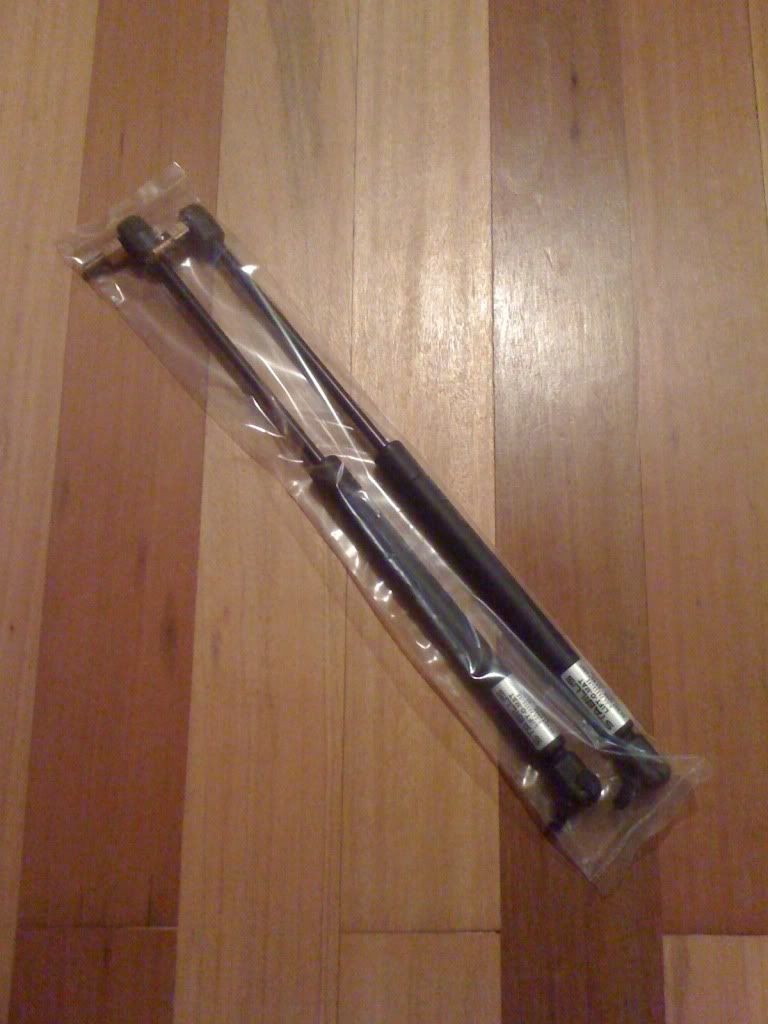

put new hood lift supports on
my old ones worked but were not 100% and didn't work if it was cold out unless the car had been driven the heat would make them work
my hood opens on its own by the time i get it half way open again
