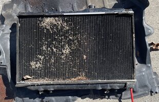

Your radiator looks to be original. If it is, it could very well be getting clogged. Years ago, I had an issue in the summer, where the temp would be fine while driving, but if I turned on AC, it would begin to overheat. I was right at the maximum heat transfer threshold of the cooling system, with AC off. Replaced the radiator, and never ran hot again.
Sadly it was the head gasket, but I will flush the radiator when I get the head back and start putting it back together.
Thank you, Bru, and Pi for the support!
And thanks to Jeff for getting Supramania back again! It is the true happiest place on Earth!

I guess the radiator was a little dirtier than I thought :)
No clogs or leaks though. Shame it is not easy to replace this on an auto car with the Mishimoto Bru recommended.

+After cleaning this you should notice an improvement in cooling. This is a classic example of debris getting sucked up between the AC condenser and the front of the cooling radiator.
