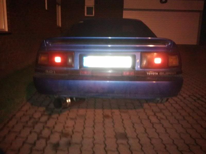

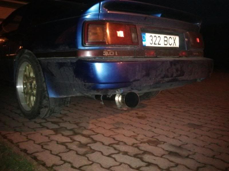

Don't have a "before" picture, but here's the exhaust after :)

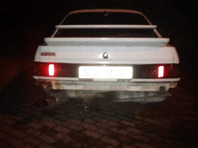

Looks a lot like my Sierras (that angle happened unintentionally :p )
