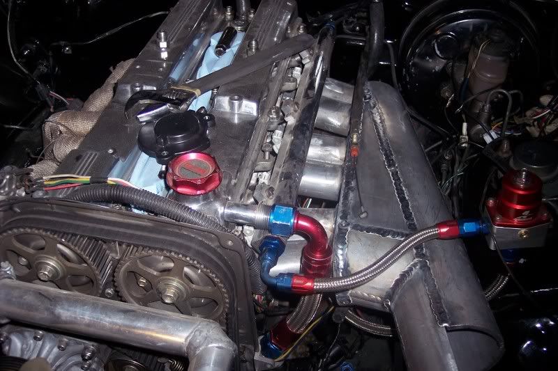

This was done with the spool gun.
But I have countless hours of practice in to get to this point.

Nice, those welds look pretty good. I have no problem welding scrap aluminum together for a few days/weeks to get the hang of it. I have MANY things i would like to make from aluminum. Do i need difference regulators for 100% argon as opposed to the blend that i have now?

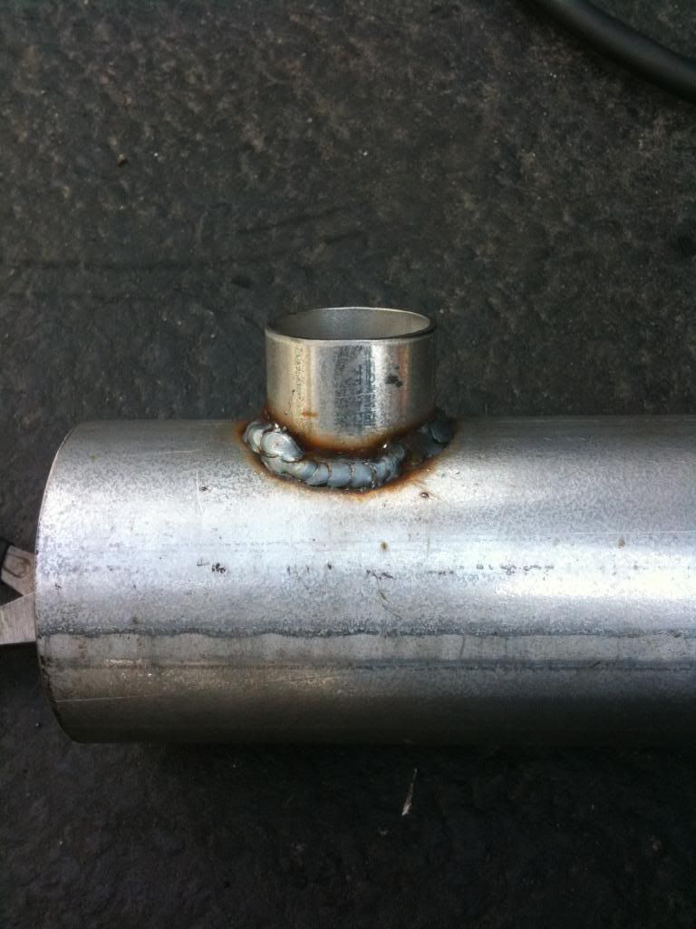

Usually the wind isnt too bad around here when im working on my car. I know aluminum is different but welding steel comes out really nice.

^ not to beat the bush but i don't see much heat there ?
all so wiht aumoin you push in stead of pull and have to whip it and go faster then you do with steel or you blow though

Its relatively thick pipe, just a blow off valve port so i wasnt trying to kill it.

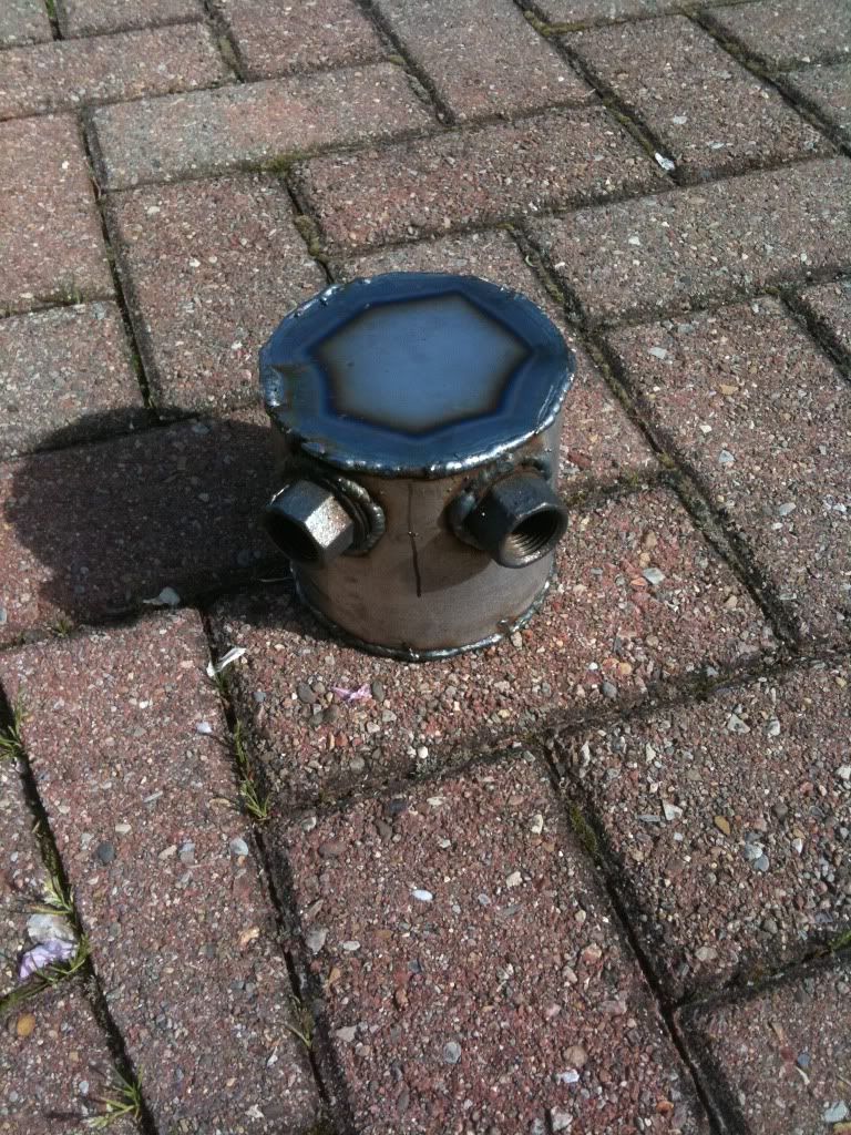

22GA Sheet steel on the top/bottom of the catch can i made, Doesnt leak! The pipe handles the heat much better i guess.
Its not the best welds in the world but im still learning and having fun making my own stuff.
