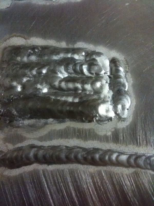

Well my TIG came today!!! After i finished making my new welding cart i hooked everything up and layed down a couple beads on a sheet of 1/8 aluminum.
Sorry for the crappy Iphone picture
I made a little block but the sheet kept getting too hot. At least i think so from what i have read online that the stack of dime like appearance goes away if theres too much heat. I think thats why the bottom bead ran so nice because i waited a few minutes and made it in a different spot.
I have no foot pedal yet so im using the finger roller. Im starting to get the hang of it. After laying those beads i got adventurous and tried welding two pieces of 1/8th inch aluminum together and it seemed like i couldn't melt them both at the same time to make one puddle. I did notice i had the amperage set at about the middle of the range and i didnt have the finger roll really really high so im thinking maybe i didnt get them hot enough?
Any tips on welding two pieces together, specifically how much heat to start with, how much to add and where to go from there would be much appreciated.

Diversion 165 is a very good machine but a little light. You will definitely need to pre-heat material 1/2" or thicker like when making an intake manifold. But TIG is so much nicer and so much cleaner then MIG. Even when we are doing a project that could be migged I will TIG it a lot of times just because of the cleanliness and ease of clean up versus cleaning all the splatter off of everything! Good purchase and good luck!
Seth
