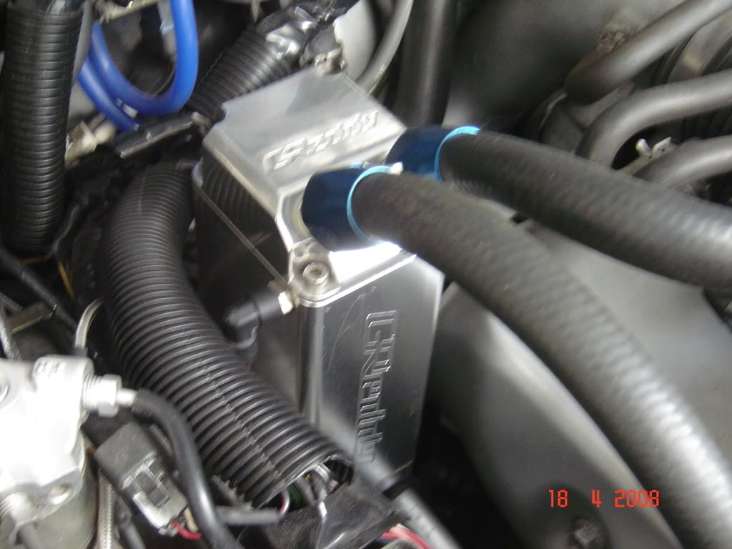

Greddy oil filter

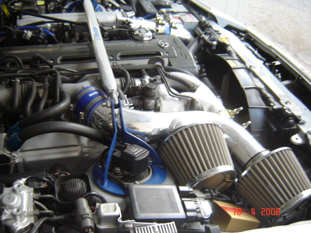

Custom made 'snorkel' hose...for intake tunel for the twin Blitz filters!
Takes fresh air from infront of the bumper and ends up through the hole,
where the old 7M intake/intercooler pipe used to be (in the fender).
Custom made,coolant by-pass hose for blocking the coolant route through
the stock 2jz oil cooler!(new air to air oil cooler & relocation kit is on the way)
Blitz 10 row big oil cooler (very thick core 4cm) with oil filter relocation kit.

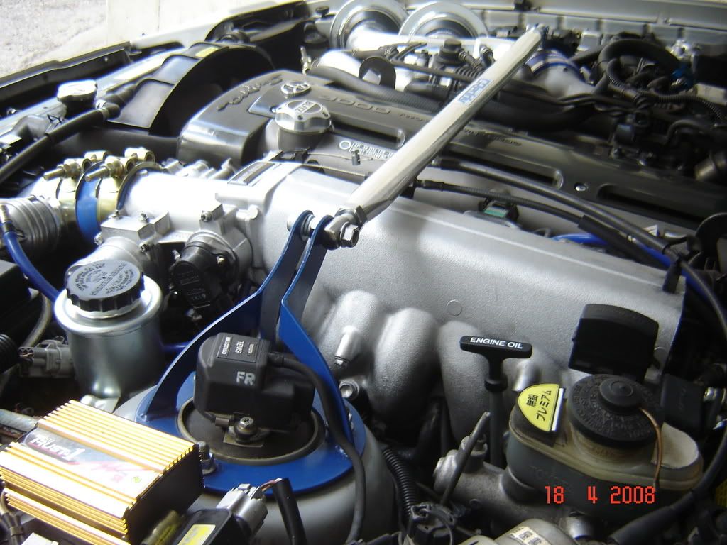

More parts & pictures!

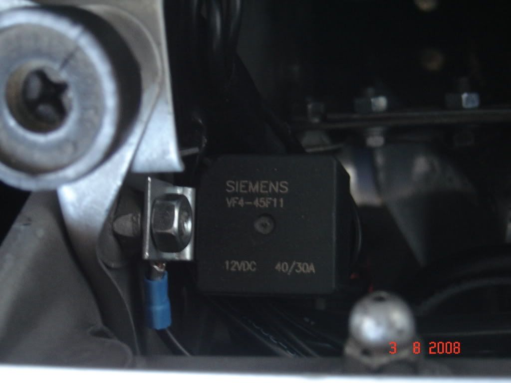

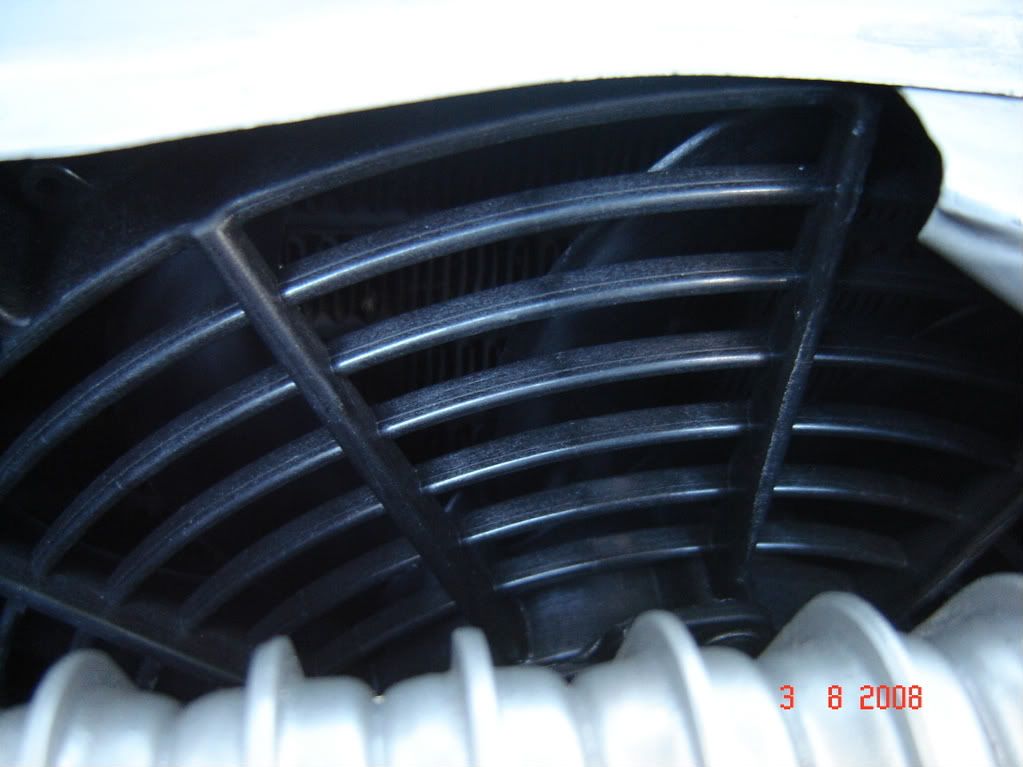

Spal 12" electric (push) fan. Powered from the driver (me:biglaugh:)
Second pict. is a siemens relay for the electric fan

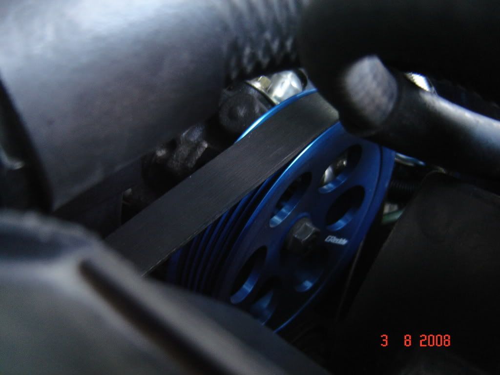

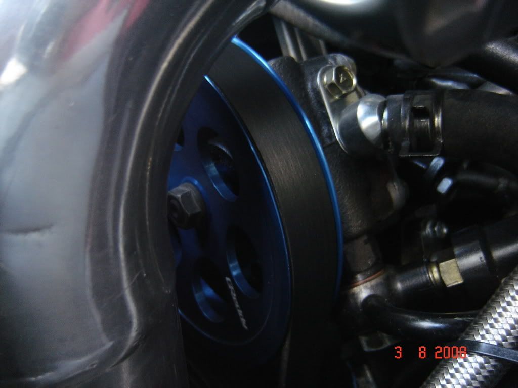

Greddy underdrive lightweight pulleys

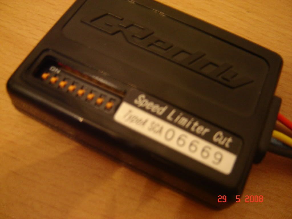

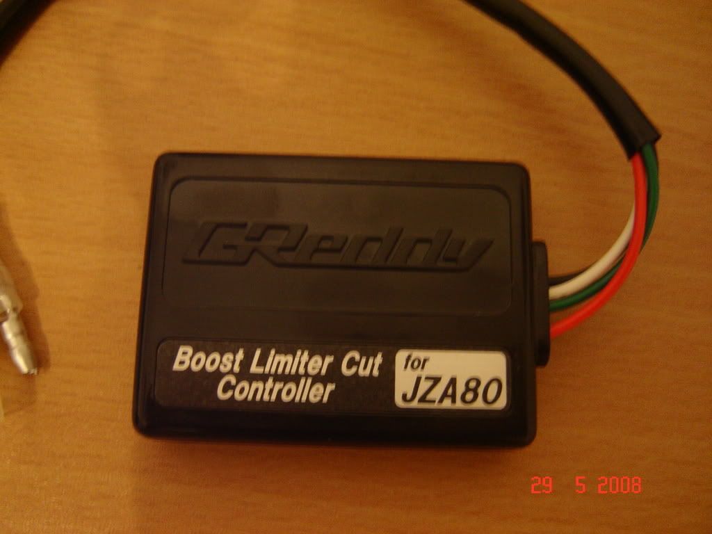

Trust/Greddy Speed limiter cut controller
Trust/Greddy BCC

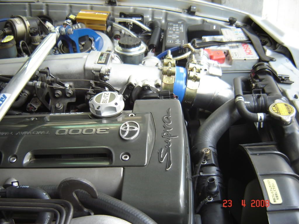

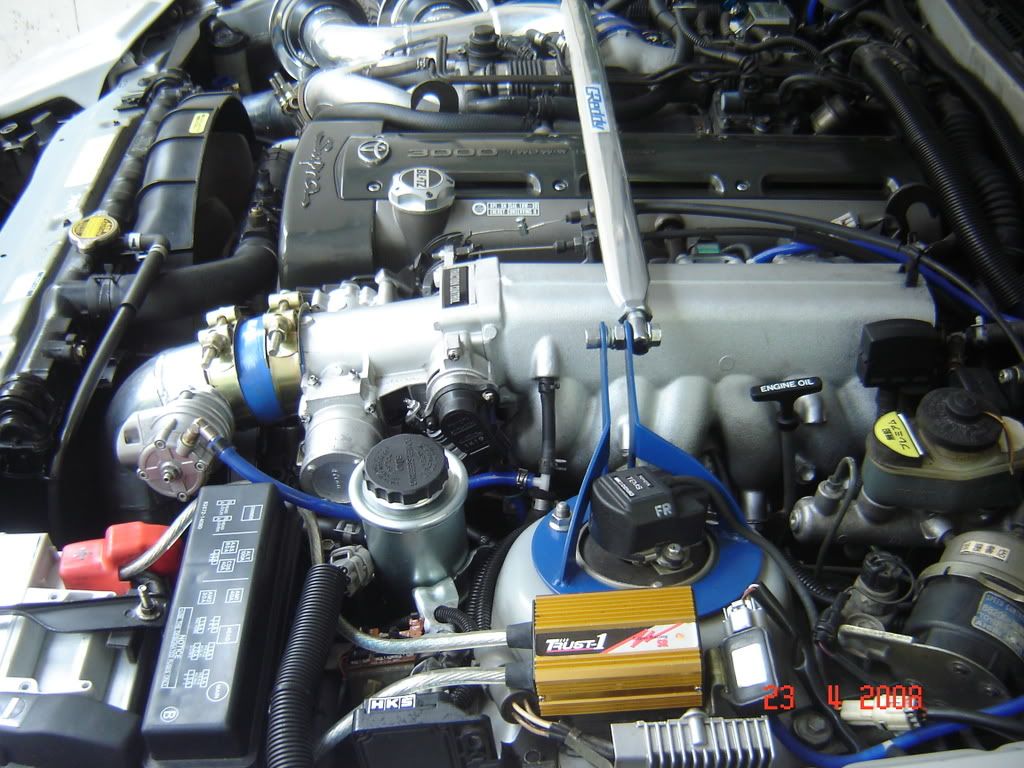

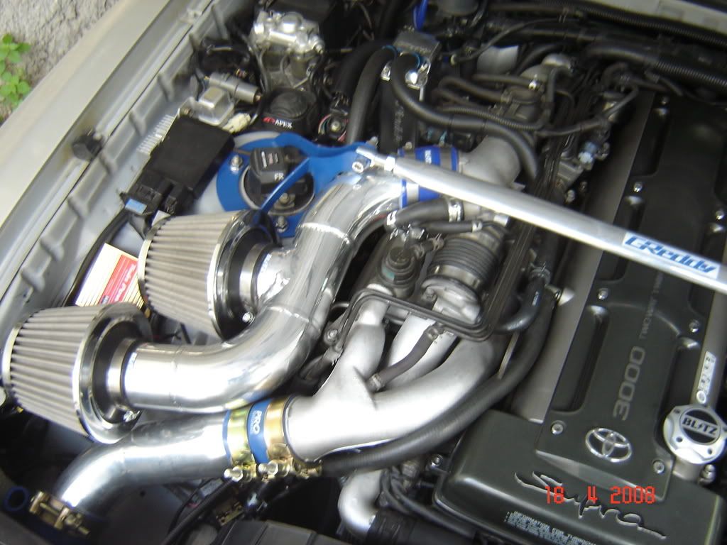

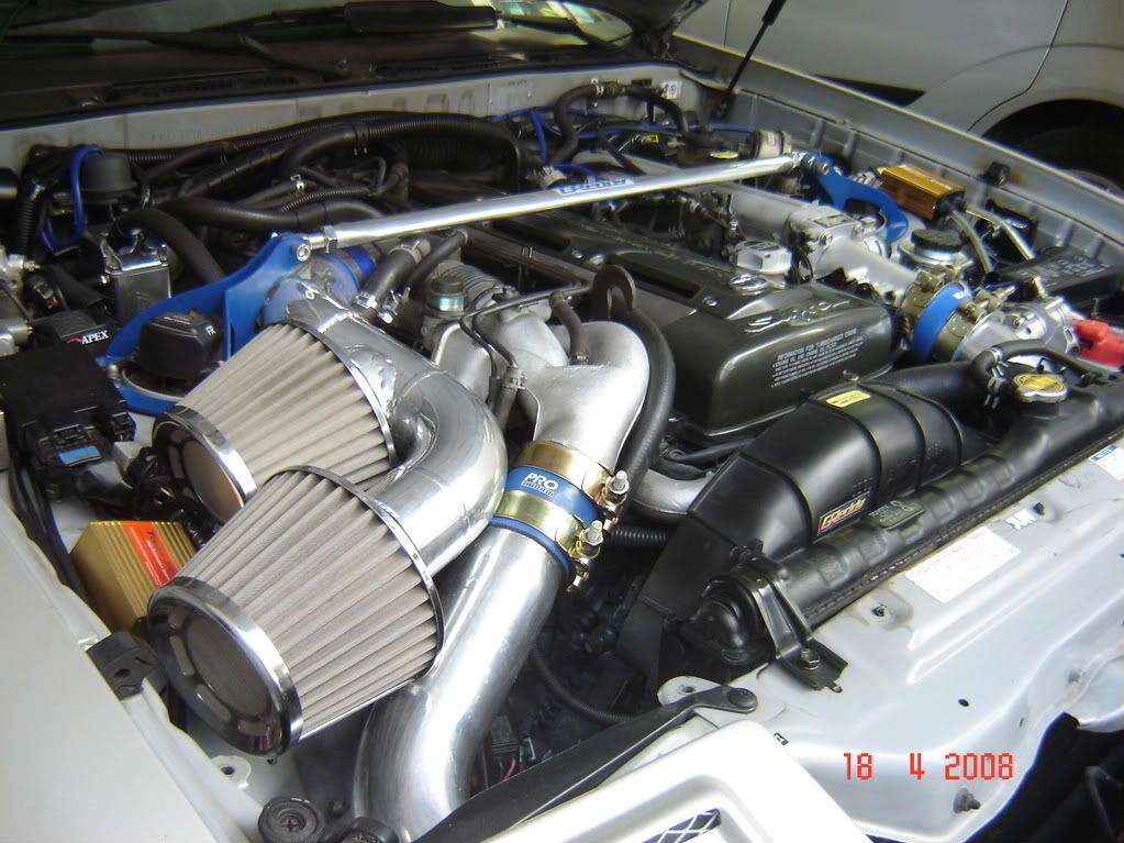

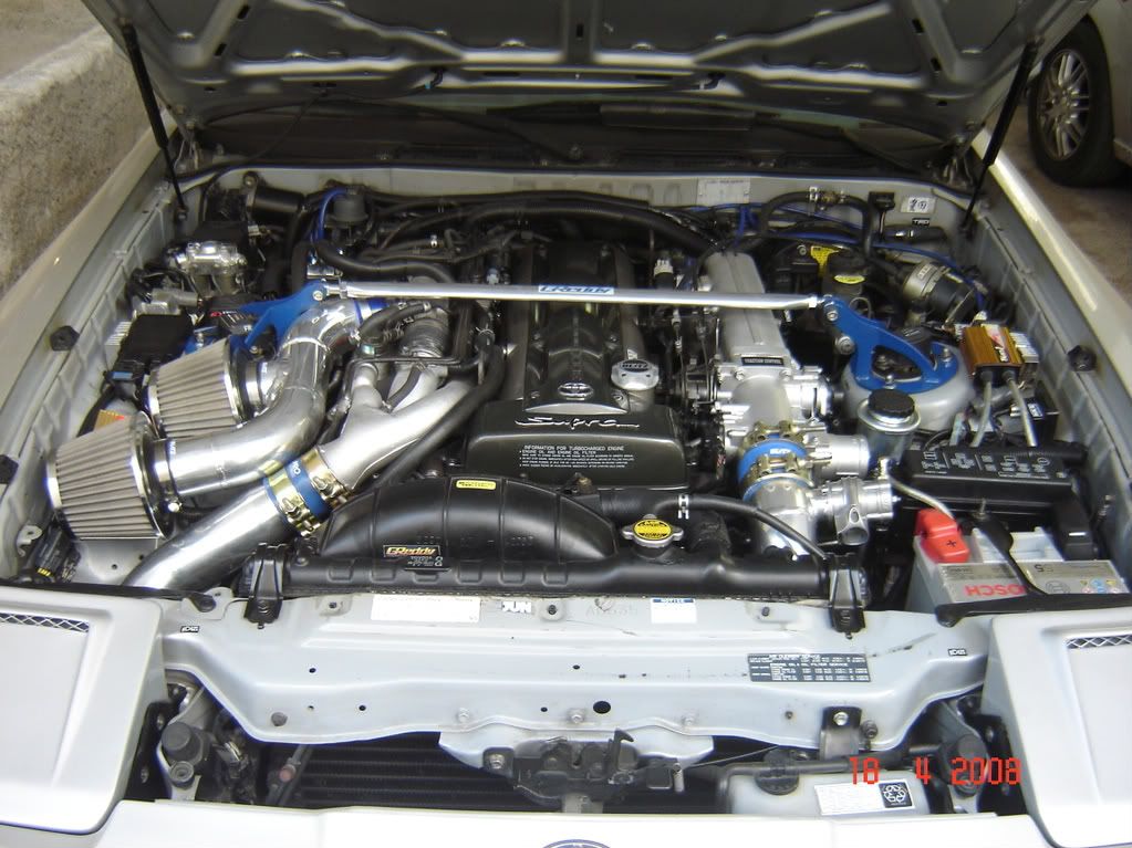

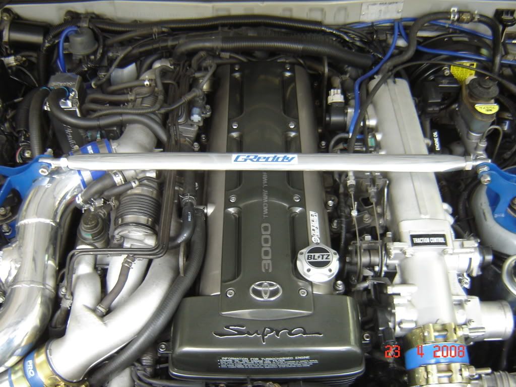

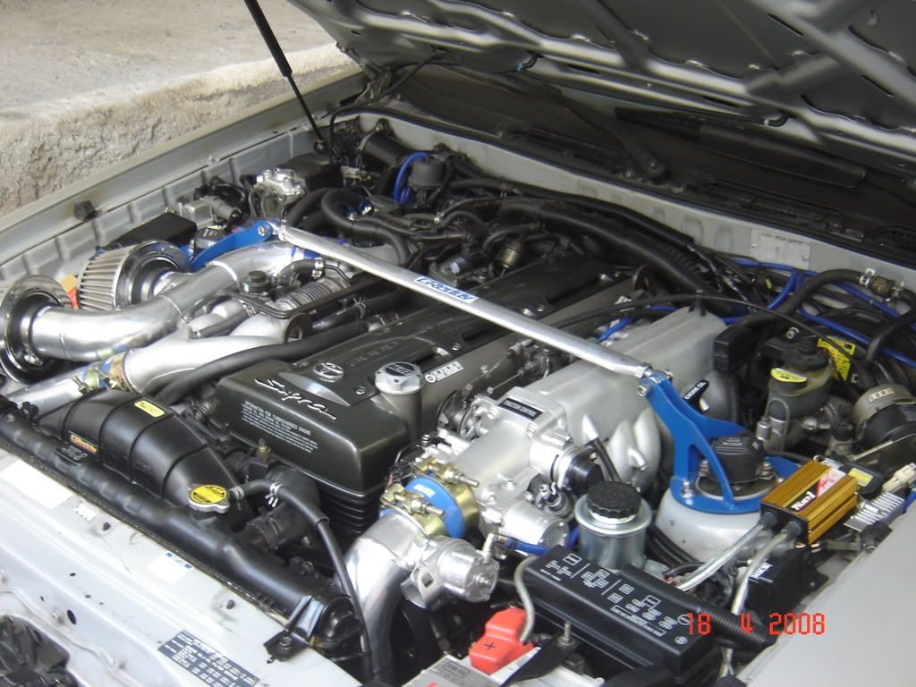

Engine Bay Pictures: Even with the 2jzgte...My Goal was to make it
look stock! Like factory....People here in Europe think the mk3 came in
some editions with a 2jz from factory powerplant :sarcasm:
Guess what? I am the guy messing up with their minds :biglaugh:
(it took me 6 months to swap the 2jz in and to put together all the
performance parts)
Enjoy:

dubsupra209;1299738 said:
did you get the swap done yet? i was thinking of putting a 2jzgte in my mk3. did you have to fabircate anything for it 2 fit?
The swap was completed almost 2 years ago....I still buy parts to upgrade
the 2jz to full BPU +++ level. Almost there.
I will update soon with more pictures.....:sarcasm:
Nothing was fabricated to fit the 2jz in. Only toyota oem (new) parts!
If you can find these parts (mainly 1jz parts) you are ok.
Most important parts are : 1jz....bellhousing,flywheel,rear sump oil pan and
engine brackets/mounts. It seats there like it was ment to be there!
And last....the 'story' of hiting the firewall about 1.5 inches is not true.
I just moved away (up and down) the ABS lines to make some room,and
gently hit the firewall 1 cm (less than an inch) for the motor to have some
'air' to play!
I've done the wiring myself...and I am not an electrician or a
big 'wire' guru :biglaugh:
But at the end...after you've done the 2jz swap,you'll get paid back!
Incredible engine!!! :biglaugh:

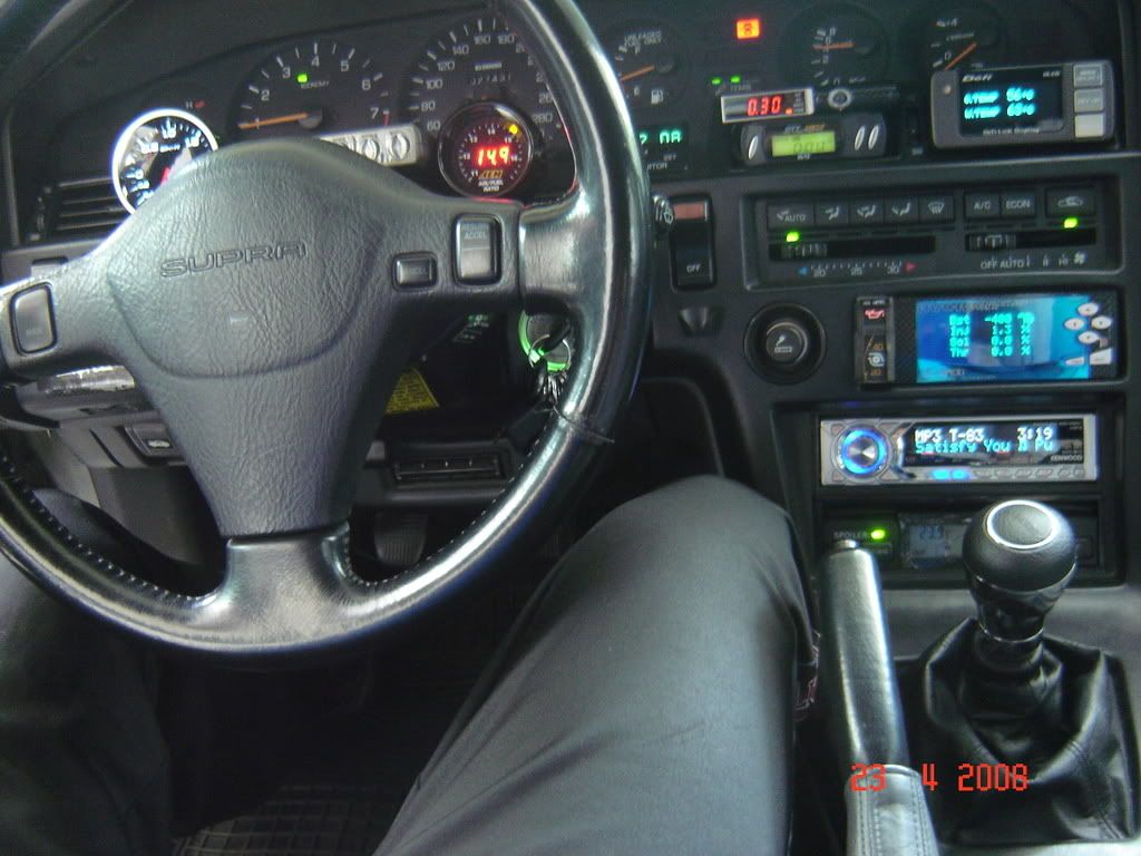

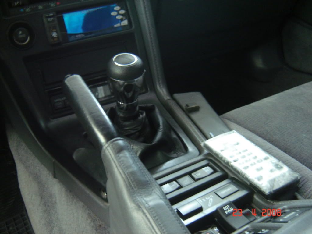

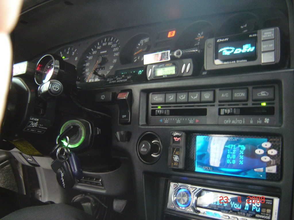

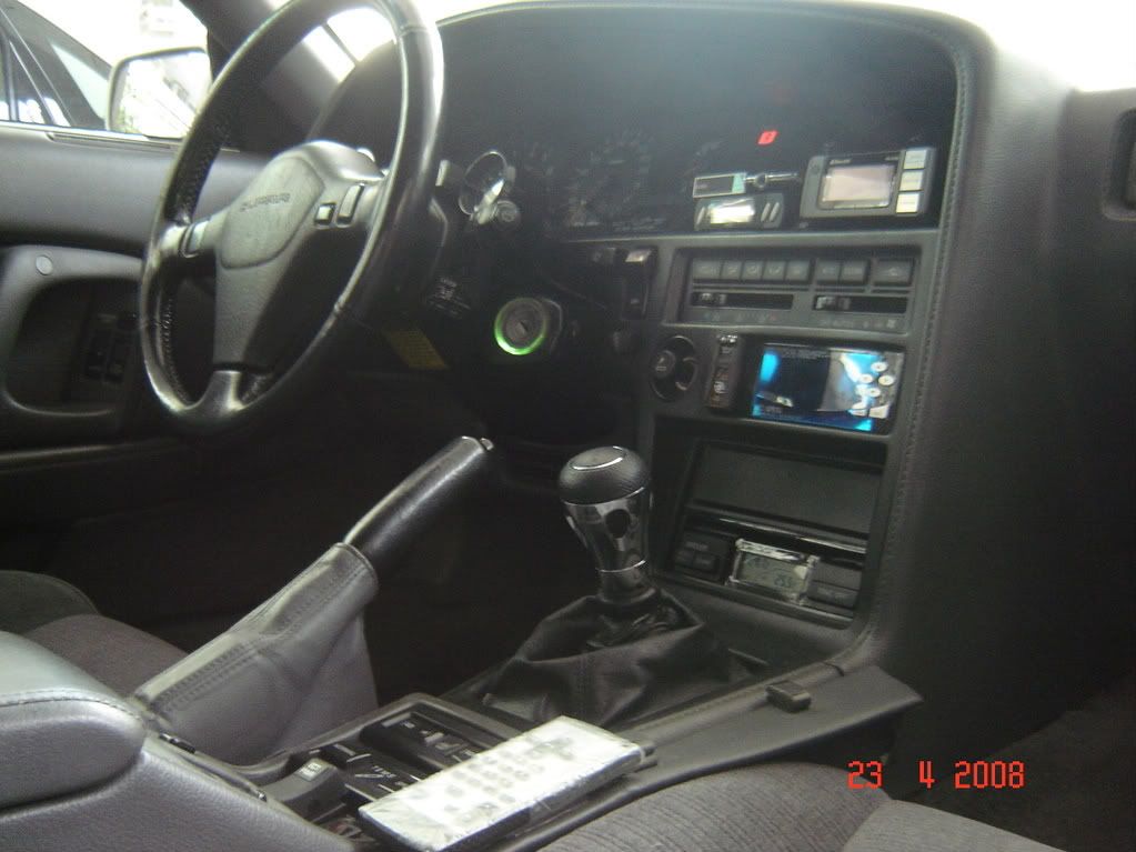

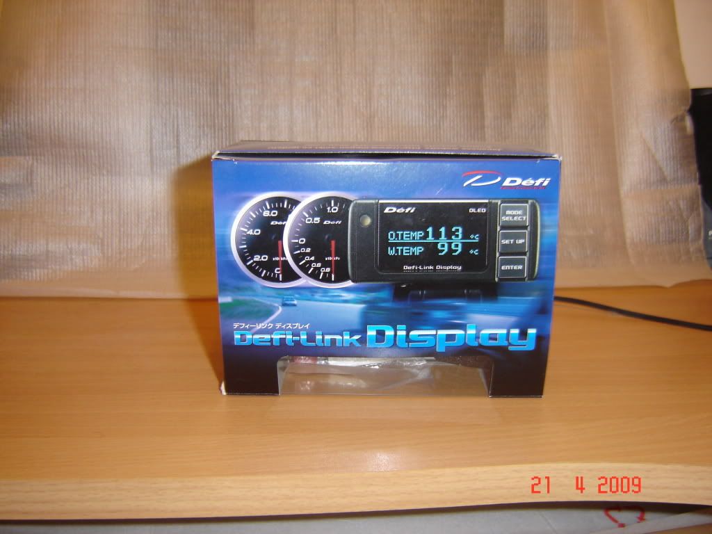

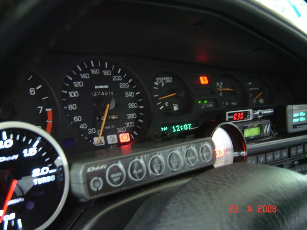

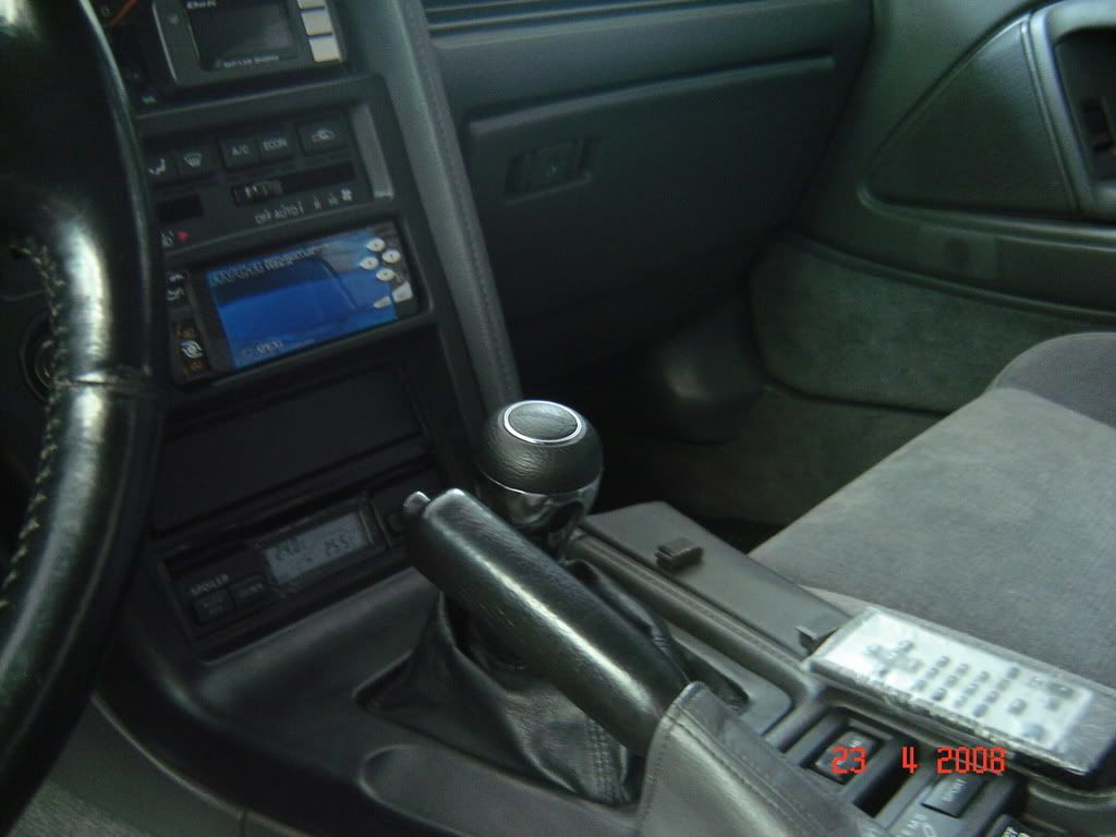

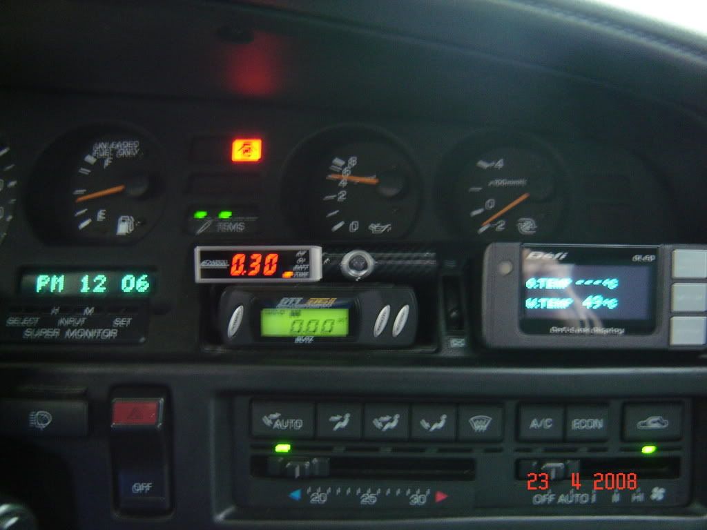

To control and monitor the motor the following gauges were purchased
by me :biglaugh:
Defi link control unit II
Defi BF series gauge (white illumination) - Boost meter
Defi link display unit with all the sensors (water temp,exhaust temp,
oil temp,oil pressure,fuel pressure,and speed meter of the vehicle)
AEM UEGO gauge & A/F sensor
Apexi AVC-R Boost controller
Apexi turbo timer
And a Blitz turbo timer,mk4 traction control switch & spoiler on/off switch,
interior/exterior temp display,US spec deffoger switch with timer,US spec
overflow coolant tank with sensor,mk4 oil pressure level display & oil pressure
warning light,TEMS system added,super monitor added,US spec visors with
night lights,custom switch for the 12' spal electric fan,custom aerial switch.
US spec seat belt warning switch (hate the'bazzer'),mk4 illuminated head lamp
cleaner switch,and tems firm override switch :biglaugh:
All of this you are going to watch them on the interior picts and videos!

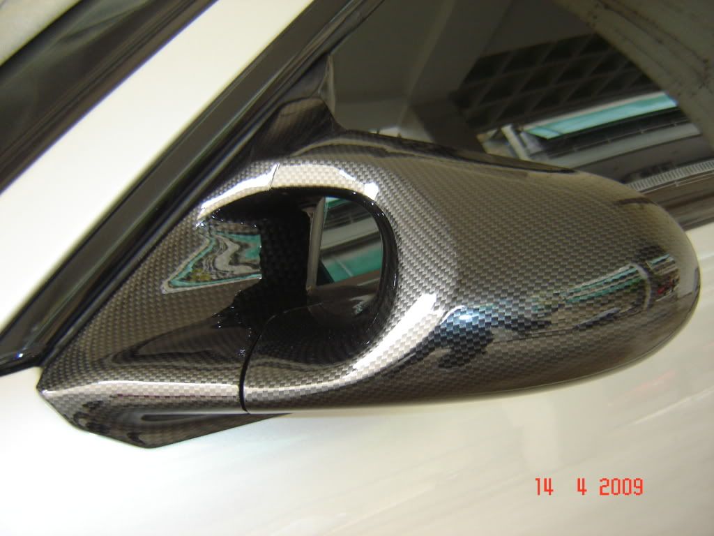

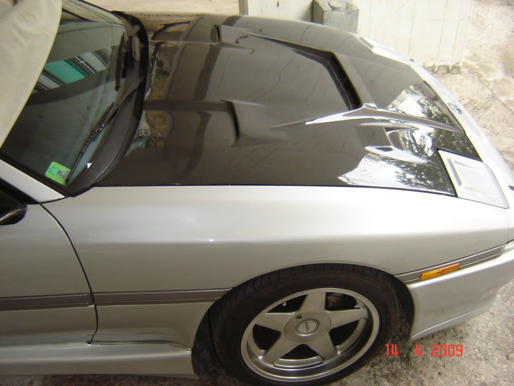

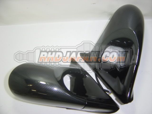

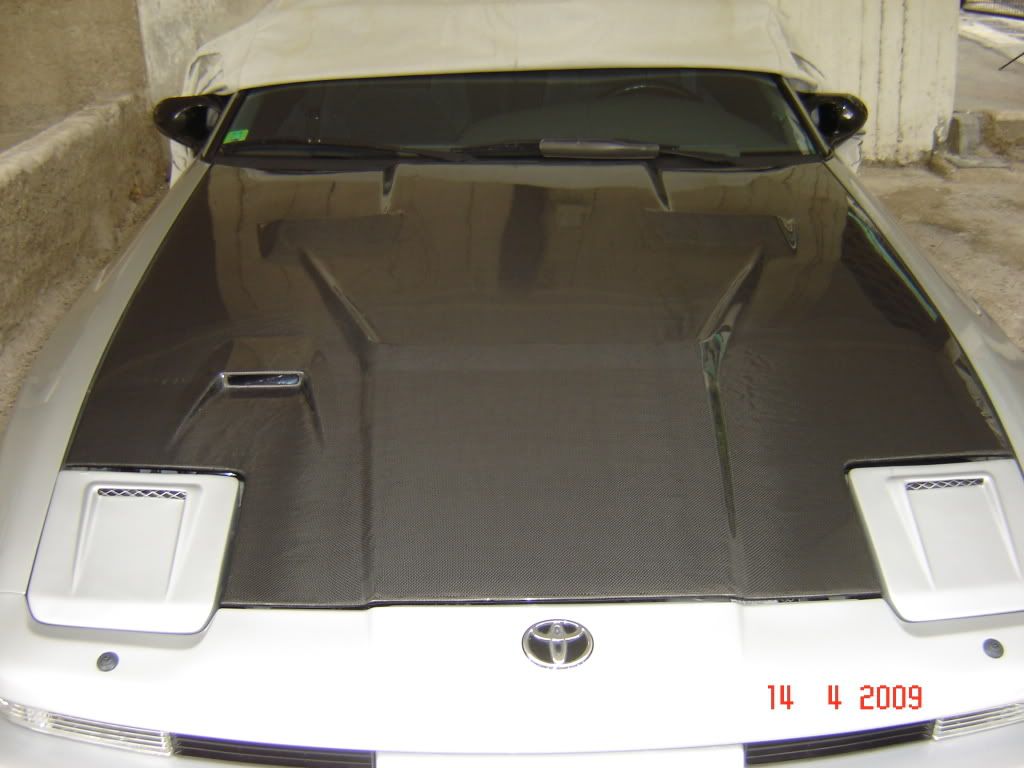

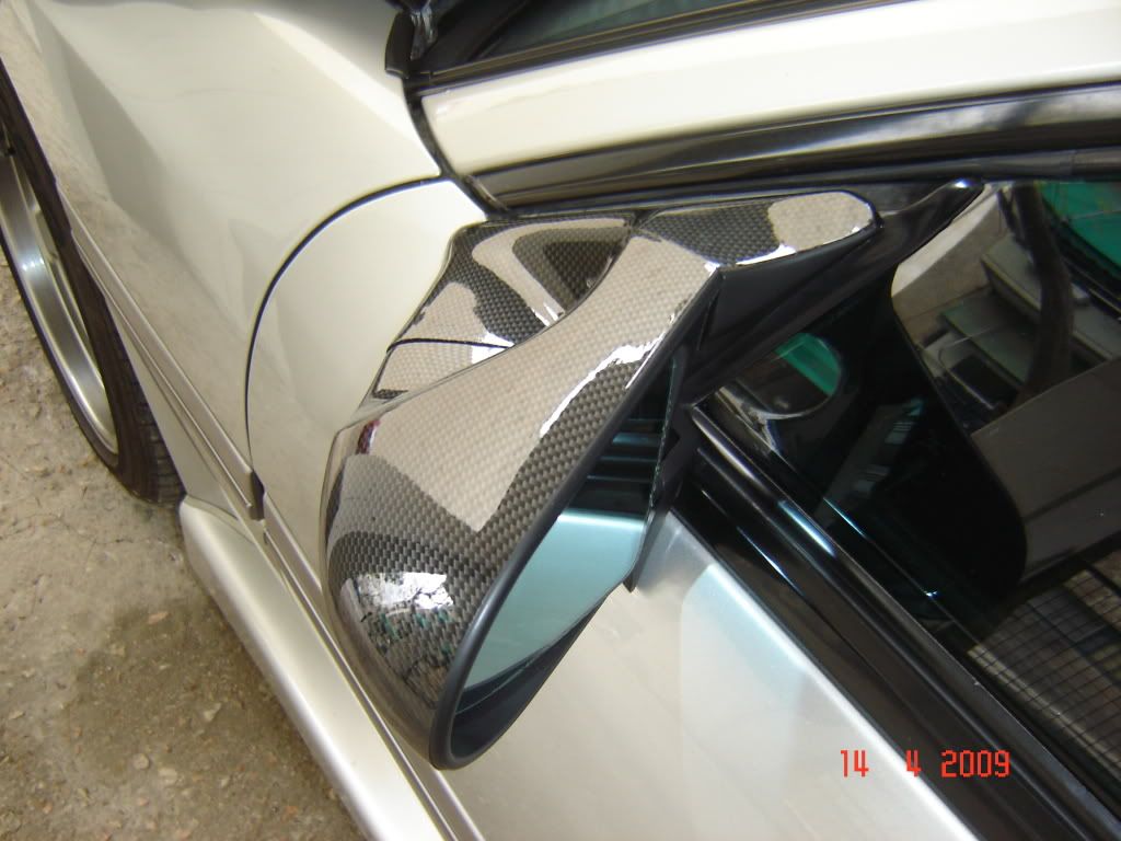

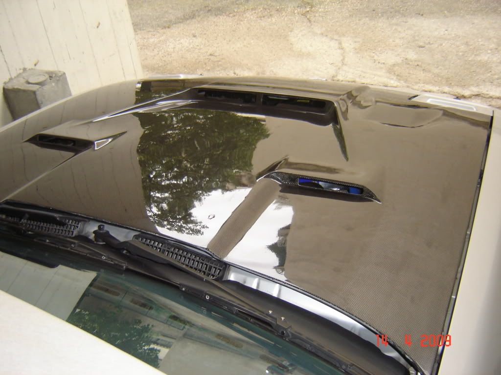

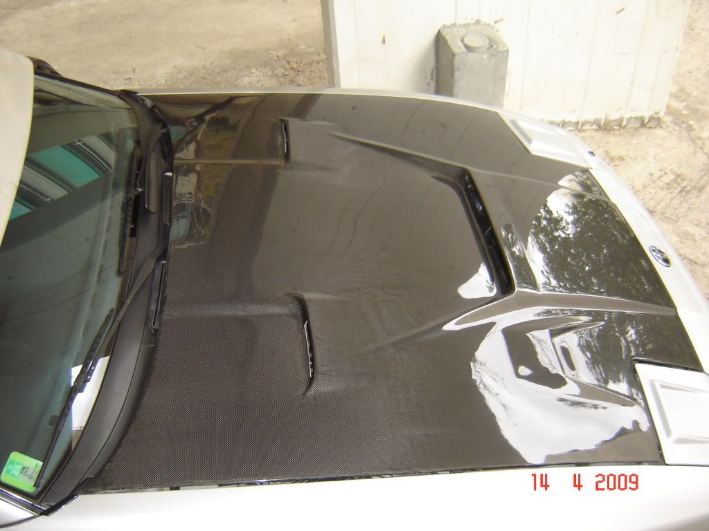

Exterior parts that just came from Japan....The hood is from Nickolas Stonawski!
(thanks Nick)

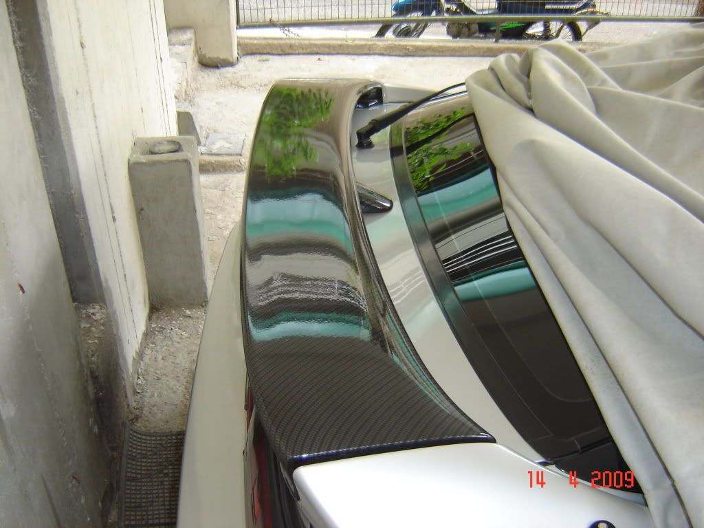

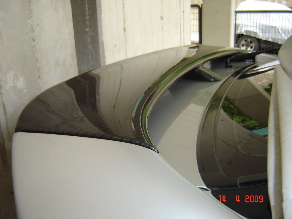

Rear stock wing...carbon look!

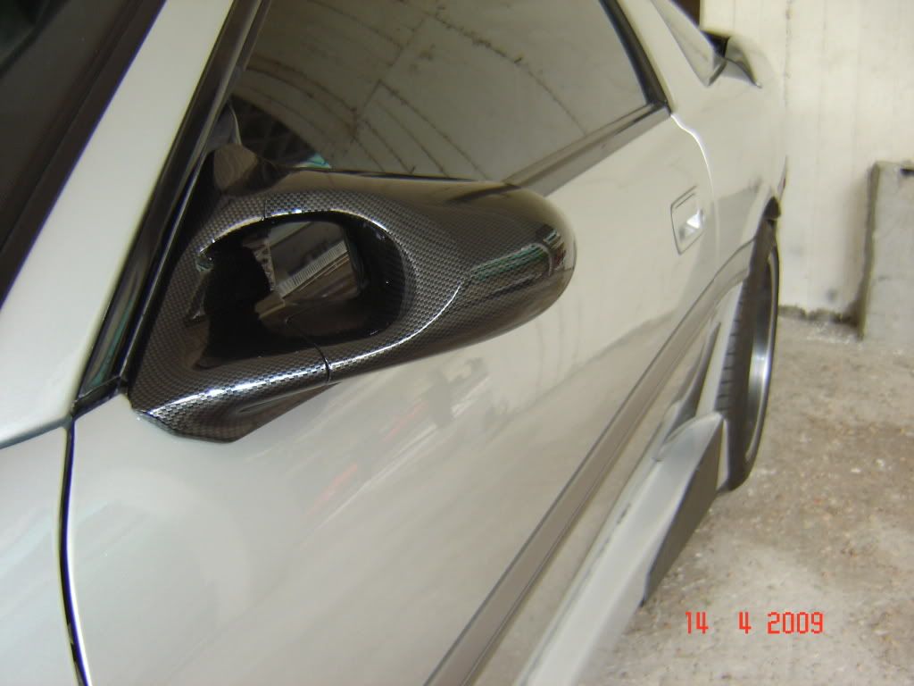

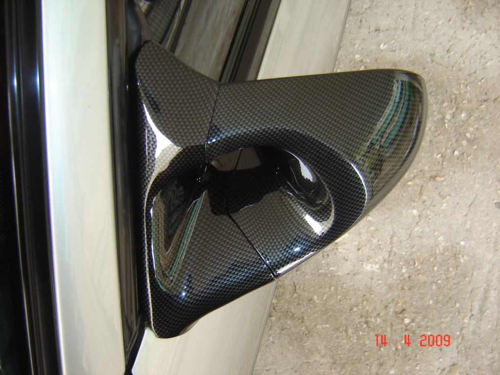

Carbon 'Ganador' mirrors...from Japam (rhdjapan.com)
Full carbon "Stout" hood...from U.S. California (Nick Ston.)
