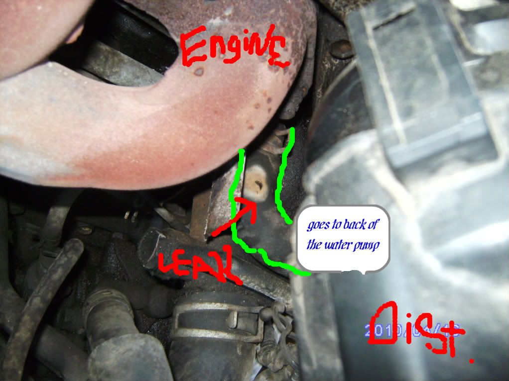

I felt the need to make a thread for this because it caused me a week long headache.also it seems to be a common problem so here is a pic of the hose the white mark on it is the hole.It would only leak when it got real hot.I didnt notice it was leaking from there when the whole got bigger and started spraying coolant out at a gas station,as the car started to run hot so here is the pic
i hope this helps ps. to see this you have to remove the heat sheild
