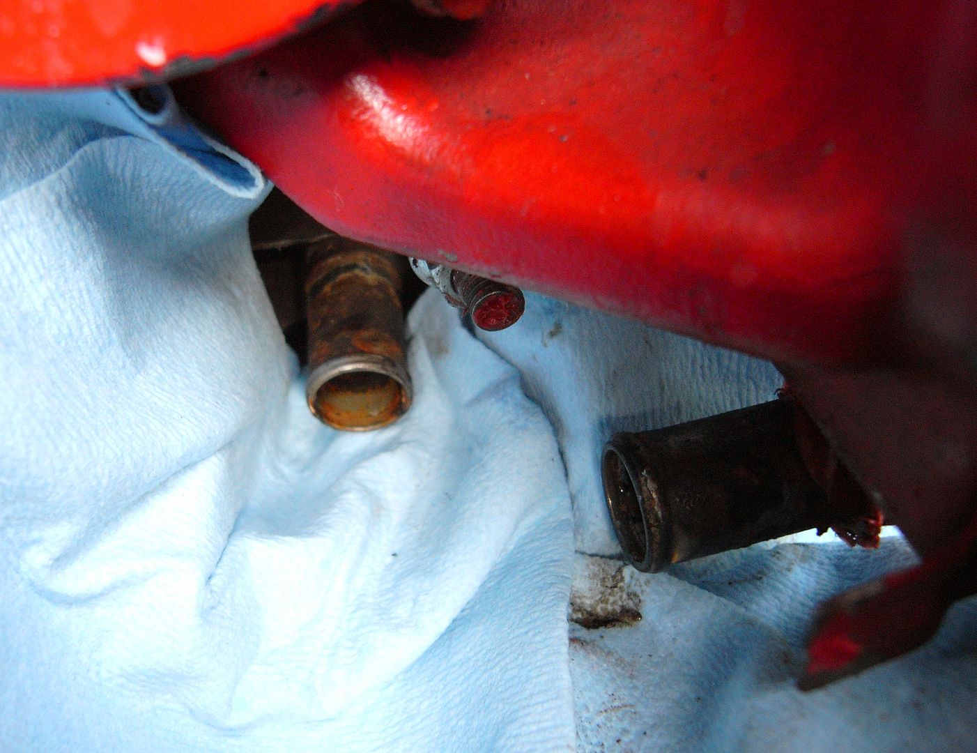

Hahaha I blew one(front) last year doing a burnout and it kicked my butt. I caught it this time while looking for a boost leak. Now I have a spare and can change it in like 10-15min. :)

Mine split in two, and stayed on the tube, had to tear almost that whole side of the engine apart to get it off. PITA!!!! I had to take off the ps resivior, cps, and waterneck or thermostat housing (also changed thermostat and broke those damn bolts off)

I messed up w/the tstat housing the 1st time, but I changed the hose clamp on the inside to a heavy duty spring clamp. That saves a bunch of time the next round! lol

The stock hose isn't exactly 90*, it's more like 110*, which makes it complicated. There is a Samco hose that is 120* that seems like it would work quite well. I will buy one to have on hand in case one of mine fails, or I will replace it next time I drain the coolant. Anything not to do that job more than absolutely necessary as it's a pain, but quite doable.

Yeah, purchase new clamps with it like I did. If the oem one lasted 18+ years, would you want to go with a different one that only lasted 2. I would rather pay $17 every 18 years than $8-14 every two years.
