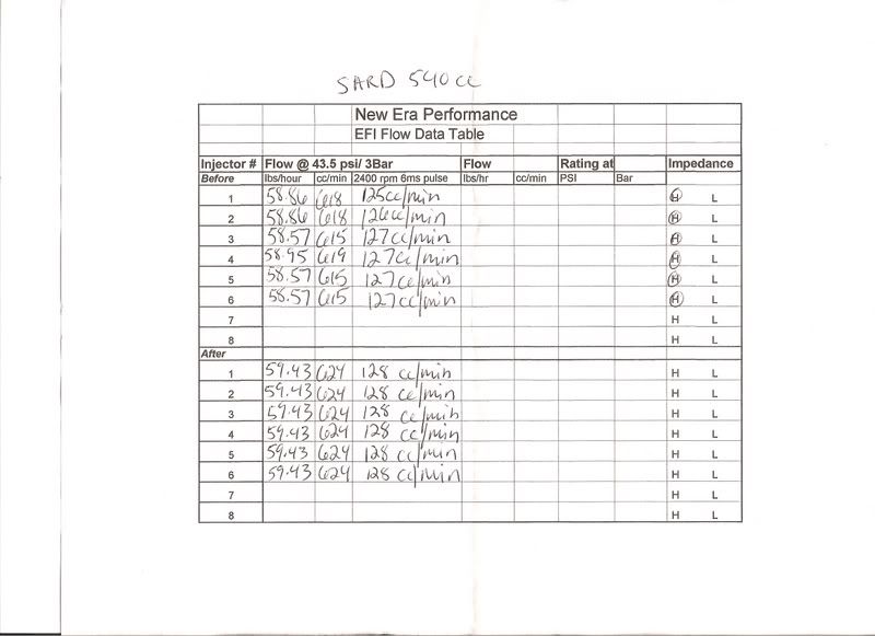

Here is a copy of my flowchart back from NewEraPerformance. It clearly shows that the injectors are flowing 624cc's instead of 540. I hope they swap them out for me without alot of hassle. I'll keep you posted.........lol
I see you took my advice about getting the injectors flow tested ;)

It's a 1jz so it is speed density, if he had a boost leak it just wouldn't make full boost. His problem is that it is bogging because of too much fuel.
Jay's engine does have injectors that are too big, and with the current setup having only a SAFC, there is not much he can do about it. Jay, you are going to need smaller injectors. You should also degree the cams before making huge adjustments from 7 deg retarded to 7 deg advanced. You can buy a degree wheel and take it to the dyno dude. These problems are not going to resolve themselves or just get better from driving the car around. If it is pegging the afr at <10:1 every time you hit boost, then you could damage the rings and/or the cylinder walls.
