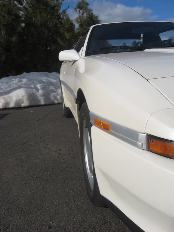

My 91 has silver trim and my car is pearl white. So... its not the same color as the car.
It came this way from the dealership.
