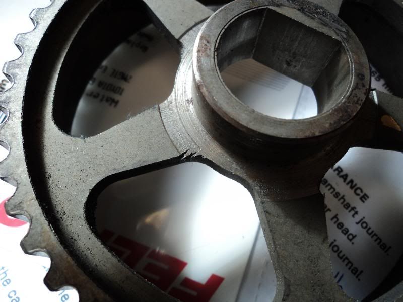

63
1986.5supra_kid;1995840 said:
toyotanos proved this^^^
99 times out of a 100 it's because someone has used something sharp edged to jam a spoke so they can undo it and the mark left has created a stress riser...

NashMan
WTF did he just wright ?
Aug 5, 2005
4,940
17
Victoria BC
Oil pump gear does not work I looked into it long ago
in 83 they ran a different gear a stronger one but the cogged belt is diffrent the teeth don't match up but in 84 to 85 they use the same gear as the 6m and 7m
what you have to look out for is this I have scene this more then once
