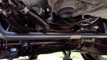

So far today, I've shimmed the cooler bypass, shimmed(2 washers) the wastegate, Replaced the front swaybar with ST,
Replaced the oil cooler lines and oil filter, and adjusted the dashpot. Not much more to do. If I get the rear swaybar done, I'll call it a good day.

ST swaybar, and new oil cooler lines.

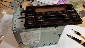

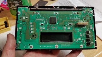

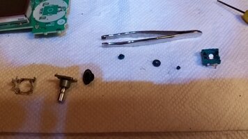

Then, I started playing with my stereo unit, in order to fix the bad power knob. It was collapsed, and wouldn't spring out, so it would constantly power on/ power off.
So, I opened it up. Surprisingly, the front faceplate just pops off, almost like a removable faceplate.
Um...yeah. Didn't see any repairable items inside, so I reassembled it all. Instead, in a MacGuyver- moment of inspiration, I fashioned a spring from a
ballpoint pen, and wrapped it around the rotary shaft, and reinstalled the knob(sorry, forgot to take a pic). Now the knob springs back as it should.
As for whether or not the thing works, is still a mystery. It started raining cats&dogs, and now I'm headed to dinner. I'll have to install and test it in a few days.

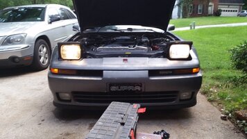

Three days ago, I discovered that one of my low beams was burned out. Seeing as I had a set of H4 conversion housings from my other car just sitting on a shelf,
I decided to swap over for a little bit more light output. They're called Neolite, and are glass housings, somewhat similar to Hella's.
Pulled the driver's side 6054 out, only to discover that the lamp wasn't bad, the electrical socket was. One wire had snapped off of the
terminal in the socket, and it looked one of the other two wires had been spliced together at some point in its past. Went to Autozone and bought a replacement socket and wired it in.
Here's a pic of before and after, halogen Sylvania on the left, Neolite H4 on the right.

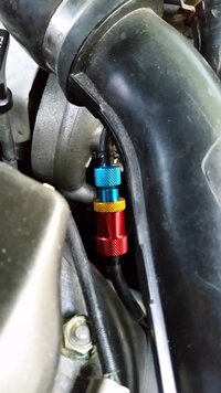

Also, I bought a cheapo mbc off Ebay, just so I could get 2 or 3psi more boost. I found that even on the lightest spring setting, I would spike and hit fuel cut.
After taking it back out, I kinda did a blow test through the two aluminum ends(no spring), and felt that the nipples themselves were too restrictive. Drilled them both out with the next larger
size bit, and cut 2 coils off the spring, so that it could be assembled to an even softer setting. Originally, the spring was so long, that simply putting the two halves together put significant compression on it.
Well that solved the issue. Whereas I was getting about 6- 6.5psi on the gauge before, I now go just above 8psi, probably around 9. Makes the car just quick enough to reveal the next fix that I need to do:

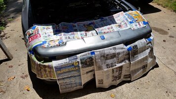

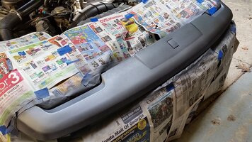

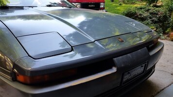

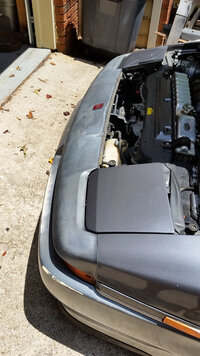

Nothing big going on here, just still trying to polish off the last of the repair tasks.
Tried painting my header panel today, came out ok, but a little dark. Hopefully it will lighten up slightly as it cures fully.
Tired paint:
Masked off:
After a couple rounds of base coat:
And a couple rounds of clear coat:
Can't wet sand or buff till tomorrow, and of course I still have to do both bumpers, but it's looking promising.

Let it sit in the sun for a few days to cure before starting the cutting and buffing process if you haven't already.
supraguy@aol
Well-Known Member
Dec 30, 2005
4,283
77
Atlanta
Oops- I already did that. Instructions say to wait a day for rubbing compound, and 30 days before any type of wax.
GC89
1J-THIS
Jun 13, 2007
938
Spokane, WA
what type of base/clear did you use? Looks pretty good so I think your fine.
UV helps the curing process on a urethane clear and the harder it is the better it wetsands/cuts/polishes. You can chase buffing marks if the clear is too soft but it doesn't seem like you had any issues.
