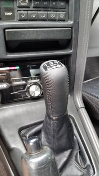

Well, I got the shift knob done.

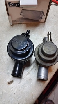

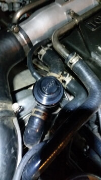

One issue I've had ever since I swapped the turbo and injectors...
The bypass valve never seems to open any more. I just get the rapid stutter of backpressure against the compressor wheel.
So, I upgraded my bypass valve yesterday, with the only oem-looking, plug&play performance bypass valve I know of:
Looks great, and fits great. Problem is it didn't fix the stutter/flutter problem.
There's vacuum at the line, but I suspect that the silicone vac hose is collapsing or something, when I let off the throttle.
Just another little issue to resolve, I guess.

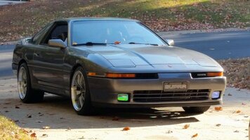

So...what's the latest?

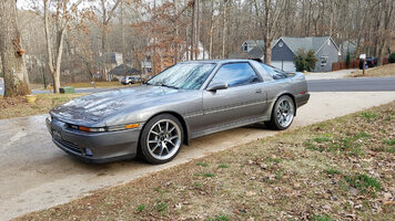

I finally replaced my original oem pressure plate for a slightly stronger one, so hopefully, no more slipping clutch,
and I can add some boost. I won't do that however, until I install my boost gauge, so that I know what I'm running. I'm just waiting on a harness plug for it,

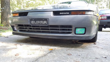

so maybe that'll happen next week. Also, I swapped the new FR500's from my '88 project car, over to this one. I want to sell off the XXR's, and get another new set of wheels for the '88.
You'll notice that I added a tint to the fog lights as well:
She's running well, and there's really only two other changes I want to do to the car:
New Tokico illumina TEMS struts
Euro half clear front turn signals.
THEN....I'm done.

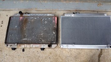

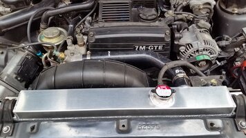

I ended up replacing my 12 year old CSF aluminum rad, because it developed a couple of very slow leaks.

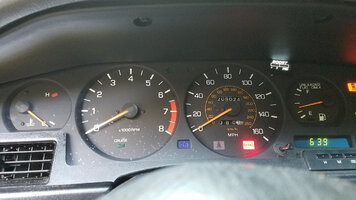

Oh, and I added a boost gauge, like I said I would. But where is it?
There it is...

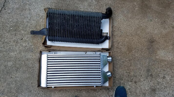

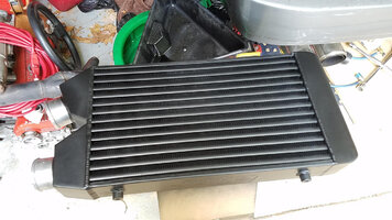

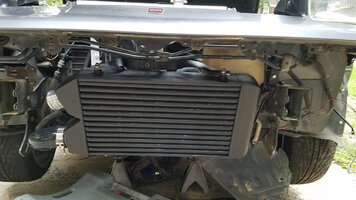

Oh, and one other upgrade, and this one is also nearly invisible; a new intercooler.
I had heard that the stock one was good, but not great. I don't know if the one I bought is any better, but it is bigger.
Took me a bit of messing around, swapping couplers, and twisting things, but I got this one to fit in the stock location,
without it being obvious. Here's some pics:

GC89
1J-THIS
Jun 13, 2007
938
Spokane, WA
Jealous of that EAC controller. And that intercooler should be much more efficient.
Now get to work on the 88 Diego!

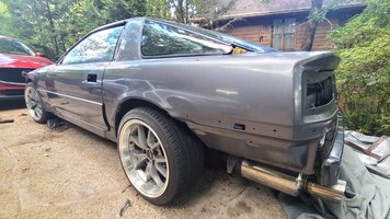

Whadup!
No, The 88 will likely be a weekend car/ garage queen.
I was supposed to head out of town today on a trip, but the plane had an engine issue, so I was off.

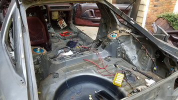

Here's what I did today:
Don't know if they'll have a trip for me tomorrow, but the next step is to strip the doors of their interior panels, speaker pods, windows, moldings and trim,
as well as the door frame moldings and targa seals.

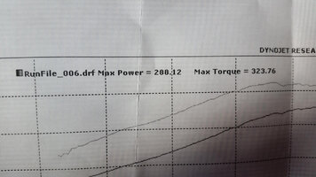

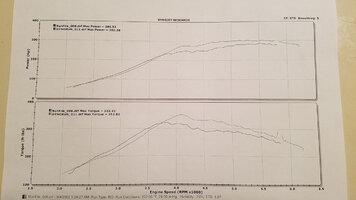

I went back to the dyno the other day, just to see if a new clutch and intercooler would help matters.
Here is a best run from last year, and a best run from this year. Finally broke 300, and that's all I need from this girl.
It's on the '88 to make the real power.
supraguy@aol
Well-Known Member
Dec 30, 2005
4,283
78
Atlanta
GC89;2095594 said:
How many pounds of boost was this on? Looks good!
Thanks- Approximately 12psi. The boost would hit as high as 15, then immediately back off to 12.
You can see where power plateaus at about 4200, then starts a shallower climb to max hp by 4800. It's even more noticeable on the torque line at the same RPM.
The theory is, that the spring inside my $8 boost controller can't handle 15psi, but I also suspect the oem wastegate tension might be a contributing factor,
so just 10 minutes ago, I shimmed the wastegate by 2 washers, just to make sure that the wastegate door stayed seated better.
GC89
1J-THIS
Jun 13, 2007
938
Spokane, WA
You're running a 57 trim correct? The washers should help, in my experience most boost controllers, manual or electronic struggle near double wastegate pressure.
supraguy@aol
Well-Known Member
Dec 30, 2005
4,283
78
Atlanta
Yup, a 57 trim. And an update:
WOW. That 5 minute fix made a difference. I went from 12 psi, to holding 18psi.
Now I have to back down the boost controller, back to 15psi, lol.

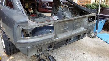

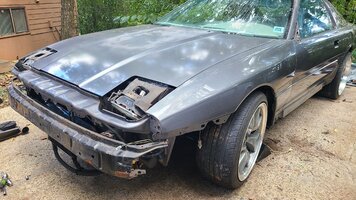

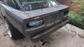

Last time I posted here, I mentioned that I wanted to do a few last things to the car, like new windshield, repaint hood and targa, and replace tint. A few of those things I did, like the paint and windshield, a few still remain.

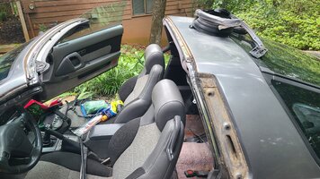

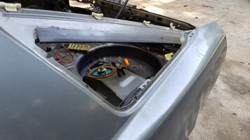

Brand new complete paint job... Teardown:
