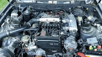

Current motor status:
Some of this stuff will be used, but some I will sell off, as I'm not looking to make this car any more than a stock daily. As I said, I want one car to be mild, one to be wild.

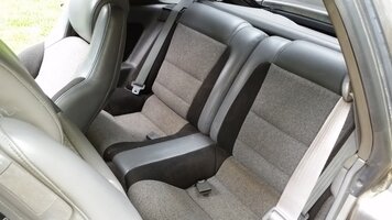

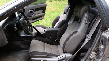

I will add a few pics of the interior as well, but for now, I have to get down there and start putting it back together.

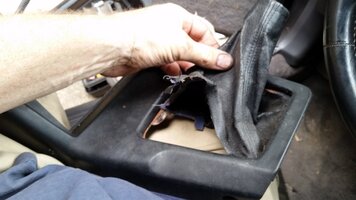

Working on the front brakes today. So far, I've swapped in the Earl's front stainless lines, and painted the rusty calipers.
Next I will install the front ST sway bar. I'll do the rear lines and bar on my next free day.

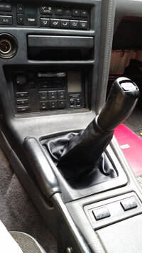

While waiting for the paint to dry, I swapped out the old shift boot for the new oem one:

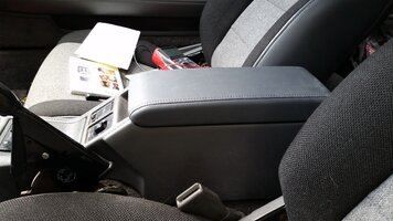

Also, I went ahead and replaced the armrest cover. The original is actually in really good shape, with just the barest hint of one seam pulling a bit.
But I figured that I may as well go with the new one.

Ya I dig it, had to stare at it for a minute with so much going on. Definitely an interesting interior.
So you plan on selling the old center console lid?

Slowly, the motor is coming togther, but i'm very short on free time these days.
Yesterday, i installed new plugs and wires. Next, reinstall the igniter, upper ic pipes, and the afm.
Hope to have it running very soon.

Getting closer...and farther away at the same time.
You guys know how it is; You fix one thing, you find something else wrong.
Here's the motor, entirely complete, with the exception of the rad/ fan/ shroud, which has to be swapped out of my '88.

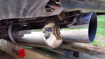

Then, I decided to install the HKS Drager exhaust. Went pretty smooth for the most part:

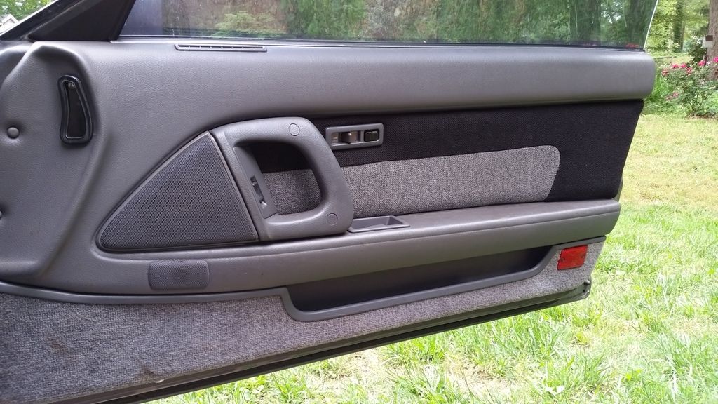

supraguy@aol;2048184 said:
Sorry- Here's those pics:
Do I see a factory tweeter grill here?
Nice work and progress overall, keep yp the good work ;) !
Silver MK3
Jan 24, 2011
1,517
Madison, AL
Yeah no tweeter. It's for air flow as mentioned. With the stock 4" speaker pods you could feel the bass through those holes on your knees when driving. The earlier models just had holes drilled in the panel. It looks a tad bit cleaner I think.
