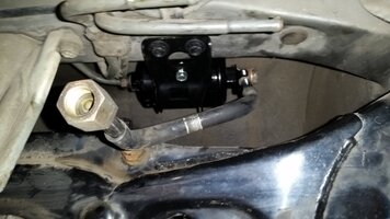

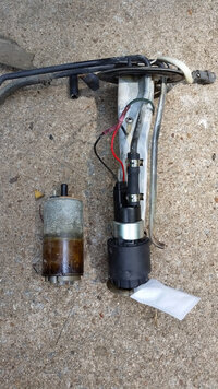

So I just installed the new fuel pump...
MAN, is it small.

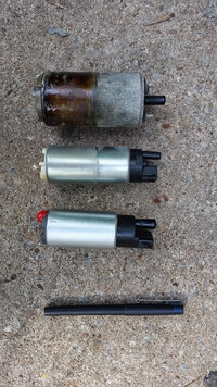

Here's a pic of the oem pump, a TRE performance pump(old), and the Keyshan pump(255lph) that I just got. The pen I've had for a long time, and is just there for reference.
And here it is, on the bracket.
The fuel filter looked pretty new, and I saw the receipt from when it was installed. But, since there was a brand new oem filter in the pile of parts I had received with this car,
there was no reason not to replace it.
So the tank's back in, and the pump runs from the diagnostic port, so that's an improvement.
Time for a lunch break, then we'll see what's left to connect. :)

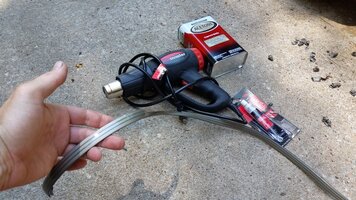

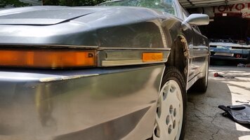

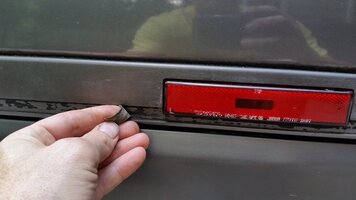

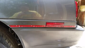

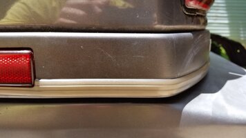

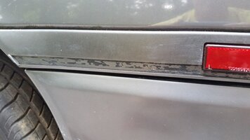

#1: Trim on this car was an issue when I got it. Namely, the smaller strip on the trim was shrunken in places, and peeling off the main trim.
So I started working on that today.
Nasty trim tape, all fouled. This section's trim strip(rear driver) wasn't even attached at all, it was in the hatch.
After cleaning it off:
A few supplies:
Tape in place:
Trim back on:
One side done, other side still to do.
Also, I replaced the missing inner splash panel, as well as the missing passenger mudflap. Looks better this way.

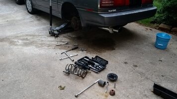

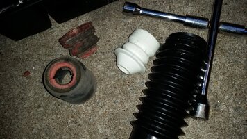

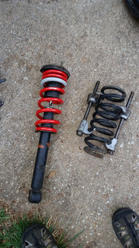

Okay...Replacing springs on the rear of a TEMS car SUCKS.
I had to half-remove the rear seat side panel, as well as the rear hatch plastic, just to get the TEMS cover off!
So now I'm halfway done with ONE side of the rear...
Then, when I got the old spring off, I found that the oem bumpstop was crumbling in my hands, so I went to Autozone and picked up some replacements.
My goal is to get the spring work done today, then replace the leaking coolant line. Also, I have to have to go up to the tire shop to have new Toyo's put on my spare set of XXR's.
I was originally going to buy a set of TT rims, but nobody local has them, and since I had the XXR's sitting in boxes, I figured I should save money and just make use of them instead.

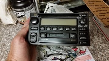

Also, I received my replacement deck for the car; Not stock, but looks stock and adds cd function.

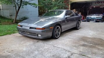

Here's a before and after shot, showing the wheels, and height change(subtle):

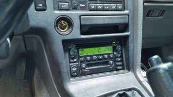

Got the new deck in, seems to work well.
It also got rid of all the buzz and noise of the old unit.
