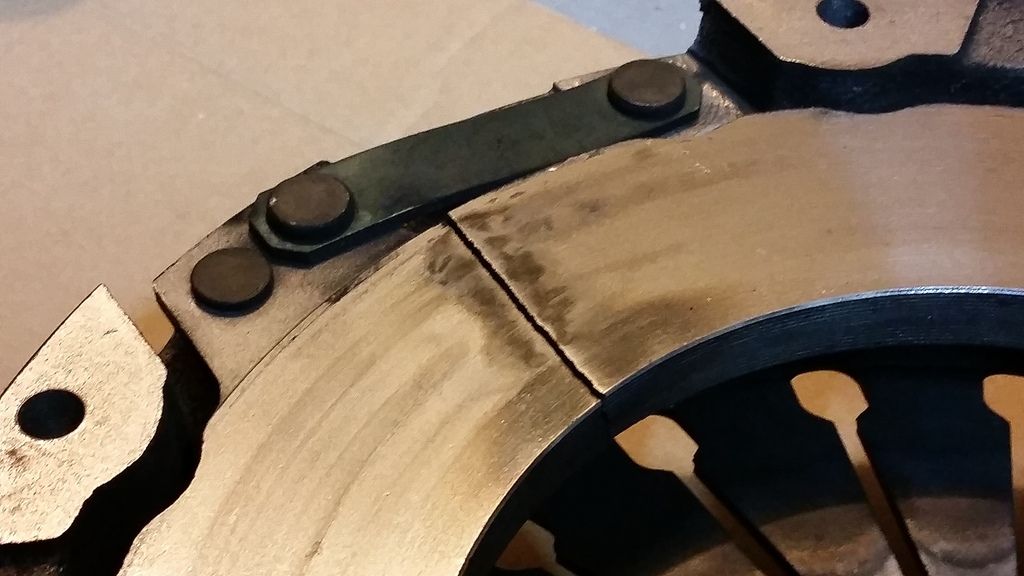

So about that clutch job...
Immediately upon startup, i had a bad vibration.
My immediate guess was that the pressure plate was out of balance.
So i finally got around to re-removing the tranny, and pulling the clutch for balancing.
But i find this:
Guess it wasnt a balance issue.
This was just a cheap replacement clutch from Ebay. Not sure if the pp was defective, or if i unevenly torqued it down and caused it. Regardless, i contacted the seller, and they're send me a new unit, no charge.
Ps, while im at it, i will be replacing the center support bearing, and also the high pressure power steering line- it looks like it has a slow leak.
This supposedly 'short' build thread continues...

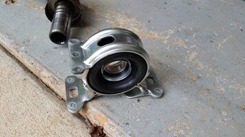

So I finally got home from a 9 day trip, and found a bunch of parts waiting for me.
Took the flywheel back to the machine shop to have it checked; I wanted to make sure the pressure plate issue was just a fluke, and not an uneven mating surface.
Then I replaced my driveshaft support bearing. Much easier than I expected.
I'll try to get the new clutch installed tomorrow.

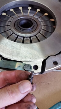

So yesterday, I got busy on replacing the bad pressure plate.
But before I went through the trouble of assembling it all, I wanted to assemble it on the bench to make sure it was all good.
So, I installed the disc, and bolted down the new, new pressure plate, in proper sequence, and looked it all over for any binding or unevenness.
Fail.
A rivet/guide that maintains the friction surface, fell out. Looks like the head of it either sheared or wasn't tight enough into the plate to lock it.
After disassembly, I saw that this caused the diaphragm spring to warp on one side, and is unusable.
So that's two for two.
I ended up cleaning up my oem pressure plate, and reinstalling it, no issues. Car is back together, and running nice, no vibration.
That teaches me to spend the extra cash for a quality clutch, period. A lesson that I'm sure a lot of you new from the start.

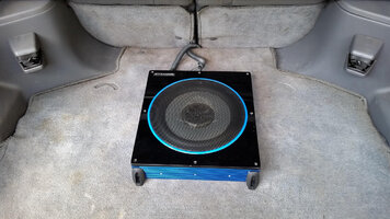

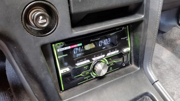

Update- and hopefully one of the last:
I re-upgraded my sound system. The replacement head unit from the Camry started having tapedeck issues, just like the original unit.
So, I sold out, and went modern. Complete system, minus rear speakers(haven't touched them because they sound good) was $300.
This included:
pioneer Bluetooth head unit
10" powered low profile sub
4" Kenwood front speakers
All cables, connections and harness adapter.
Sounds awesome, handsfree calling is super clear, and it's nice to have Pandora, controlled through the head unit.
I put an entire writeup in the Audio section. This is all the audio power I need for a daily.

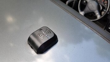

Just a quick update on my short build thread, since I've had the car for about a year now.
Car is running and looking great, but with all things old, constant maintainence is required. Along with that, occasionally comes upgrades.
Nothing serious, just BPU. One issue the car had, was that a previous owner had installed a cb antenna right in the roof, by drilling a hole through it. I finally solved that this
week, by adding SiriusXM to the stereo.

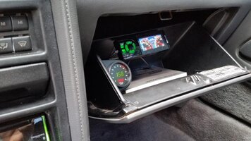

What is holding the neo in place in the glove box? I am actually looking at doing something like this with my non street legal gauges and components. Have to love that Ca BS.
The Neo is held in place by a lexan mount. It is simply 1/8" sheet lexan that I heated with a heat gun, and bent to roughly a 135 degree angle, and riveted it into the top edge of the glove box.
I then used 3M lock tape(like Velcro, but way stronger), so that it can be mounted, or pulled out for tuning.
