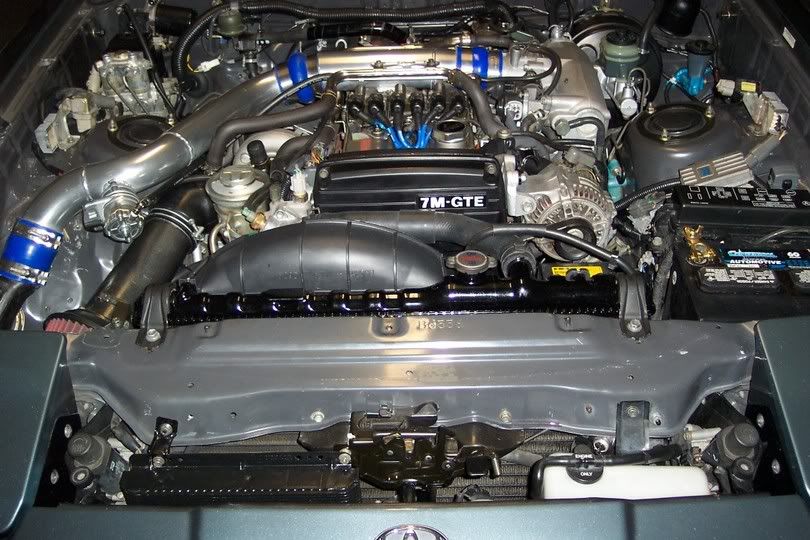

I took some pics of mine after it's all finished and buttoned up. Enjoy.

bowtiebuba said:
supra4ever you have the hpf kit right what did you do to mount your dipstick?
Hello
Yes I have and an extremly nice kit by the way.
I ajusted the dipstick tube a bit in order to clear the lower runners of the manifold and then I welded a new brace to the tube that connects below one of the bolts holding the compressor housing.

GrimJack said:
Nice battery! Does that thing have enough power to crank the car for more than a couple seconds? :D
Actually for being that small and light it packs a pretty good punch. Now, I'm not powering anything off of it like a million watt stereo or anything; but I have left my lights on for about 3 hours before, to my suprise it cranked up at its normal speed.
One thing you can't do tho is let it sit for a long period of time. Maybe about a month of just having your car parked could kill it. I daily drive though so thats no problem for me.

MDCmotorsports said:
What 'rubo is that and how did you remount the coil packs?
The turbo is an sc61 full t4. All I did was move them to the back extend the coilpack harness and reverse the plug wires.

GrimJack said:
Ha ha! Suze, that's great!
......... i see you have the bosch in there.
does it matter which way you install it, thats a really clean install theres no bend at all in the hose, i know its purpose is just to open according to vacume but does it matter which way it flows??? i have mine backwards compared to yours.
