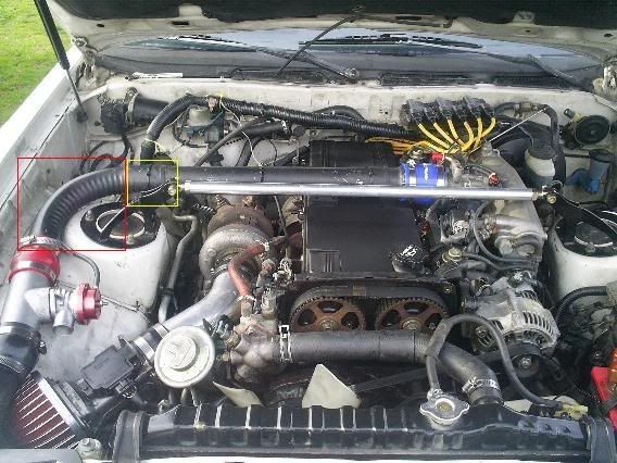

Jeeze I get bored, tell about it, and get bashed lol. Ok seems an explanation is in order lol. I used my red 86.5 to fab FMIC brackets for my 89 turbo car. I had some extra piping so I figured what the hell i'd hook it up to the intake. It was hooked up for 2 days before I switched it to my 89.

Ok lol. Here it is again:
Attached to this:
Which is this car:
No BS.

Wait, wait. I 'll give the benefit of the doubt on the joke for an n/a IC.
But this Ic piping thing you got going on....WTF are you on??
In the yellow box we have zip ties in place of hose clamps!!
In the red box that looks just like a peice of flex hose!
Not to mention the stuff goes down in size from the BOV adaptor pipe to the throttle body.
How about the missing fan shroud and, again, the missing timing cover... Why remove the cover from the most important belt on the car?? Next thread's are gonna be "What happened to my timing belt/crank gear/oil pump drive pulley/water pump/cam gears?" and, "Why does my car run hot?"
