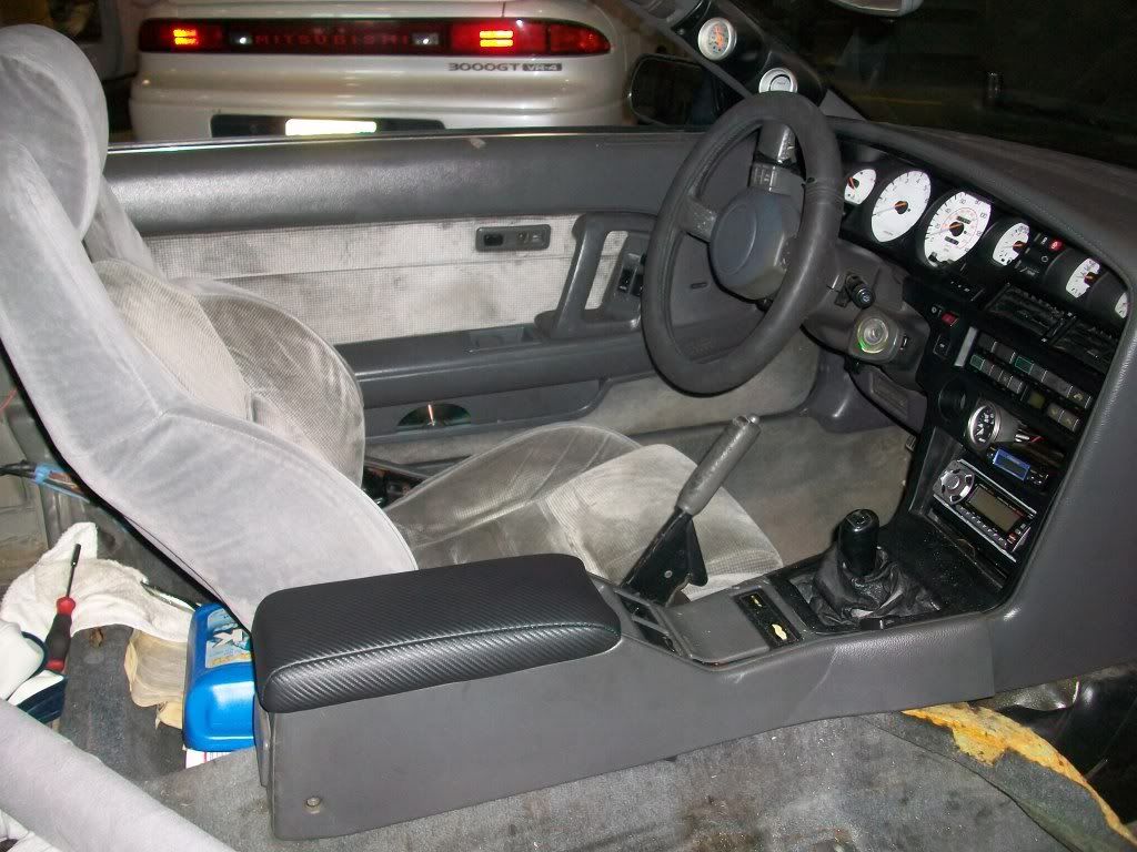

so heres my console lid ..pretty bad just like most
the foam was pretty bad off so it needed built up
so i got the foam filled in and shaped up
got my patterens cut out
wraped the foamm with a thin cloth to help protect the foam and also so you cant tell the foam was repaired.
i added 1/4" foam to add more comfort and a better look then factory.
pieces sewn up
all finished

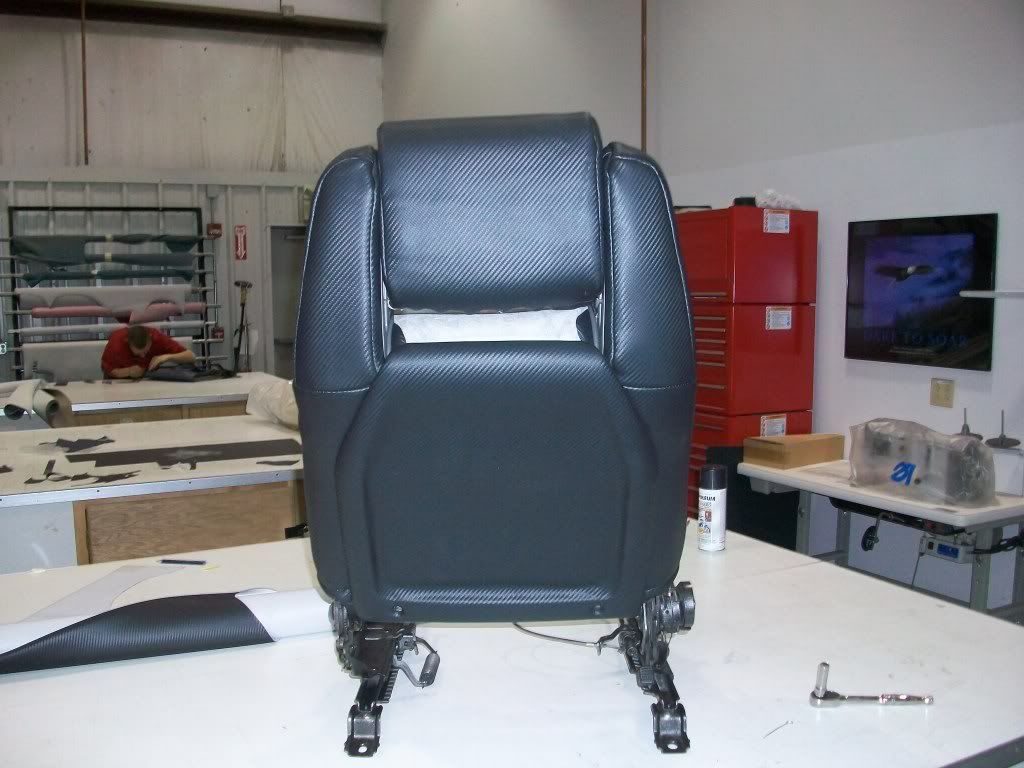

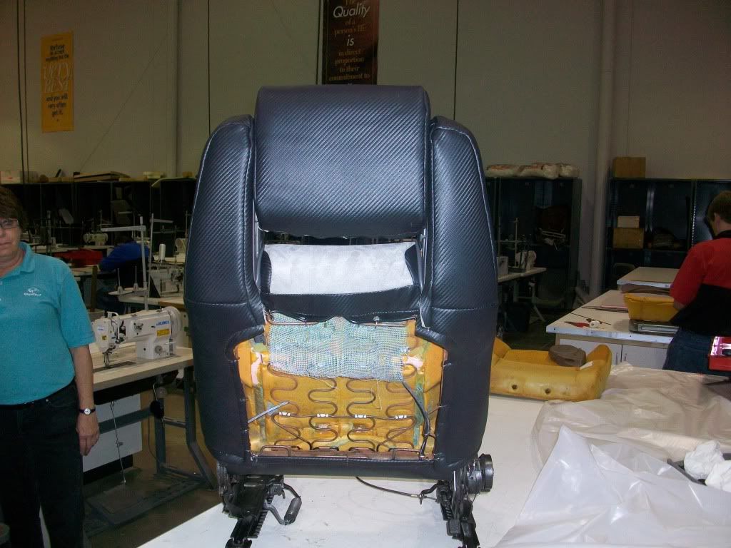

so here is my passenger seat back rest
tore down and all seams marked
i have my inserts, collars, and boxings made up readt to sewn together

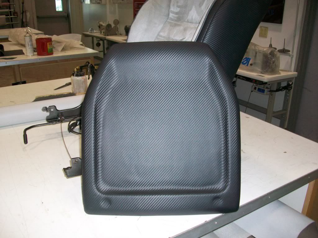

all sewn up.. i think my vinyl and cloth chocies look good together .
went with a carbon fiber vinyl and ash grey micro suede which feel amazing!
test fit was perfect not too happy how the head rest zipper turned out on the vinyl so i need to got back and fix that but other than that all seams line up and look amazing

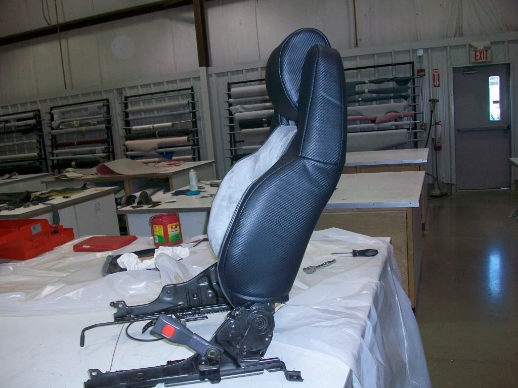

seat fram sand blasted then painted
all mounted up looking good

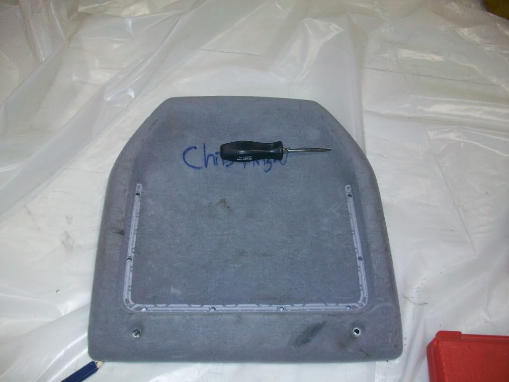

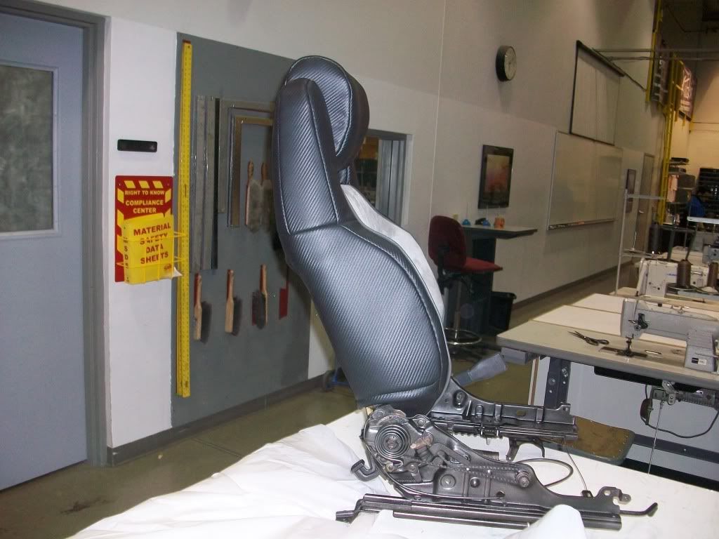

back cover before
back cover after
and back cover installed
how its sitting right now .. both seat are getting done, door panels, and carpet.

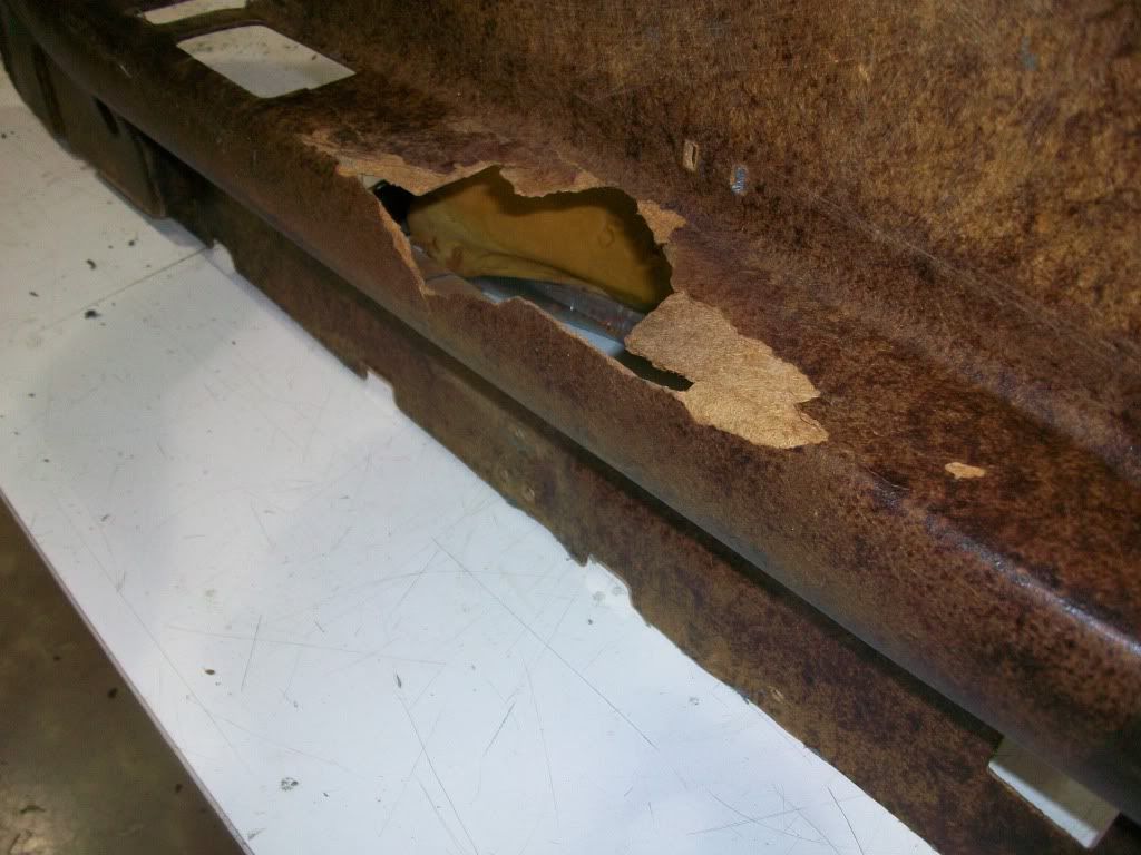

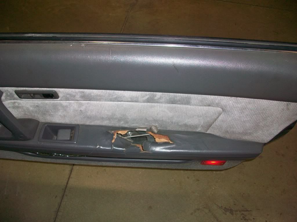

pass side

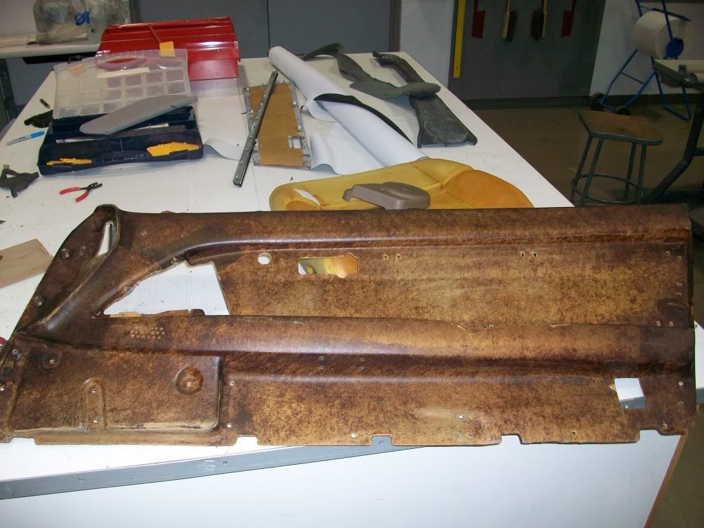

nasty hole :(

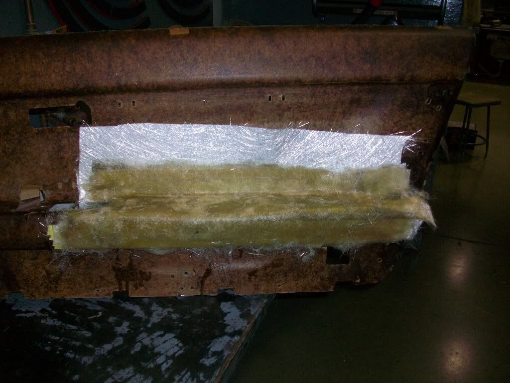

all tore off

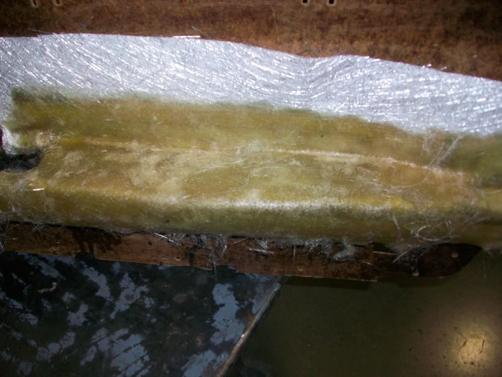

and the further extent of the damage
and the fix
