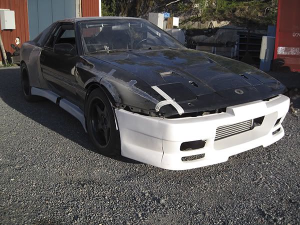

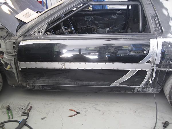

Newer pics

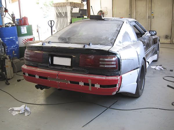

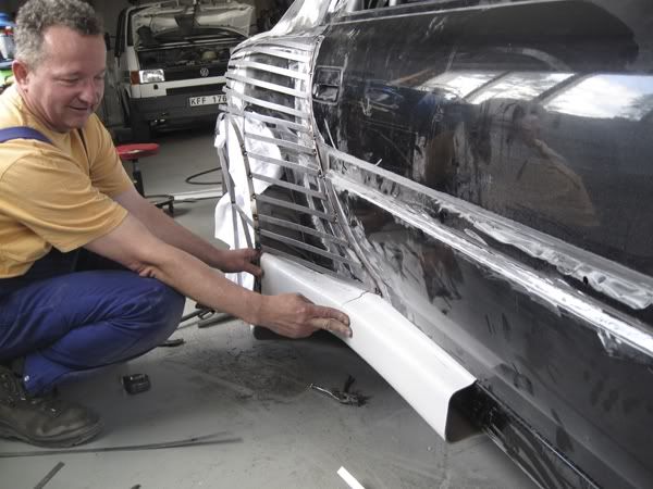

My incredible builder Zoran!

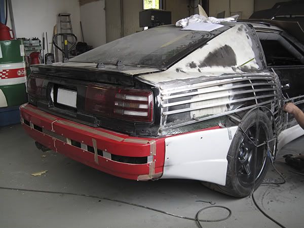

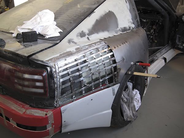

One side nearly done

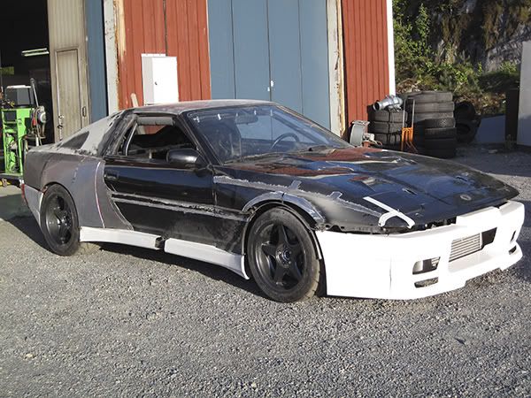

Flateric: It is an modified Greddy Gracer front bumper. Thx!

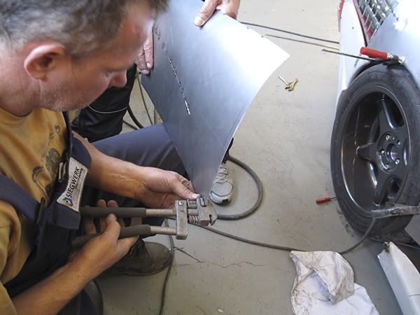

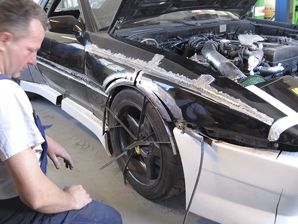

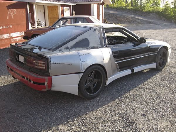

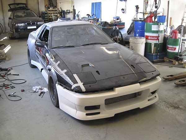

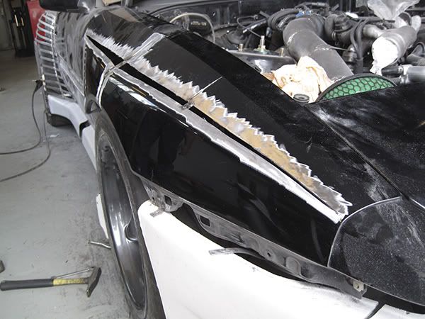

Astounding. I like that your fabricator is using sheetmetal for the widebody; fiberglass crushes very easily. I'm in the process of fixing just such a crushing accident, and was thinking about doing something similar to the metal cage your guy built for reinforcement.
Also, what are the specs on your wheels, width and offset-wise?
Turbo Skegget
Jul 27, 2005
217
47
Norrtelje
Thanks. The metal-skeleton will not remain on the car when finished. The wheels are modified Brock B1. Tires are 315 on the rear and 245 on the fronts.

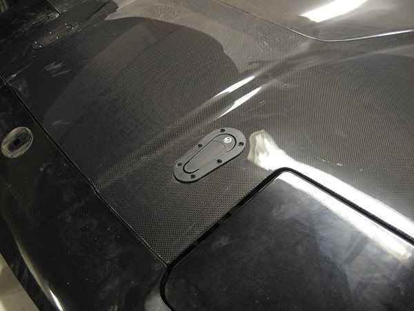

Glassfiber targa

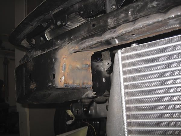

Modified crashbeam

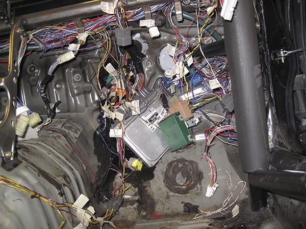

Wiring in the 2JZ
