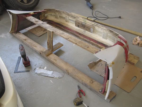

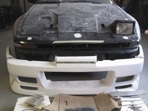

Cutting
Adjusting height on front bumper... :(
