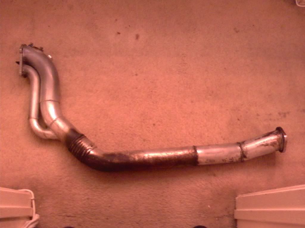

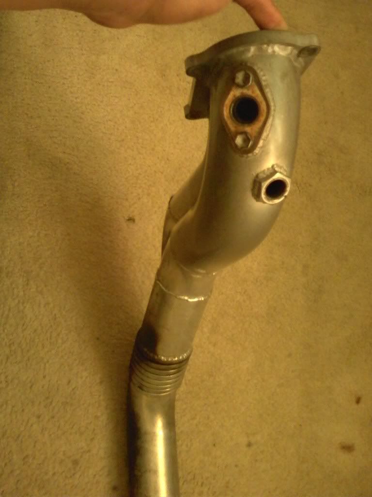

here's the one I have on my car, back when the previous owner got it (used)..

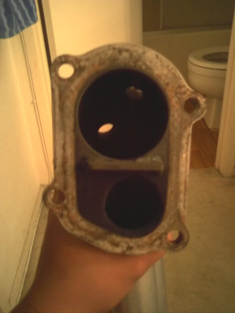

1. The DDP is a full 3" pipe, yes the hole flange at the turbo outlet is 2.5", BUT the turbo housing is only 2.5" at the turbine wheel, you cannot put a larger hole as the gasket would be blocking the flow. The flange follows the exact shape as the gasket.
2. The DDP uses a 1.5" dump pipe...add that to a full 3" pipe and you have way more flow area than a single 3" DP, the BIC standard DP included.
3. The Re-routed / Recirculated DDP has the wg pipe seperate for about 11" before re-entering the main 3" pipe. The WG pipe re enters the main pipe at a smooth 45 degree angle.

The only advantage (if you can say that) of it is the restriction on the wastegate side (and you can see that by the pictures posted of the used dp with the soot on the wastegate side (cause be turbulent undirected flow) vs the turbine exit side of the flange). And that isnt really an advantage at all, and can be replicated in many different ways and forms. So in the end you're paying the price for a sound.
