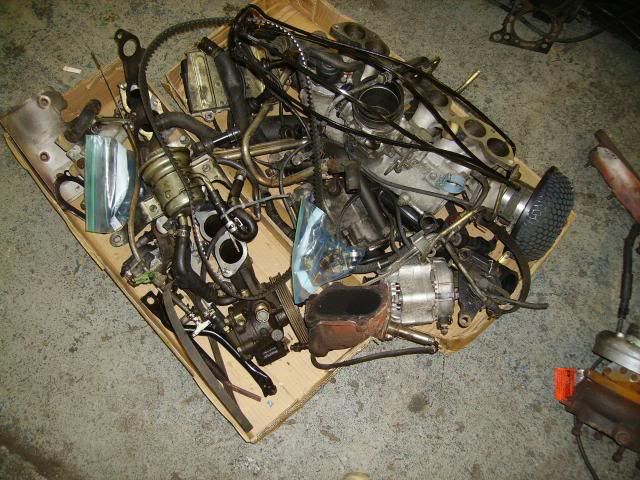

i stoped by the shop again and got a couple of pics.
heres the heart of the beast..... all sad looking.

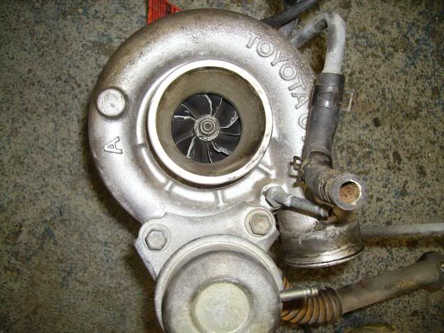

my busted ass turbo... my guess is the nitrous the guy used on it chewed it up...

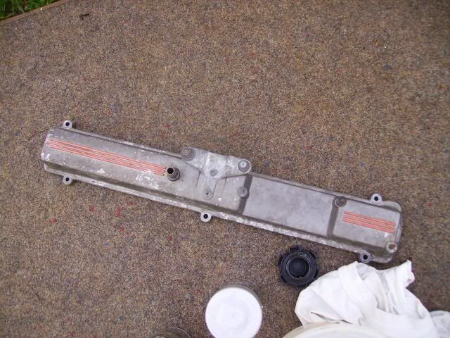

this is the pcv pipe coming from the valve cover.. it all full of this vanilla pudding looking goop.... nasty. this crap is all inside the engine and radiator... i hope it will all come out of the radiator.. if not i got more probs.
heres the car sitting with 3 other supras... its like a reunion thing lol.... more to come soon.

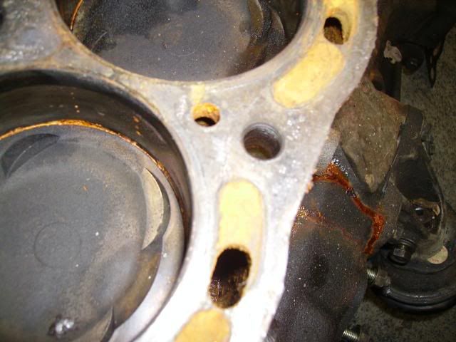

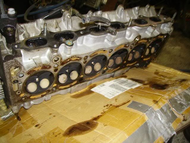

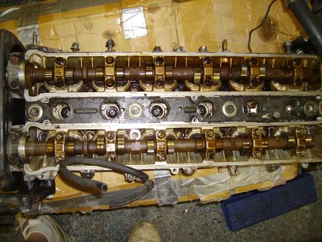

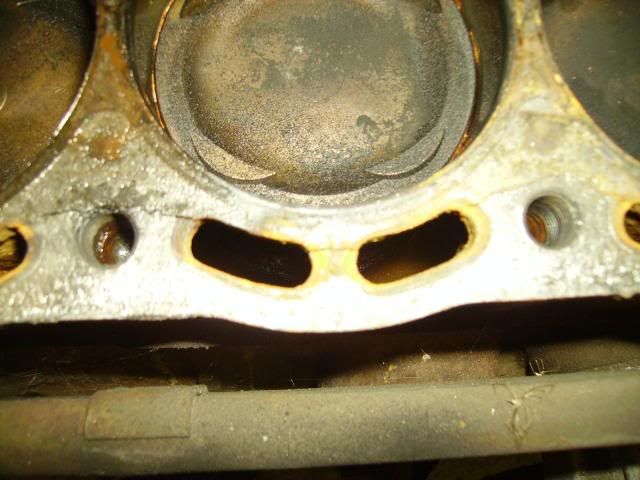

i went by the shop again the other day and got a few pics.. turns out my block is cracked in the wierdest place... i have never seen a block cracked like this b4. also got a few pics of the head and the turbo.... heres some pics.
hard to see it in this one but look close.
notice all the cracks around all the cylinders??? im guessing its from the guy before who sprayed nitrous on it all the time... glad i got a new block.. more pics after the head gets back from the machine shop... hoping its not warped to bad .

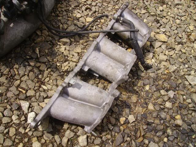

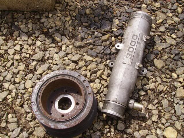

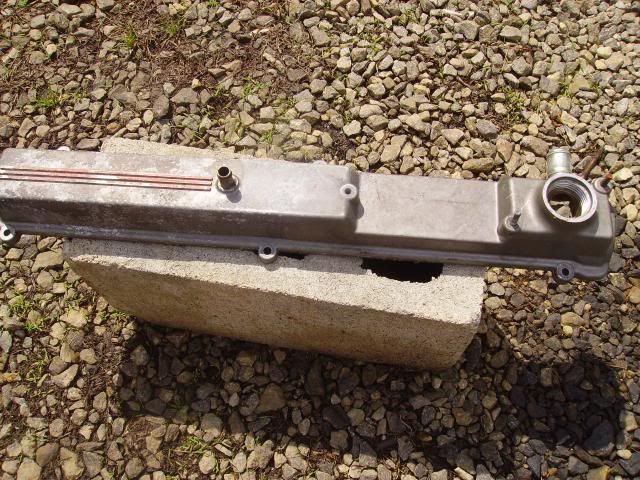

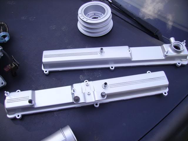

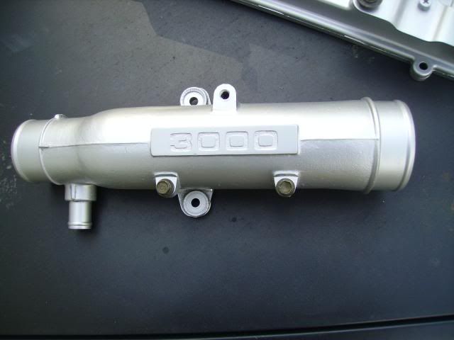

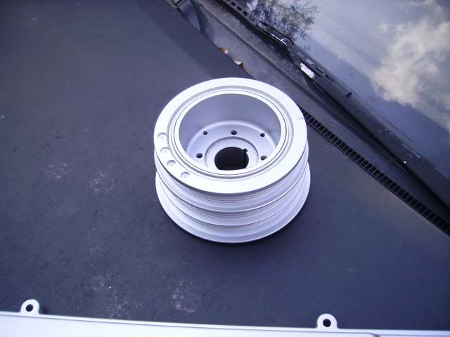

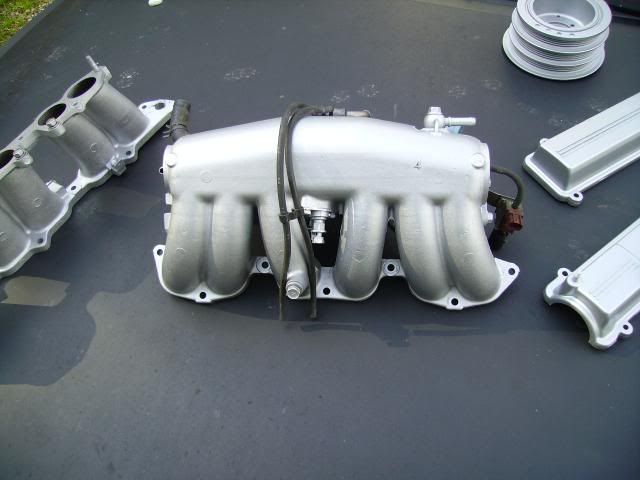

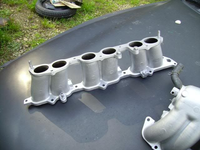

i talked to the guy from the shop and found ou tthat my head is warped all to hell.... so bad that if they try to smooth it out it would take almost 2 hg's to make it fit right... lol so i bought another head instead. it will be getting all the machine work this week. i'll post pics asap. also i found out that my car has a centerforce racing clutch in it also. lol sweet. i'll post pics soon. i also painted some things for the engine using high temp paint. 3k pipe upper and lower intake runners, under drive pulley, valve covers. here are some pics of these... i will be putting the stripes black on the valve covers and the numbers on the 3k pipe also.
not the best in the world but it will work for now.
