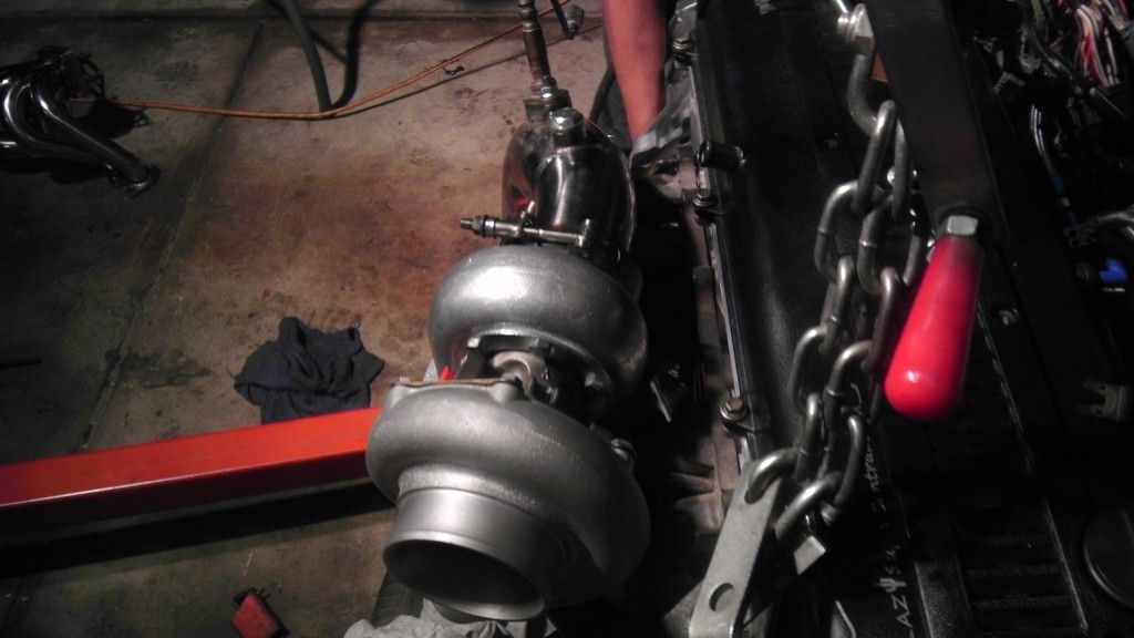

Turbo Habanero;1881793 said:
Thanks for the offer bud but that's not big enough

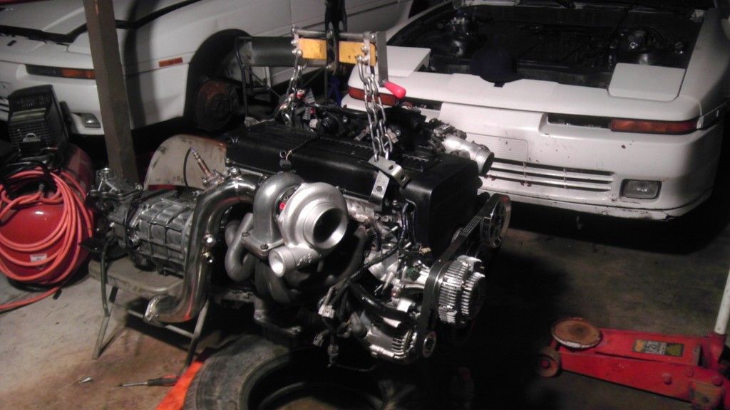

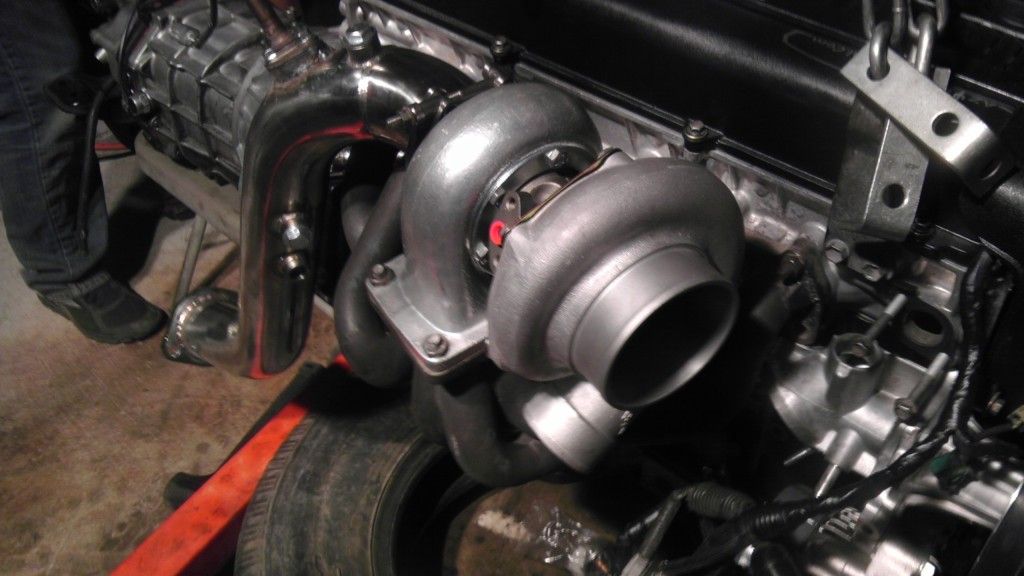

Albert it going to take my T67 t3 turbo and swap a T4 .70 AR exhaust housing on it today for me,
Oh ok, just figured i'd offer in case you wanted to stick all T4 stuff :)

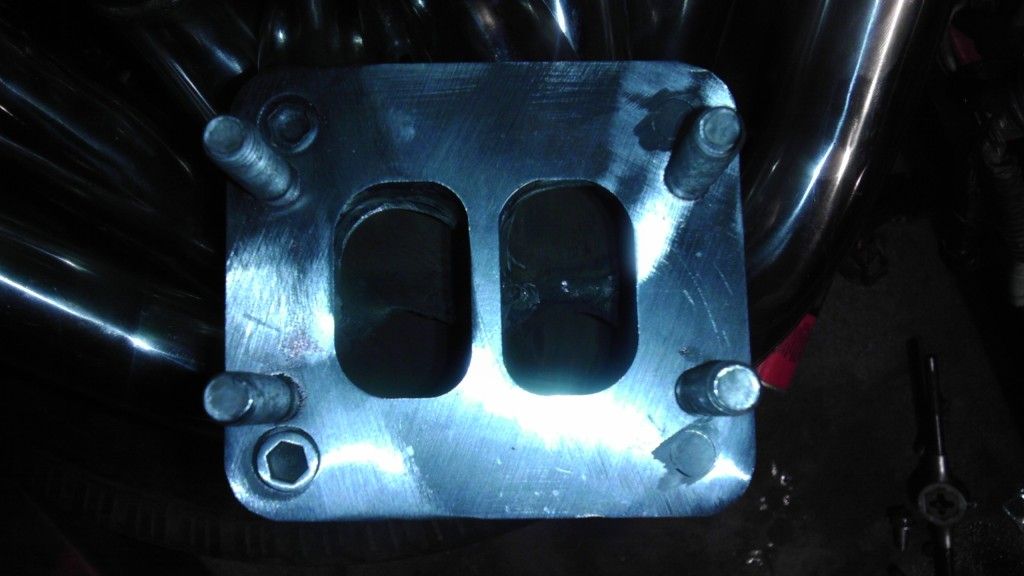

1986.5supra_kid;1881994 said:
awesome thread!

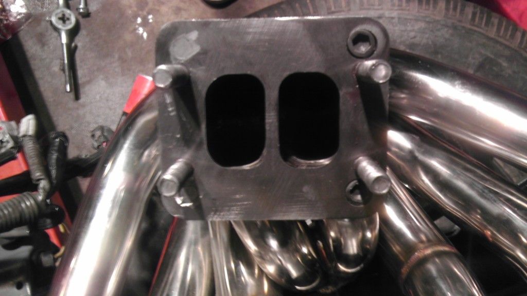

so that adapter your using is this the same one?
im putting a hx35 on a 2jzge and it just so happens its a divided t3. and my manifold is a divided t4
http://www.ebay.com/itm/T3-divided-...Parts_Accessories&hash=item1e651293ca&vxp=mtr
Turbo Habanero
Apr 28, 2009
4,229
Tucson,AZ

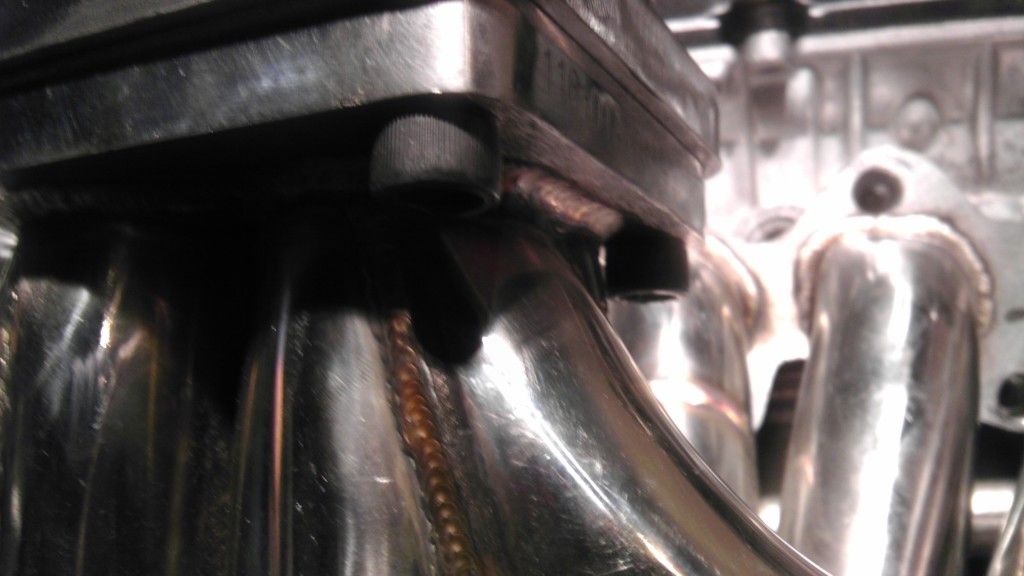

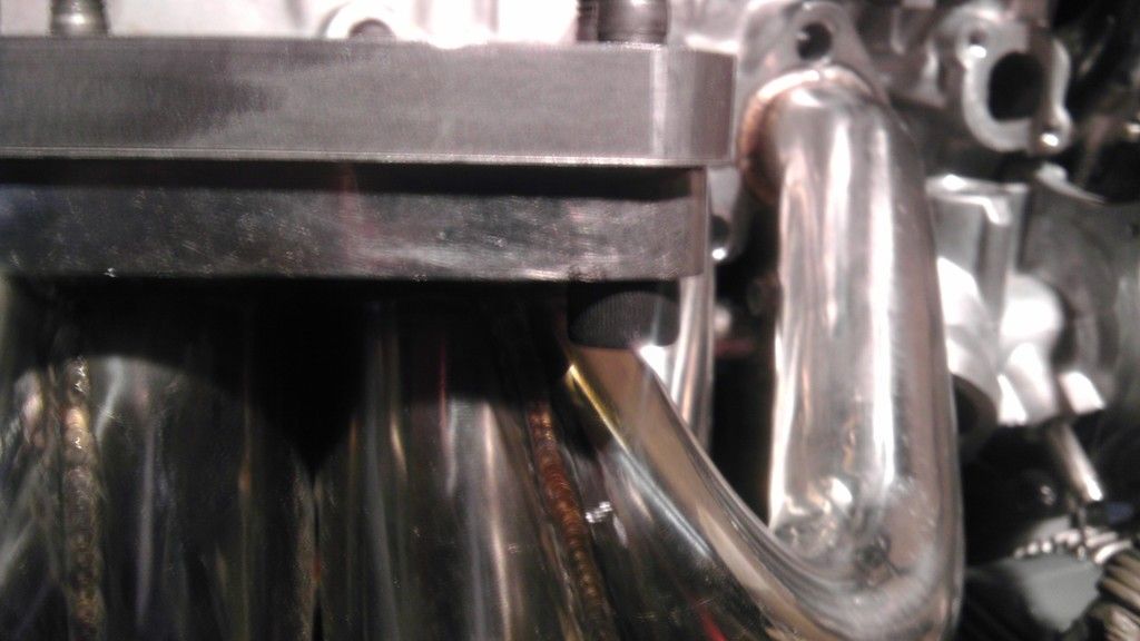

1986.5supra_kid;1882240 said:

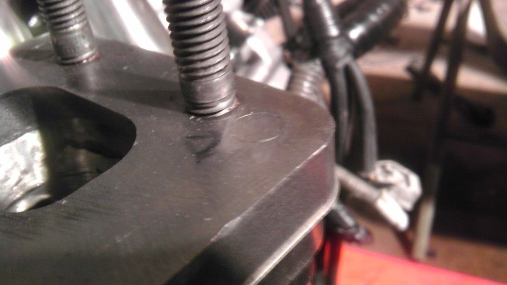

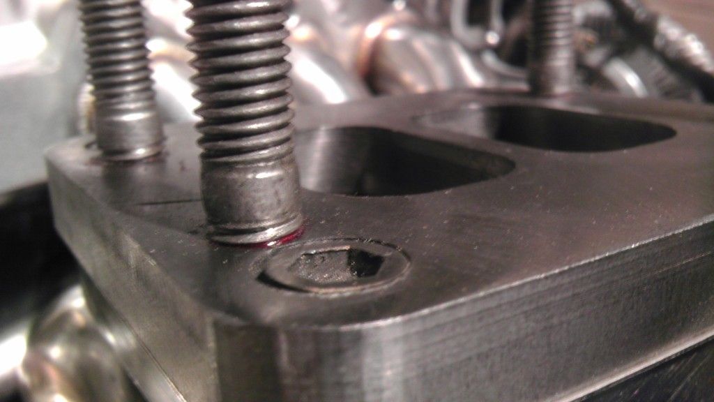

can you explain what has been done to the adapter?
Very simple
the two head bolts on the bottom - we had to drill out the threads on the manifold then screw down the bolts to the flange
the two head bolts on top - we had to drill the threads out of the flange and open it up just enough to where the head bolt would sit flush in the flange (so just the length of the head on the bolt) and then screw them down using the maniold threads
