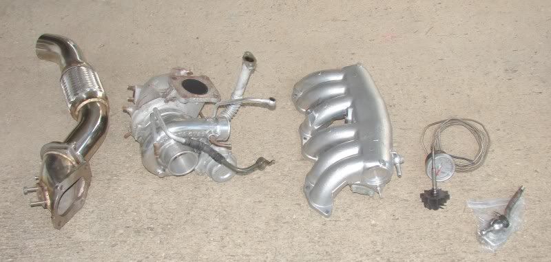

Well, I made the 610 mile round trip to Dogdrake's house to deliver my Bomex sideskirts. In trade, I got a low mileage turbo with a polished compressor housing, a ported/polished elbow and a 3" flange with flex that he had needed the back section off of, a shiney intake manifold, a short shifter, and a turbo shaft to repair my other turbo with. I also bought a HKS Oil Pressure Gauge from him as well.
Chuck is a great guy. He also helped out on a couple of problems with the Trailblazer. He put a stepper motor in my oil pressure gauge that was messed up. He also allowed me to learn the process as he went along, in case I wanted to try to make some money doing it myself. Then he hooked a computer to it, and cleared the code that was present due to some emissions problem. It pointed us to a sensor that was not plugged in completely. We cranked the truck and let it run for a good while with no idiot light, but it did actually come back on before I got back home. He told me if it came back that it was probably a common problem with the fuel filler neck as it meets the tank. His wife also has a TB, and he has already crossed that bridge in theirs.
And, he looked at my turbo, and confirmed what I suspected after making a video of the bad turbo. I have a broken shaft in it. That is why he threw in a shaft.
I'll take pictures of all of the bling tomorrow.

AND........Here is the promised picture of all of the new goods.
