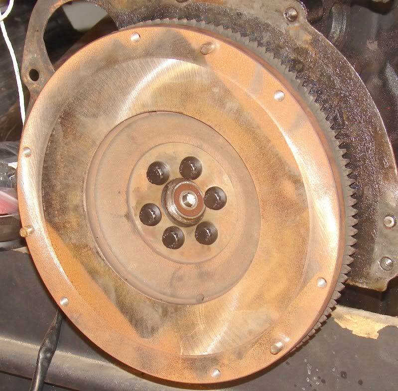

One Step Closer!!!!!!!!!!!!
Here's a pic I have waited 3 months to take. The entire old clutch has now been removed. I got the old pilot bearing out with the newspaper and PB Blaster method (Dave I tried your method first). New Pilot Bearing is in, and I mounted up the resurfaced flywheel with new ARP hardware.
Now, I have a question or two to ask. I know the answer, but I am going to ask anyway. I put a lot of heat to the bolts trying to get them out. I heated the crank to get the pilot out before trying this. Should I replace my rear main seal? I see no signs of heat on the current fairly new seal. It looks fine. But, I do NOT ever want to go through this again. The answer is probably replace it for peace of mind, and because it is cheap to do. So, if I am replacing it, I have a couple of questions. Does the oil pan need to be removed to replace it? Is a parts store seal OK, or do I need to get a Toyota? Is there anything I should be aware of while doing it?
Also, For the flywheel, is there anything I can do to slow the surface rust? Can I assume that a few spins of a clutch will take care of it? Will WD-40 be Ok on it? I don't want to slick a friction surface without knowing for sure.
Rear main seal replacement would definatly be a peace of mind. If its fairly new it should be ok as long as it wasnt heated to the point of melting. Somewhere around 250 degrees should be alright. Maybe just inspect the lips and spring on the seal to determine.
From what I recall the pan will have to be removed to get the seal retainer out.
Dont wd40 your flywheel, if anything clean off the flywheel before attaching tranny. The clutch will burn off that little bit of surface rust within seconds.
I did not take my pan off when I replaced my rear main seal. I just used a small screwdriver and a pair of needle nose pliers to pull it out and then just gently tapped the new one into place.
Maybe I did it wrong but it's not leaking now.:dunno:
Scott, I would replace it just for peace of mind sake.
