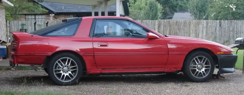

A Couple of new Pictures to keep the thread alive!
It has a front bumper just sitting on it for now, and the hatch shade installed. And, it has 3 out of 4 of my wheels on it now too. I think it may start it's life with black bumpers front and back, unless money changes any time soon.

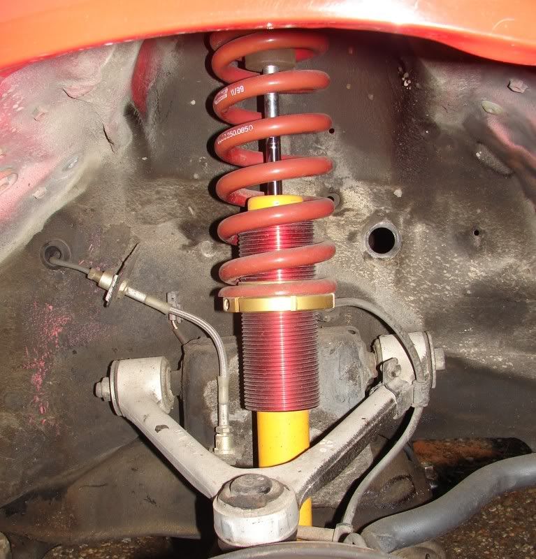

And here is what is under it suspension wise. I'm no expert on any of it. He told me it was Koni shocks with some sort of "$1800" Coil over conversion kit. The springs appear to have an Eibach stamp on them. Anybody know anything about what I have here? The picture also shows the braided steel brake lines and a little bit of the Energy Sway Bar.
