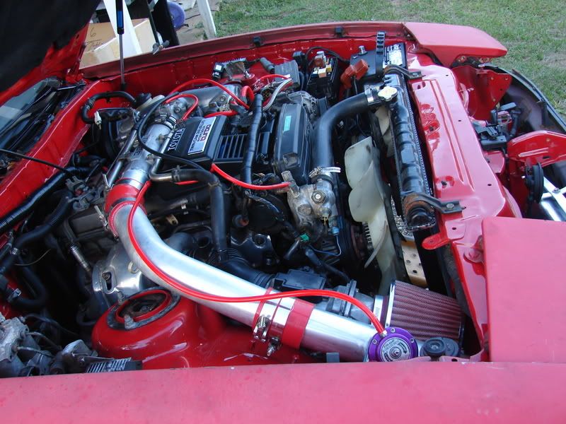

thats clean as hell!!!!
apart from the corroded thermostat housing, ABS, and the fans :D
EDIT: and rusted radiator mounts !!!! :( lol

SHhhhhhhhhhh.................You are spilling some of the future Jdub plans. The fan will be cleaned whenever I stop putting greasy hands in there, and a brand new fan shroud will be going on it, or whatever radiator I end up with.

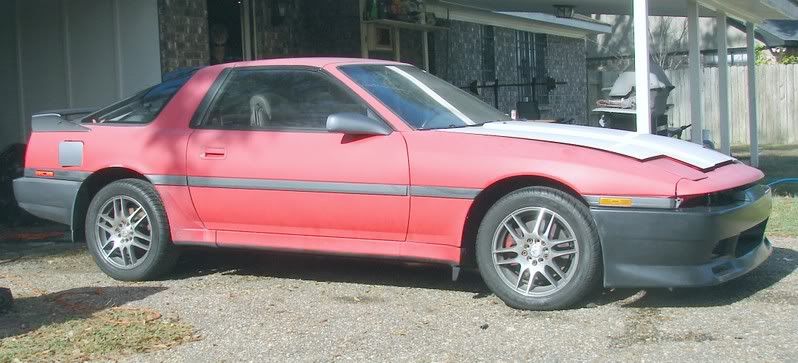

I've got good news, and I've got BAD news.
Today, I finished up swapping my springs. This last one was the easiest one on the car, and ironically the one I was scared of most. I guess a little experience paid off on that one.
After getting that finished, I set out to at least find my coolant leak. I started by refilling the radiator, then squezzed the upper radiator hose to provide a little movement. Right away I found that I was leaking from the water ling on the turbo. I replaced that hose with a good piece of extra fuel line hose for extra protection. I repeated the hose squeeze to see if it was for sure fixed. That's when I found another leak. It was the hose on the driver's side of the motor running into the fire wall. I tried and tried to fix that hose with nothing helping. I pulled the hose off to find that the copper/brass line was split pretty nastily. It is my belief that I will be pulling the dash apart to fix that. THIS CAR HAS BEEN A NIGHTMARE!
Here's a picture of the good. I kinda like my new stance, but it's a little hard getting used to it not being on the ground. Here it is...........4 rear struts for the world to see. I took the picture a little dark, and the lightening has bleached my faded red paint to worse than it already is, and I should have closed the hood.
