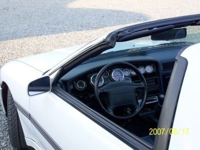

the guy i bought my car from had made a custom cluster out of fiber glass, ill see if i have a pic of it. it didnt come with the car.
edit: heres the best pic i could come up with
he useed the black plastic trim piece to get the size and general shape. its kinda hard to describe, but it looked really cool.
