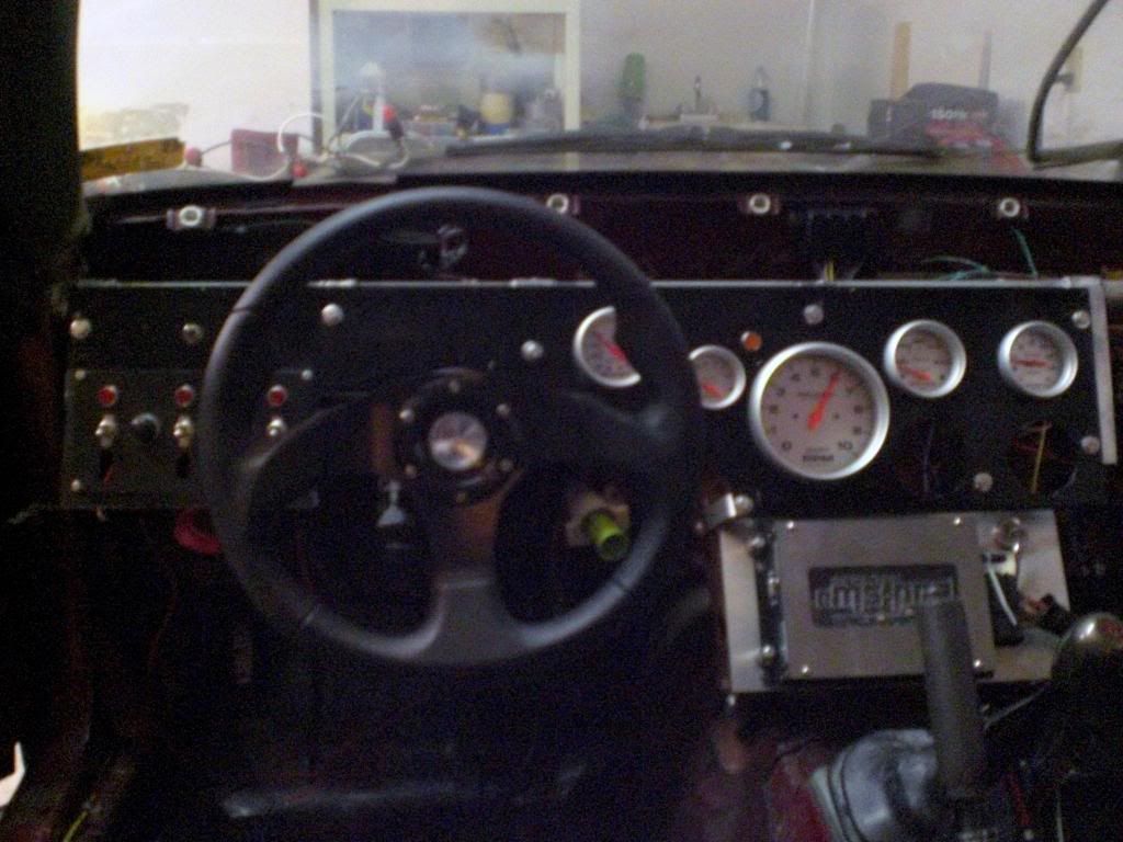

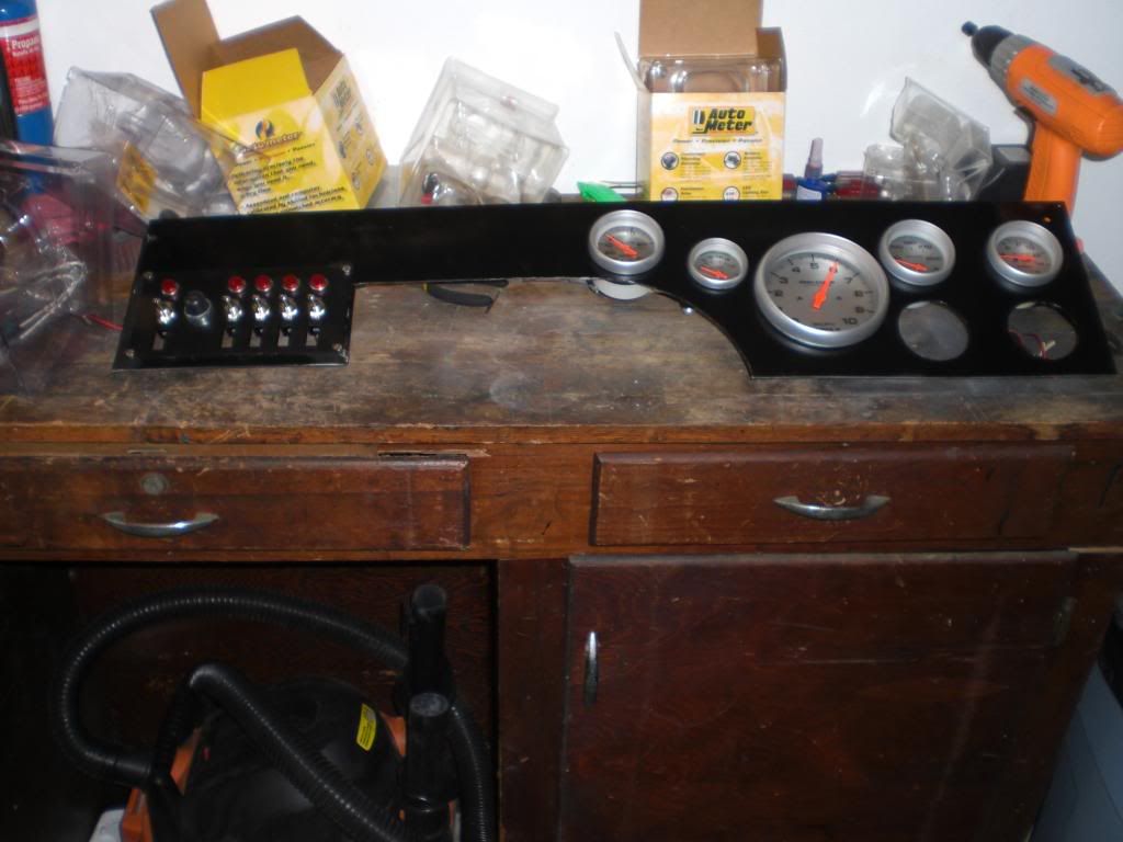

Im working on a cluster right now and I have a question about the speedo. Will the OEM cable work on a Autometer mechanical gauge? It says it takes a 1/16th cable. Without takeing the plastic off the cable I can only assume that it is. Or is it a metric size? This is what i got so far. Its a start.

i dont think there is any reason to keep the stock cable. it should be trivial to get an electronic speedometer to work with a stock toyota sender, which mounts at the exact same place the cable driven gear is located.
