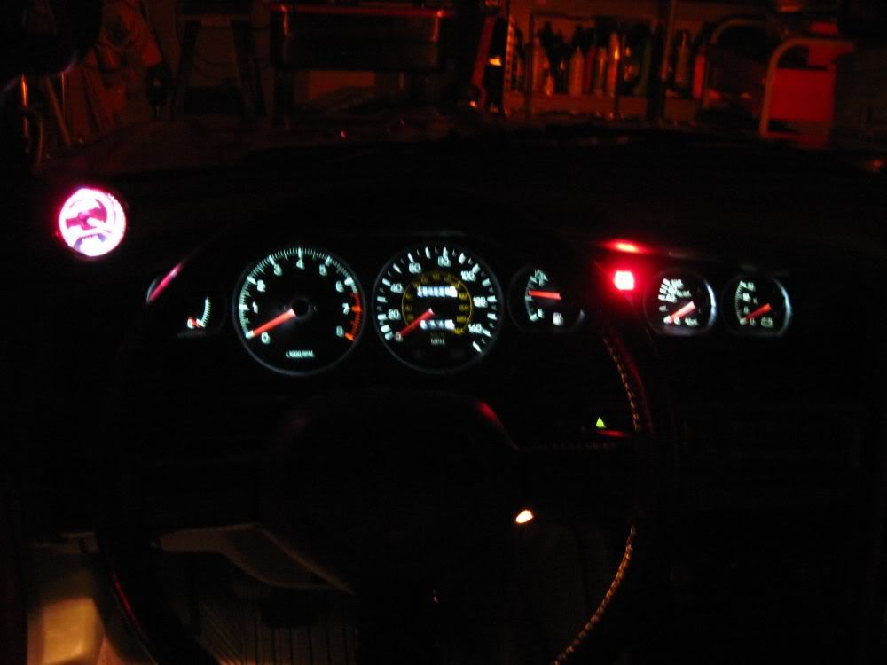

here is somewhat, what i finished for my gauge, there is still very little things i have to finish, i repainted the needles red, but i have to find a source to get the needle to be a lot brighter and i did wire it to the dimmer switch still got little bugs to worked out
just finished redoing my climate control and i must say it looks a lot better

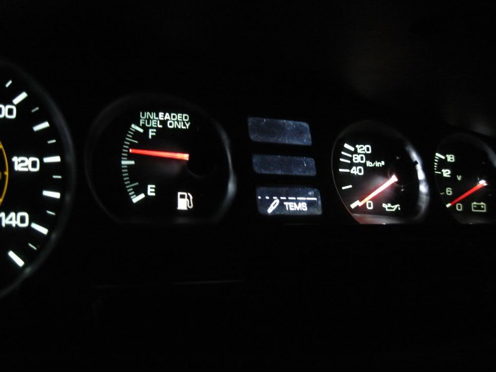

modmonster2008;1647985 said:
Might be a bump for an old thread, but this is how the white backlit gauges with red needles would look on a pre-89 :)
That actually looks great - really makes the dash look a lot more modern.

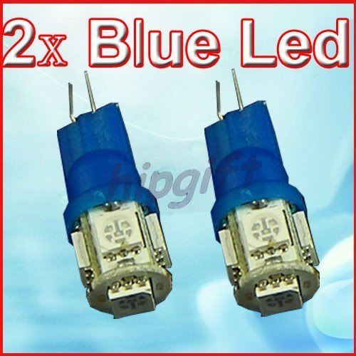

So... these are the lights i'm looking at putting in. Some confirmation would be GREATLY appreciated that these will work.
The CC LED's are Blue 3mm 3.0-3.2v 3000mcd 3.0-3.2v (so they dont blind me) for direct desolder and resolder.
I wanna use these for the button backlight and i wanna use RED with the exact same specs for the indicators and ^ arrow on the temp adjuster.
so will these work?
For the gauge backlight i figured these LED's would provide a better spread of light and not be so focused... thus less hot spots. Please correct me if i'm wrong
12v 5-LED #194 Blue SMD (surface.mounted.diode)
So summed up... WILL THESE WORK? Will i need to use any resistors for the CC LED's i have posted for buttons or indicators, if so which resistor would be preferable so they aren't blinding.
