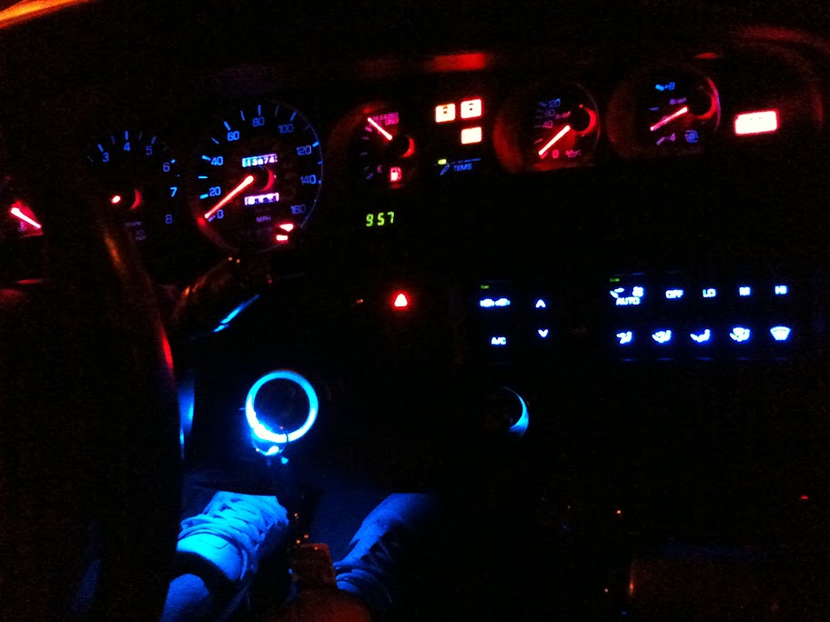

Good job suprarx7nut. Your needles seem to "bleed" out less light compared to mine.

No copper board needed! I ended up using shaved down proto boards. It's all installed and perfectly functional. I'll post up more pics and a write up soon.

Updated with the LED needle process. I had more pics, but I lost them somehow. If I come across them I will add to the post.
Albert has done this lighting as well and used a completely different manufacturing process.

I haven't seen anyone replace the clock with an updated display. I'd like a nice red. Unfortunately, unlike the CC number display, the clock does not appear to be any kind of standardized size and shape.
As an update to my needles, the solder joints in the LEDs appear to be intermittent. Looks great when they decide to work, but annoying when they dont. A decent iron and improved soldering skills would probably fix the problem.

Found some of the finished product pics for the needles. They've been working well for over a year now. It really updates the dash appearance at night. I rarely drive at night now, but when I do it's always a nice upgrade to make it feel like you're driving a newer car.
I'd love to get an actual circuit company to make some boards with real SMD's that are perfect, but I imagine the custom shape and required tolerances would make it a little pricey. Should mine start to fail on me down the road perhaps I'll pursue it.
Check the end of post 2 for the updated pics.
