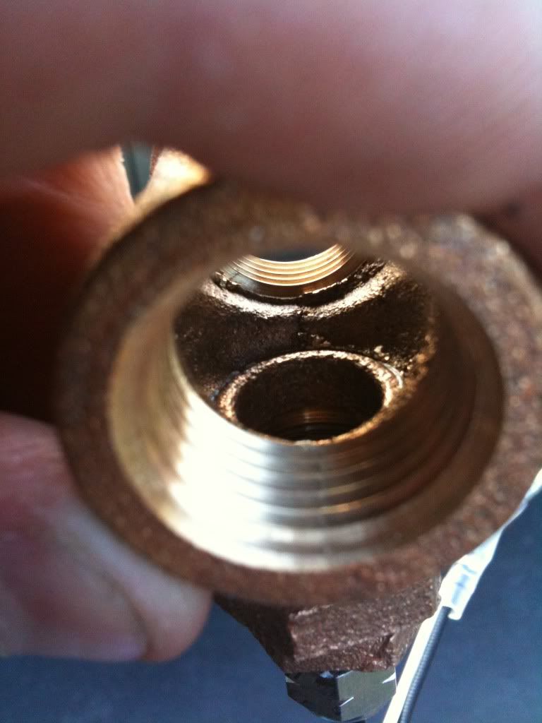

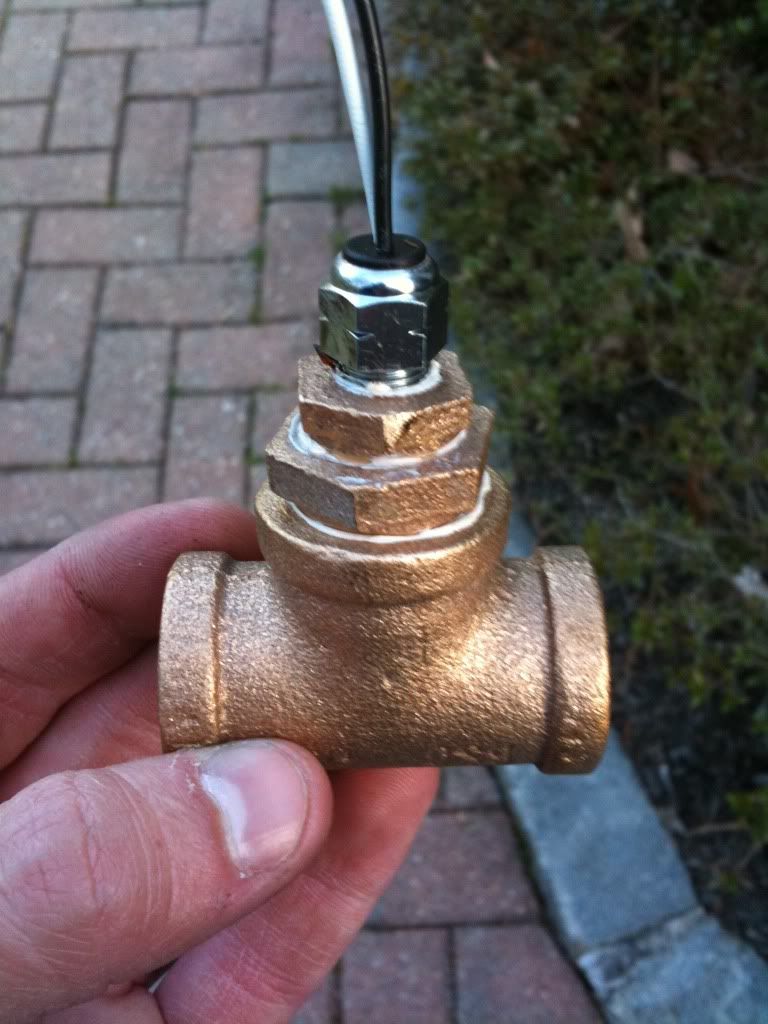

Ive been meaning to install my temp senders in before and after both oil and transmission coolers. I have been looking around for an inline fitting that i could mount a temperature sender in with not so much luck.
I went out and figured i could put something together and came up with this.
That is a 1/2 inch NPT Tee fitting that will go in the oil cooler circuit. As you can see the sender is neatly tucked out of the way as to not obstruct flow. Barbs will be put on either side to make the install easy. Ill be making another with a 3/8's Tee fitting and only the bushing that the sender is screwed into.

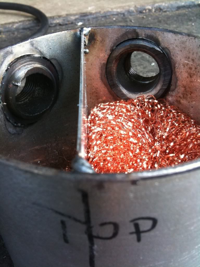

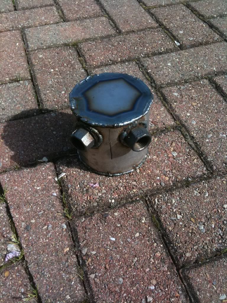

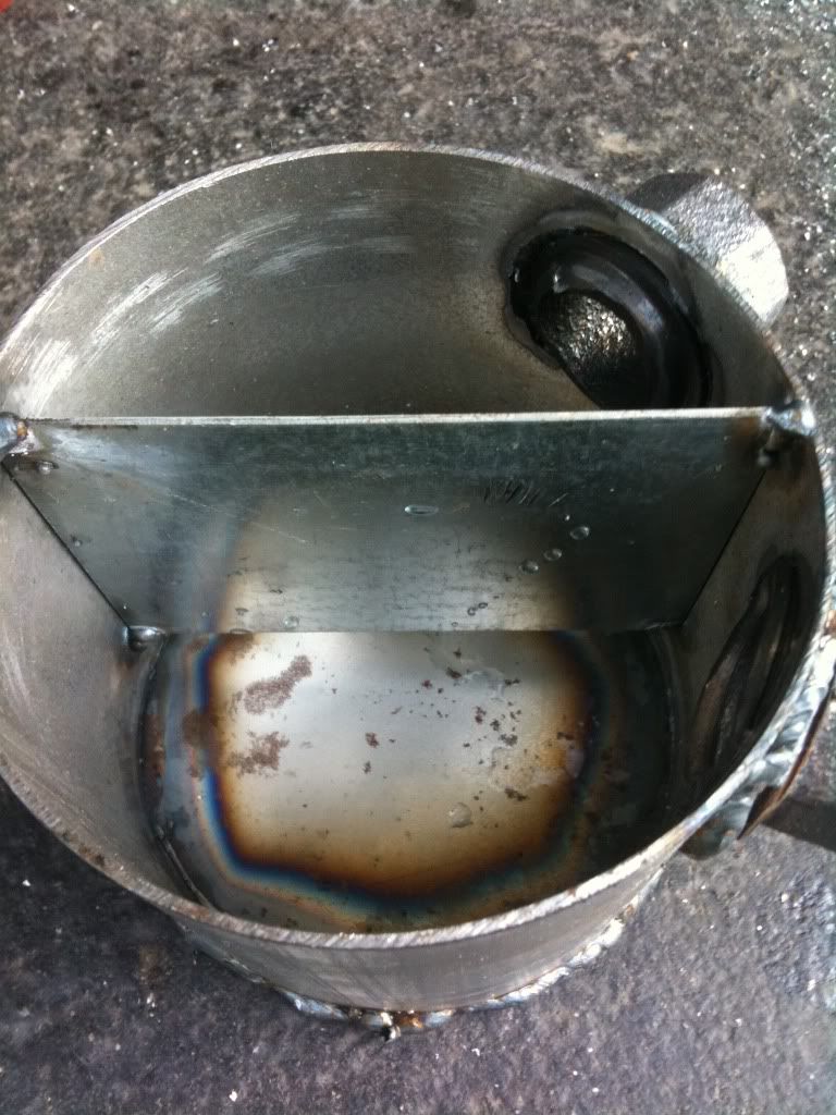

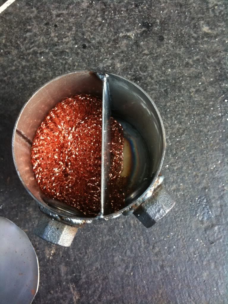

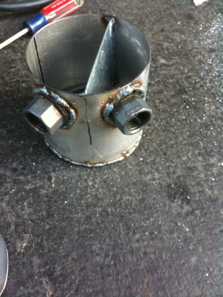

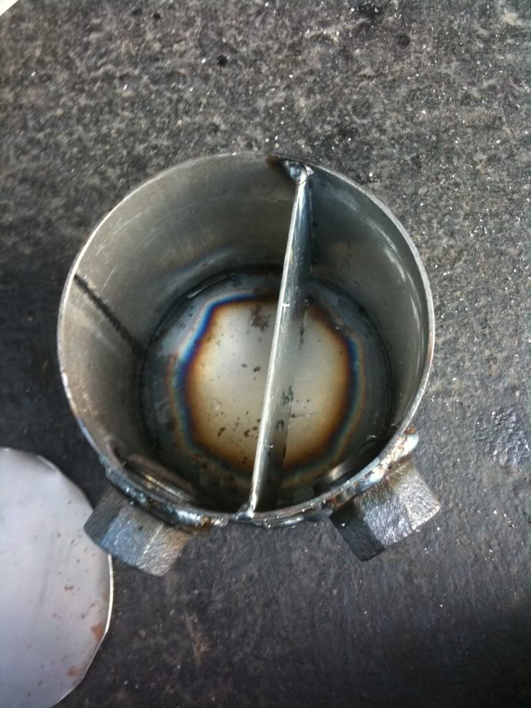

I also took it upon myself to use my new welder to make a catch can because i was tired of oil vapor making a mess.

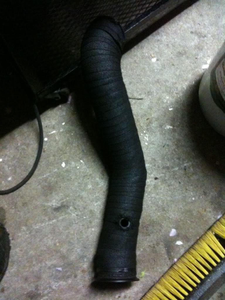

Ill put a drain on it when i figure out its permanent location and how i want to handle draining it.:aigo: I also finally got around to wrapping my down pipe to match the manifold.
Hopefully the water methanol kit gets here soon so i can get it in today and start some tuning! Im running out of room in this car.
64
I put a ball valve and hose on my CC for draining it, with the 7m I remote mounted the valve under the car behind the left front wheel, with the Chev I can reach the bottom of the can so it's there. :)
