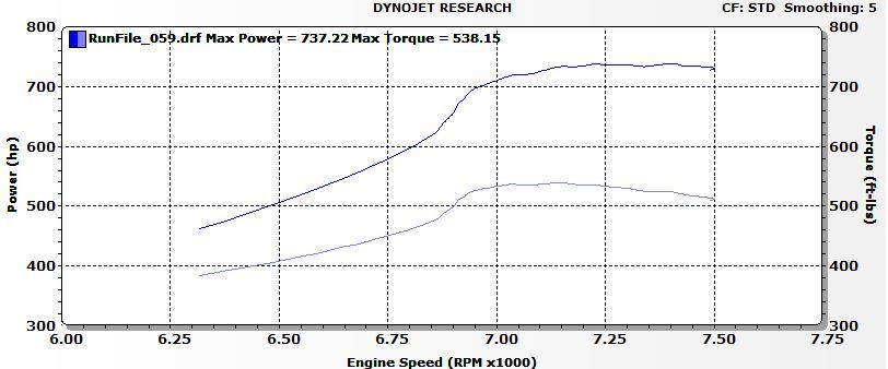

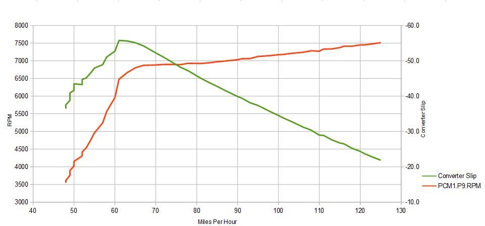

SO things just got serious. Made a trip to the dyno.
737HP at 30Psi on E63!

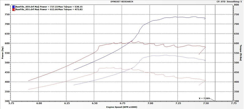

First pull VS last pull at 30Psi.
Converter is way too loose. over 20% at 7500rpm.

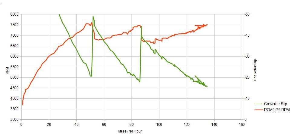

Heres converter slip VS RPM on the dyno pull.
Heres converter slip on my 10.20 pass at the track when it was untuned.
To compare, heres converter slip making a full pass now that its tuned.

Well it's like I said before. Stall speed is reletive and misleading. Lots of things determine what the stall speed of a converter is.
A small quick spooling turbo will make the same converter stall higher then a big laggy turbo because the motor will make more torque at a lower RPM.
If I had to put a stall speed on my converter it would prolly be in the 4500 range. It's very loose.
But if this converter was behind a stock twin 2j making 400hp, it would stall much lower and would be almost perfect because comparatively the 400hp motor would produce less torque.
As you can see from the charts above, the amount of slip in my converter at 7500RPM increased by ~7% when the only thing that changed was torque output.

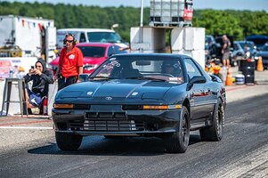

The car over the last 7 Years has progressed and been refined quite a bit. There is an airfield a couple of towns over that recently race promoters have been hosting some no prep events. I took a ride out there, not really to compete with anyone, but to see how i could do. I feel like i was able to do pretty well.
Here's a pretty good image from the starting line, and a few videos of races i had while i was there. I was surprised to win almost all of my races. Again, this wasn't really a competition, mostly just a test and tune type of deal, so i didn't actually win anything.
