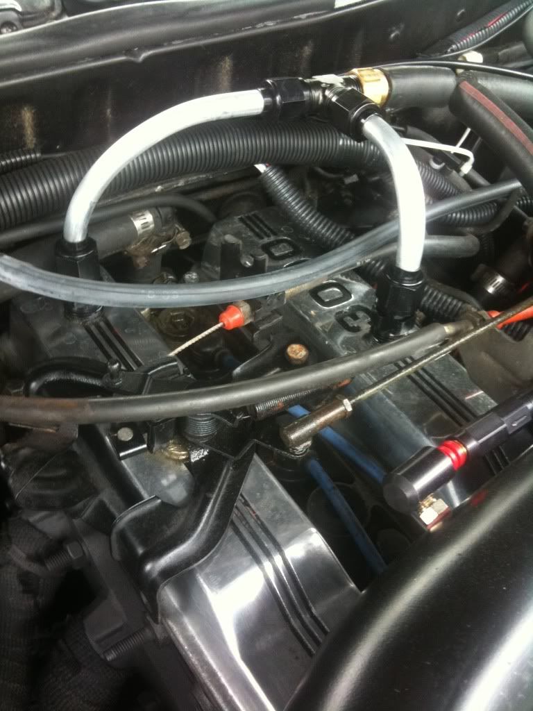

Yea i was figuring some type of valve on a hose. I gotta decide if im leaving it in its current position then i can drill a hole in the proper spot and weld on a nipple at the proper angle.
I really need to drill out my valve covers for 1/2NPT ports. Under extended heavy boosting im spitting small quantities of oil out of my dipstick. :(

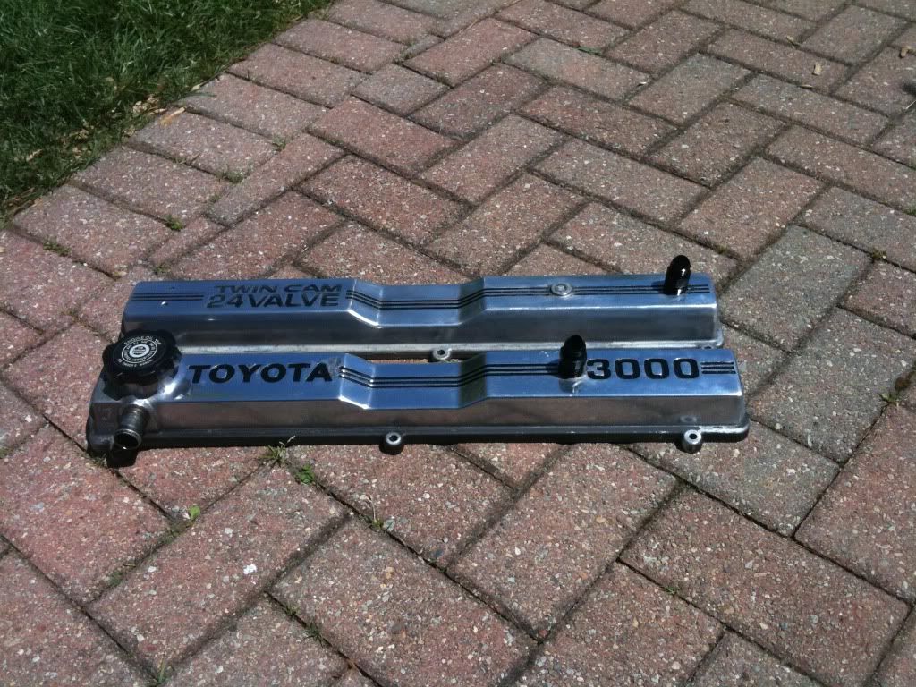

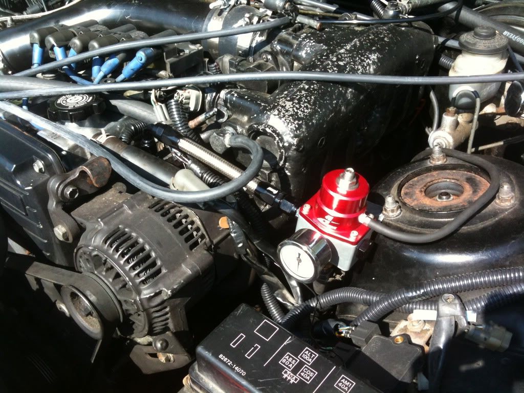

Well i wanted to drill out the valve cover PCV holes to run bigger lines and got tired of looking at one polished valve cover so i popped them off and did both.
While i was working on the car i installed the Aeromotive AFPR ive had sitting in my room for a while.
Im aware my engine bay is a disaster with lines running all over. Im going to clean it up one day.

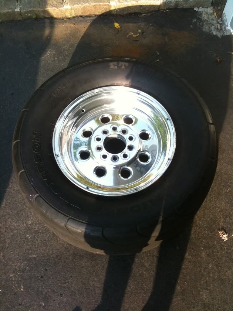

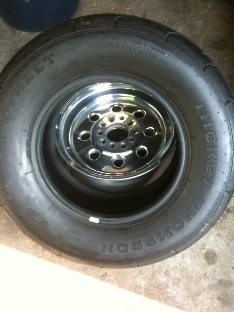

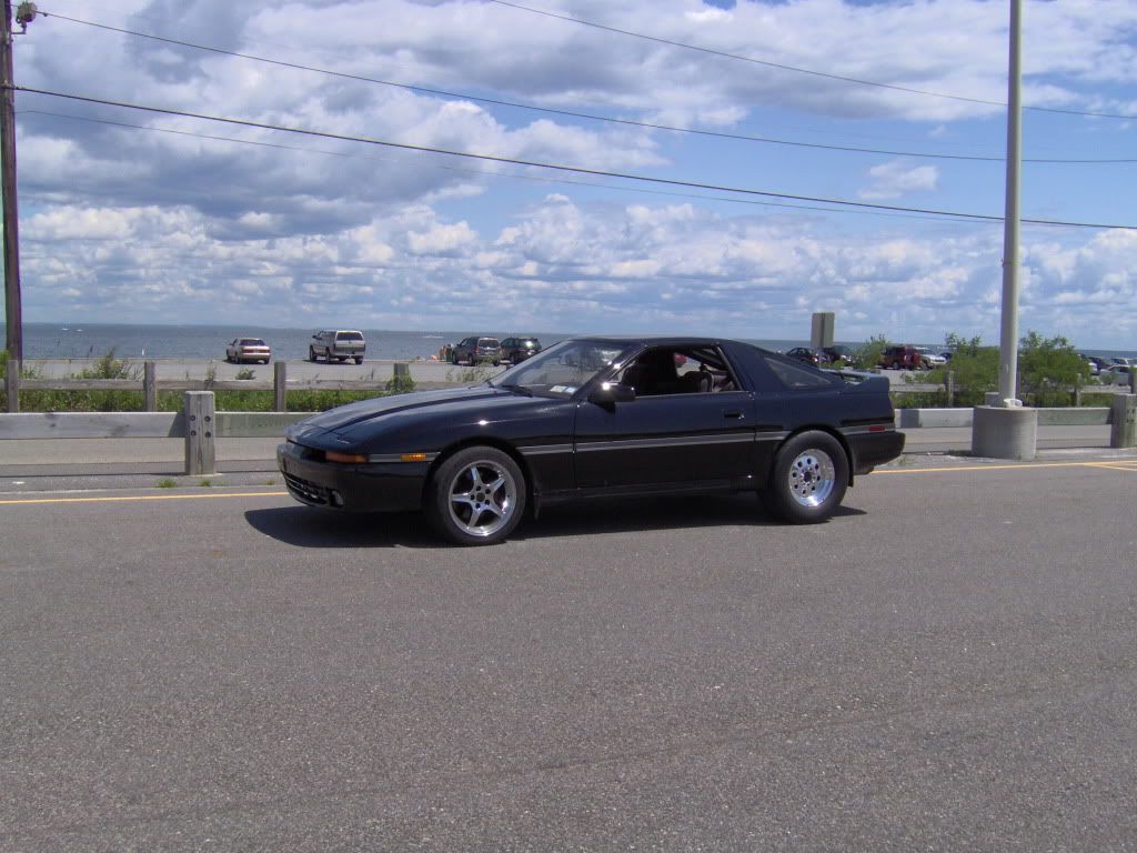

I got my new wheels for the drag radials. They came late in the day and i didnt want to wait so i mounted them by hand and got them ballanced the next day.
I took a few pictures of the car now that i got the new wheels and tires installed.

Is it safe to just move the pcv lines like that? I want to do the same exact thing but I always say "It's there for a reason" and without doing my research I don't like to mess with things. Any info would be great, thanks.
TurboStreetCar
Formerly Nosechunks
Feb 25, 2006
2,779
13
Long Island, Ny
Thanks!
Well there are baffles in the valve covers so that oil cannot splash up and get pushed/pulled out of the motor.
The baffles go from the back of the cover to about where the lower section is for the intake tube. These valve covers are from a non turbo so the PCV tubes are in a different location then a turbo. The passenger side vent falls right under the throttle linkage so that one had to be relocated. I cut the tube off and filled the hole with silicone then re-drilled another hole at the back where there is no obstruction.
As long as you put the hole where the baffle is i cant see there bieng any problems. I think they put them where the put them because thats where they fit on that particular engine setup.
