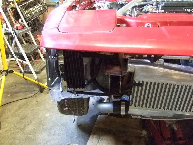

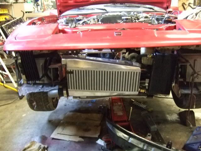

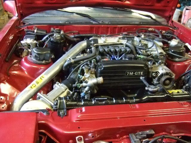

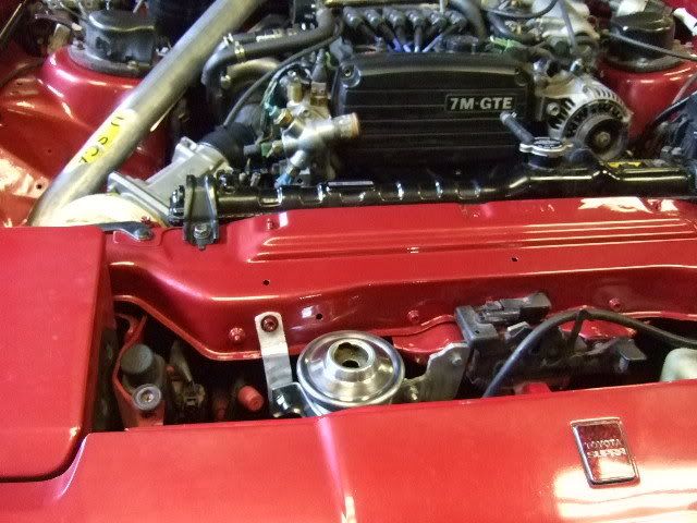

Since I am runing the stock oiling system on this motor I figured the least I could do was put a slightly better cooler. I had an stacked plate oil/trans cooler laying around so I make some mounts and ran the lines. This took longer than desired and I had to run back and fourth between the fittings store a few times before I had what I needed.
I used the old oil cooler as a powersteering cooler, I didnt have much room left so its not exactly in an optimum place for airflow. It should disipate substantially more heat than the stock setup even whithout much airflow.

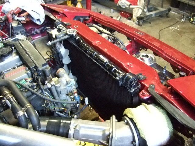

The radiator, fan and belts are all back in
Put my PS resivor in its new location and ran all the lines

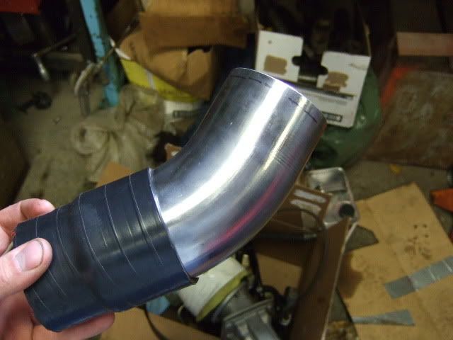

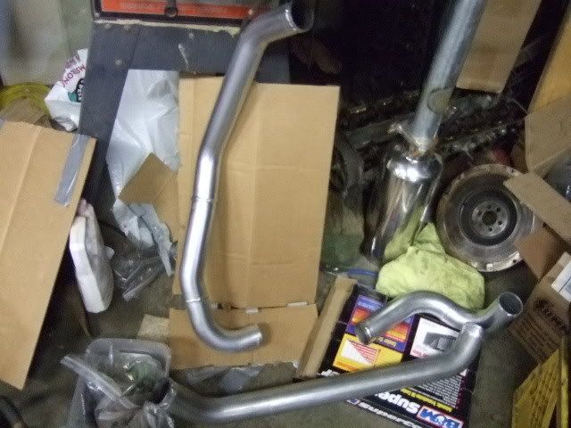

This was the first time I have had an eninge in the car to see how close my ic pipes came out. I was pleased to find all my measurements were right and everything lined up. All I had to do was cut each end to length and run a bead to keep the couplers on.
The bottom was 3 separate sections we bent up, heres the whole system nearly finished. All I have left is to weld flanges on the upper pipe for the BOV, and on the intake pipe for recirc, pcv, ect.

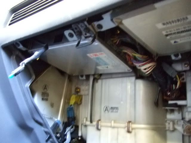

Put the ECU back in

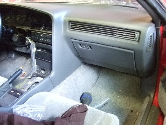

And the Glove box and lower panel
