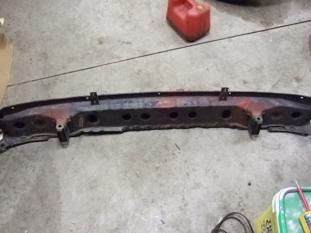

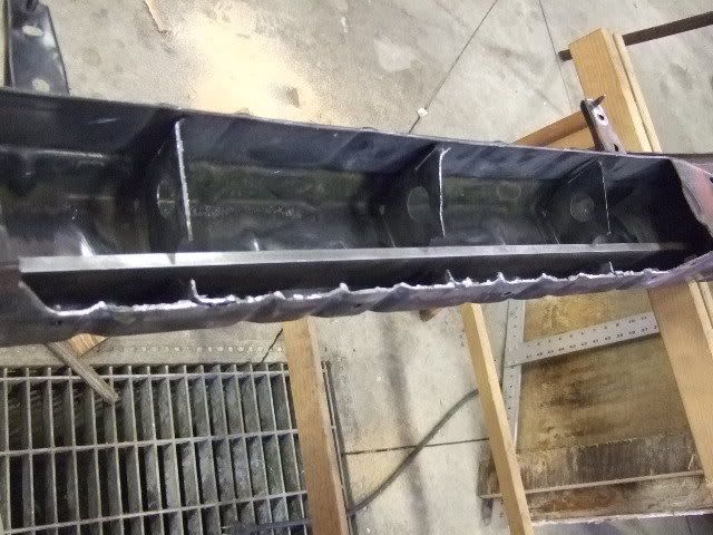

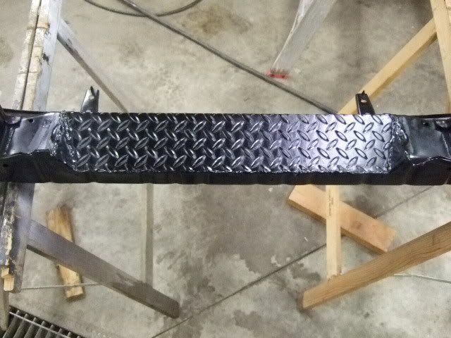

didnt get a chance to work on anything today, but I promised an update so heres what I got done the otherday.

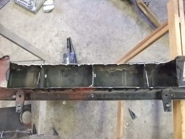

BEFORE

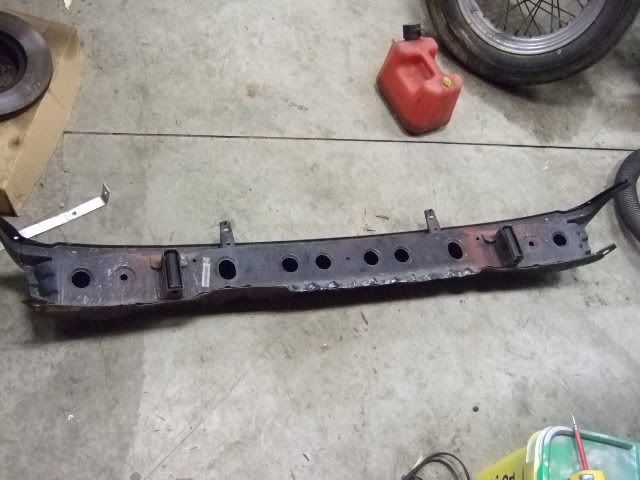

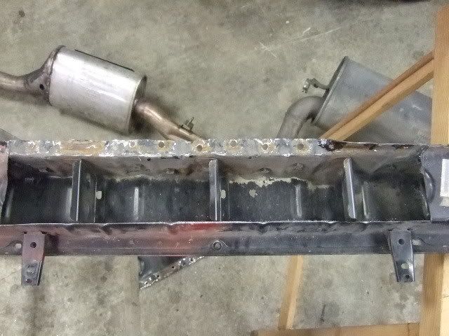

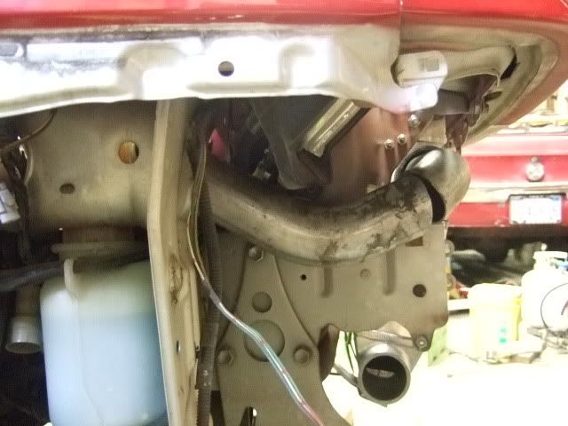

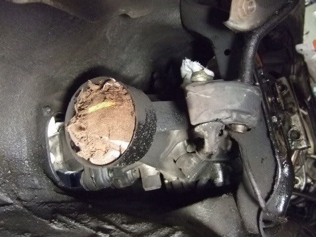

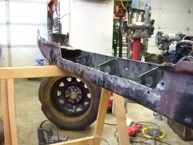

If you've ever wondered what the inside of your bumper support looks like

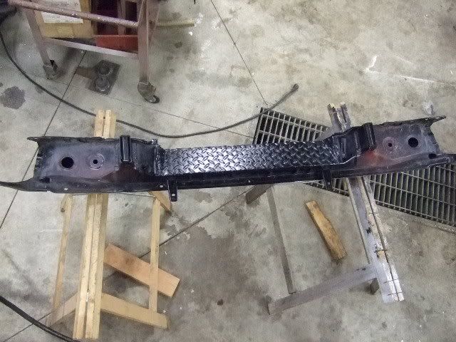

Heres what it looks like now

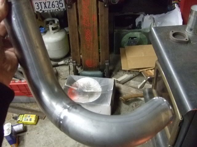

Heres my mock up section of of IC Pipe
Im hoping I can make a trip out to my bender on thursday. Im going to have to do my IC pipe one section at a time to make sure everything fits right since Im going to be working with such limited space. Im also working on a slide in and out mount for my oil filter location kit due to the lack of room

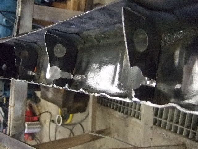

I did a little work on the bumper today got it notched for the support bar. Im hoping tomorow I can finish it and get the first section of my IC pipe welded up.

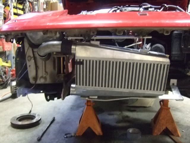

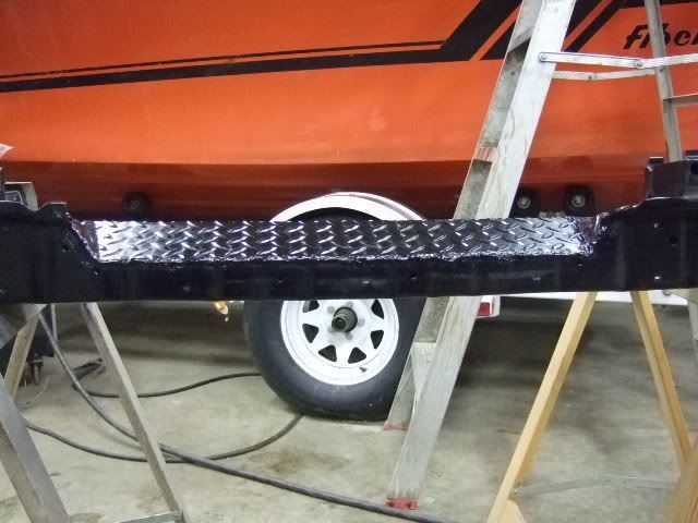

I got my bumper finished today
It should direct a lot more air through my intercooler than before, Thanks IJ :icon_wink

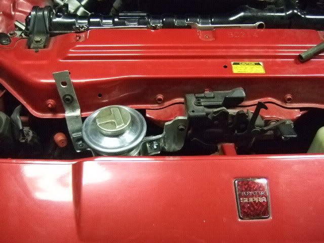

I also figured out how Im going to mount my oil filter and got the mount partially built. As well as started polishing my Power Steering Reservoir. Ill post pics tomorow

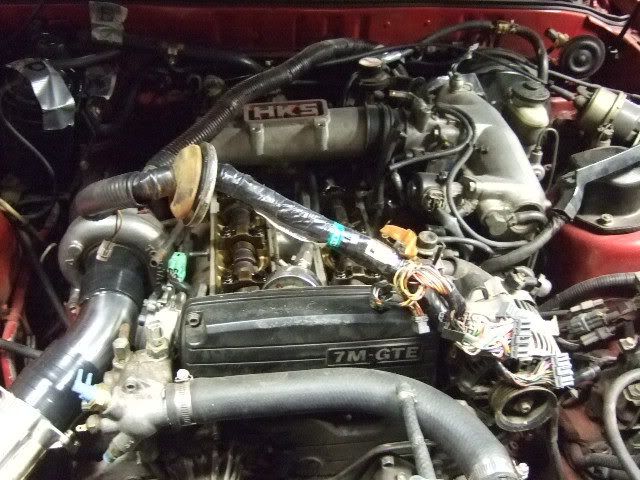

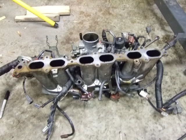

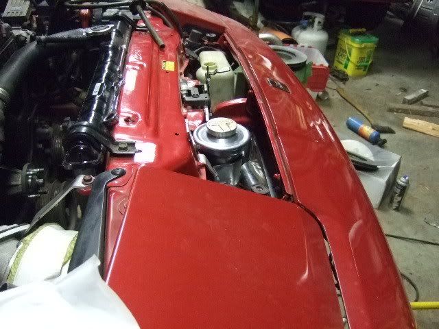

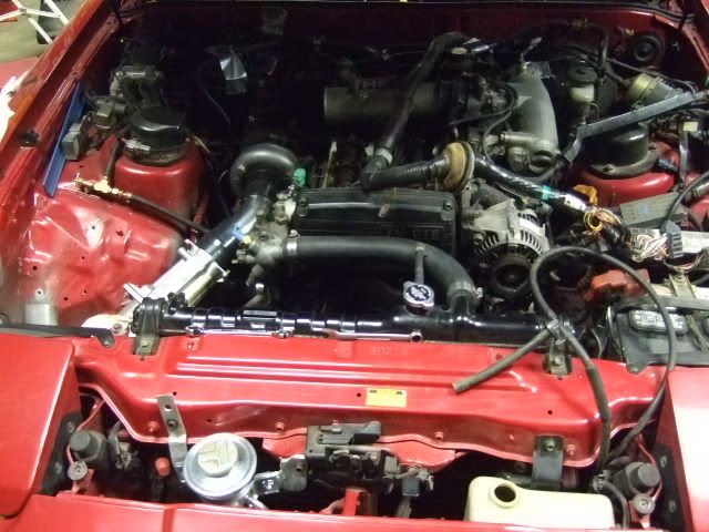

I got quite a bit done today.
I decided to move my power steering Reservor to clean up the engine bay a bit and make my intake a little easier to build. The brackets need cleaned up a bit but I think the new location looks much better than stock.

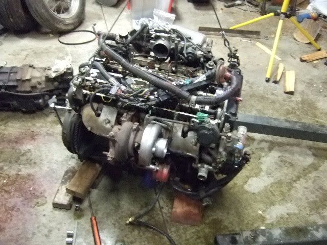

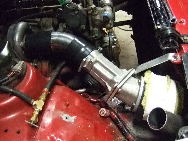

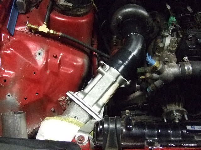

Heres what my turbo intake looks like, I just have to weld in the ports for my pcv, and BOVs

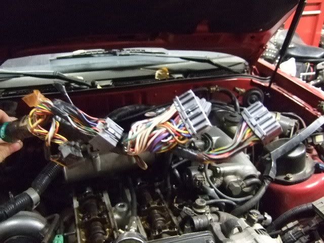

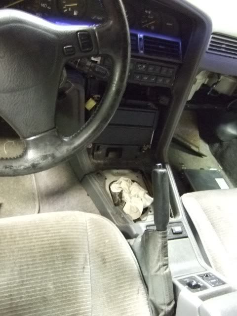

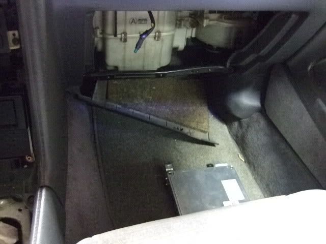

I also pulled the ECU today and snaked the monster of a wiring harness through the firewall
This actually took the longest of everything I did today, Probably becuase I did it without removing the shift knob or boot. I got the panell and shifter out in one piece
I doubt I get to work on it tomarow but by monday, My goal is to have my calipers and rotors blasted and painted, driveline dropped, Heater, vacuume, fuel lines and the rest of the wiring disconnected, transmission fully disconnected, and the rest of my oil filter mount done

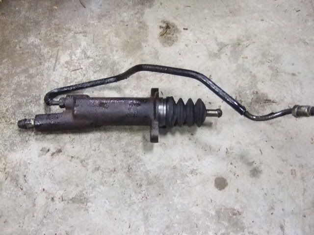

I got about an hour in yesterday, and managed to get a little done.

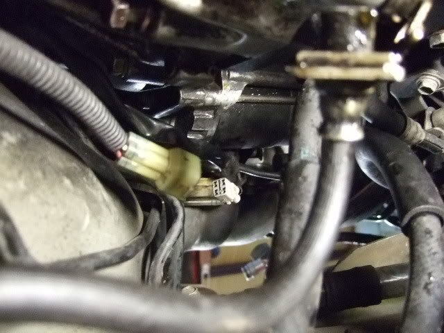

The tranny is unhooked exept for the mount which will come last. I took off the speedo, ground wires, and unhooked the sensors, as well as pulled my slave cylinder.

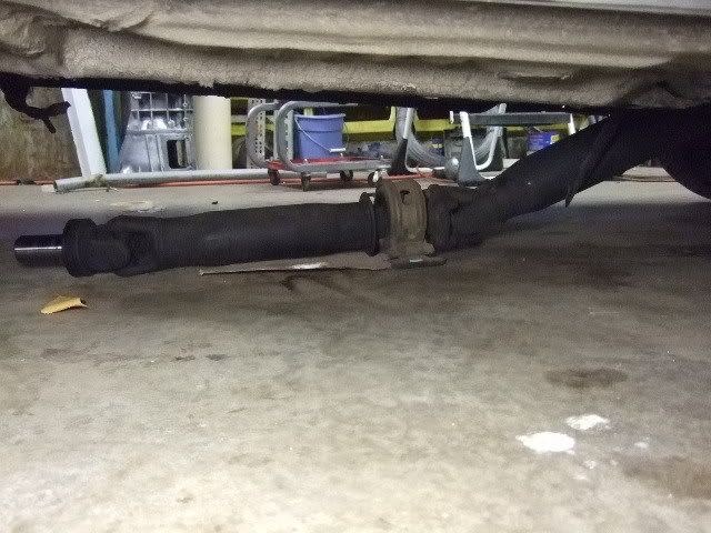

I also dropped the driveshaft yesterday

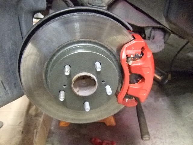

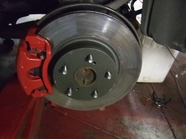

Got quite a bit done today, My Rotors and calipers got sand cleaned up primered and painted and reinstalled.
I also welded up the first section of my new IC pipe, My bender has the mock ups of the rest of the system and should be getting it back to me anyday.

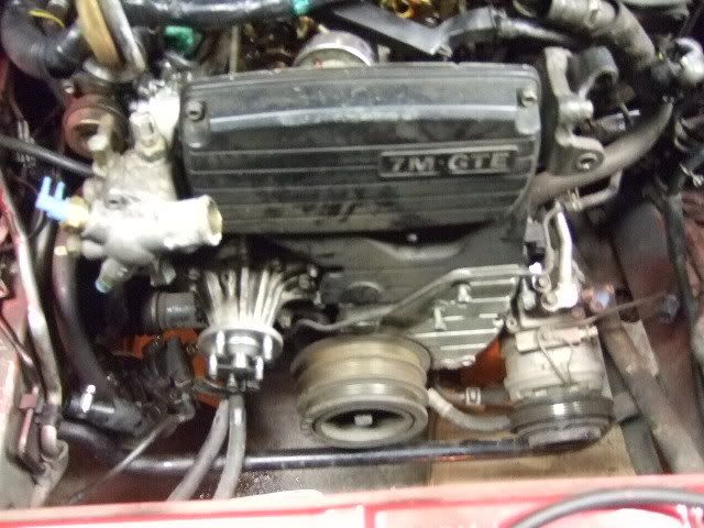

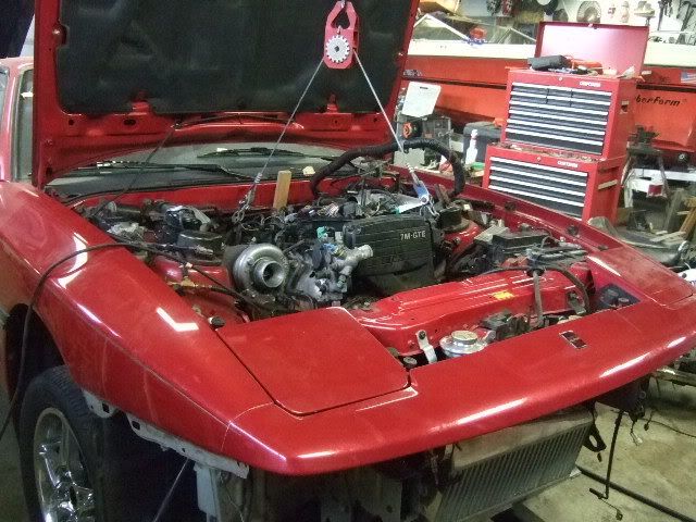

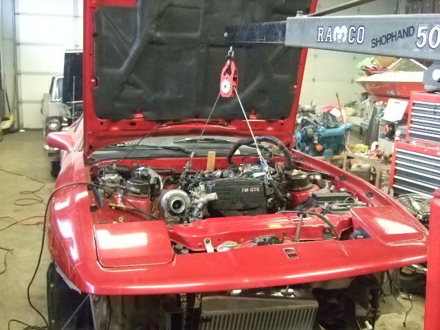

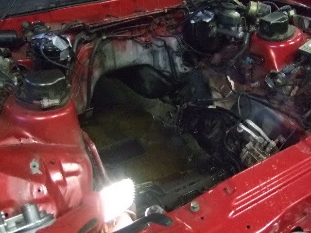

I also got the front of the engine pretty much stripped. All the belts as well as the fan, PS pump and AC Compressor are unbolted and wired out of the way. The radiator is out and the motor mounts are unbolted and any other wires and hoses I hadnt got to yet are also off now.
Looks like we might have to dust off the hoist tomorrow:naughty:

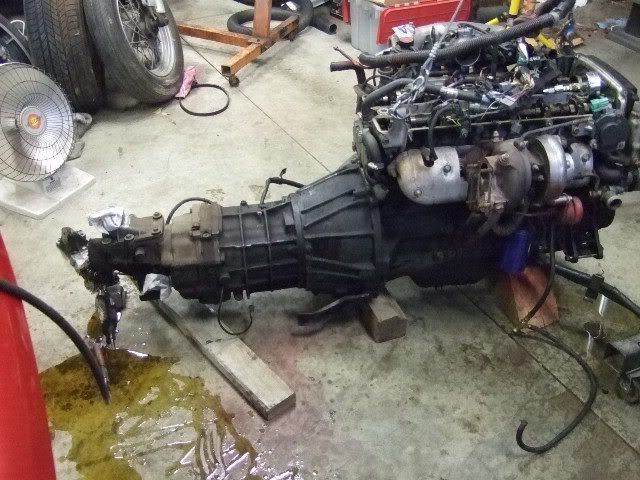

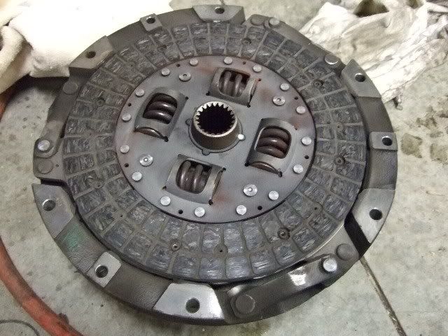

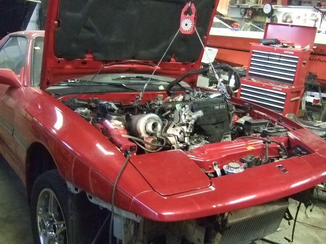

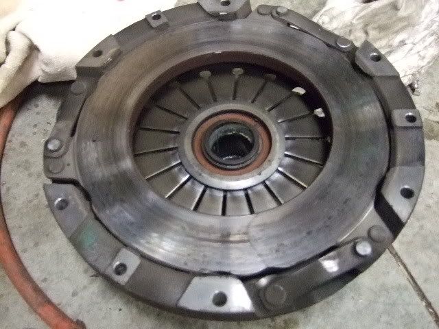

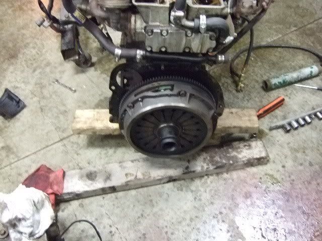

ITS FINALLY OUT!!! I got quite a bit done again the other day

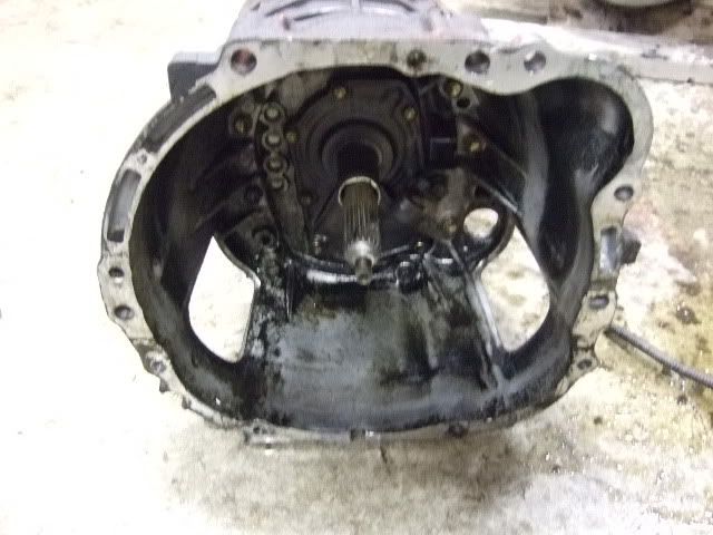

I also pulled the transmission, Looks like Ill have to re-silicon the front seal
My clutch and pressure plate look really good, doesnt look like it got any oil on it

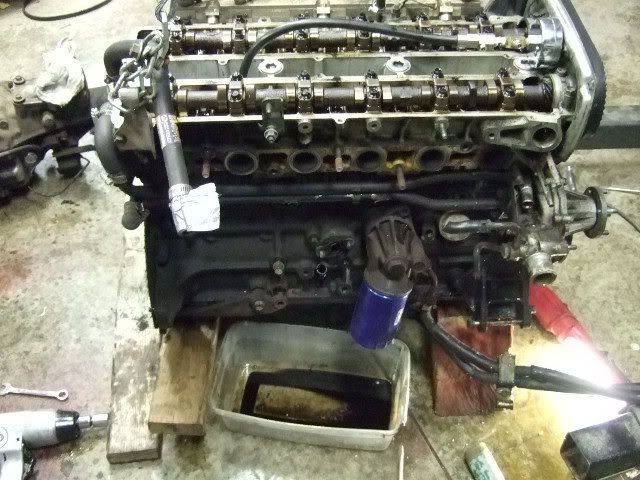

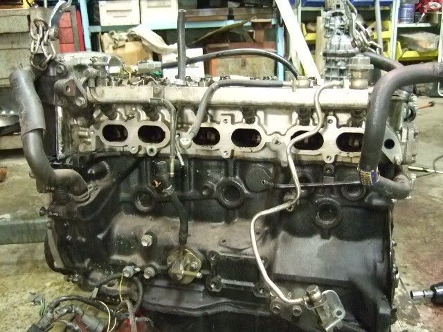

I pulled the intake manifold, it could use a good cleaning

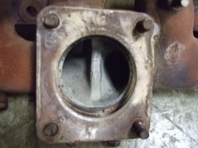

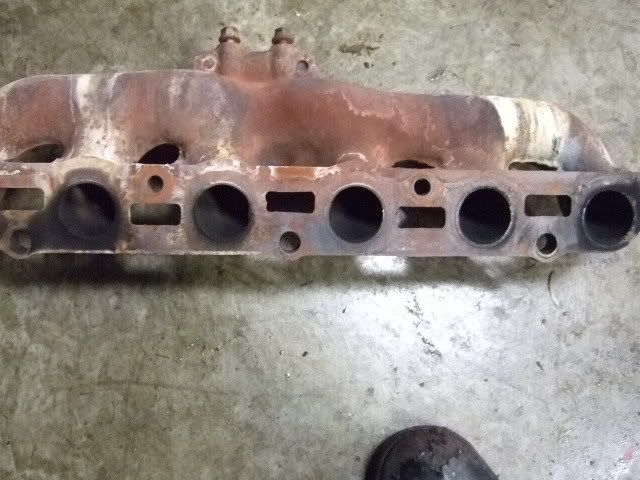

And the exhaust manifold

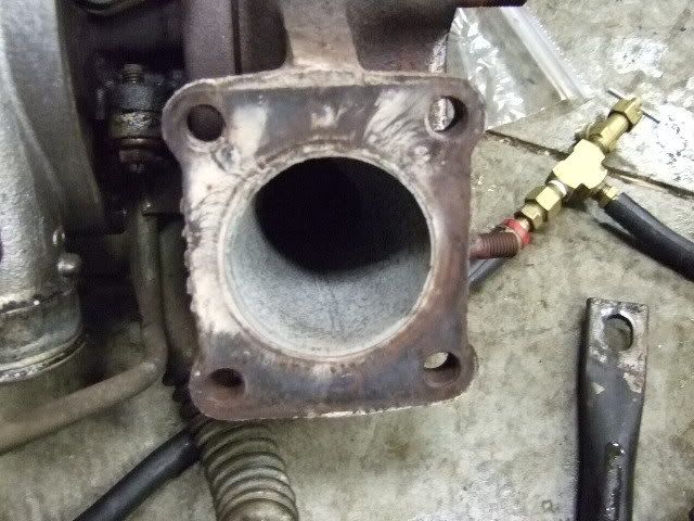

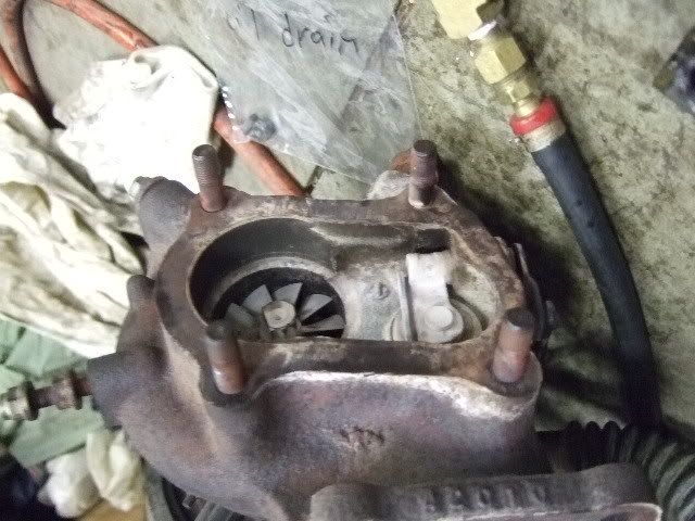

I found something strange when I pulled the turbo off. The inside of my turbo and manifold were white? At first glance I though Sh#T this thing was running lean but quickly drew the conclusion it must have been from burning coolant.

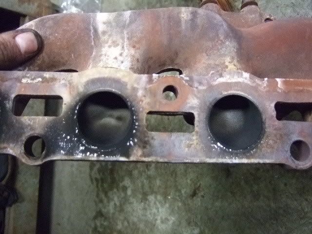

After taking the manifold off I was even more confused. The exhaust ports on both the head and the manifold were black and sooty just as I would expect, and the head gasket was only slightly blown on 3 cylinders? So on top of it looking normal on the engine side of the manifold I highly doubt it was burning enough coolant to cause this much deposit. The white look similar to calcium deposits and is hard and pretty rough and textured unlike regular exhaust carbon build up. In the manifold it starts black and transitions to white 1-2 inches down the runners.
I cant really think of any clear cause. I started thinking mabye my turbos exhaust housing is cracked and coolant was leaking into the turbine housing and getting vaporized. Nothing exactly fitss in my mind as I dont know why the deposits would start in the manifold if it were a crack in the turbo and I dont know why they wouldnt start back in the head if it was burning that much coolant??? Any ideas or experiences are greatly appreciated, Im pretty stumped
Also could someone clarify if the crank pulley nut is standard or reverse thread? I raped my breaker bar trying to crack it loose and started questioning everything I though I knew lol. And any preference on 3 in elbows? (Lipp, vs JLB)
thanks guys
63
Seen the white inside the housings a few times and it's usually something in the fuel.
The white on the outside looks like fluid leaks.
Yes the crank bolt is normal righthand thread but it's 195 ft/lbs.

ya I got the gasket set looks good, thanks. So the white isnt anything to worry about then? I just hadnt seen it on any of the other supras Iv worked on. As for the crank bolt I was sure it was righhand, at least I though it was thinking of the last two I did, but after it snapped my 1/2 drive breaker bar I started second guessing. Sure supprised the hell outa me when it happened:biglaugh:

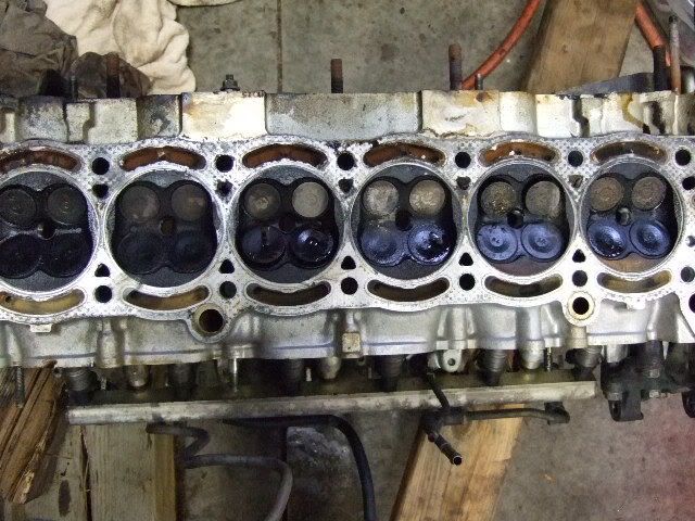

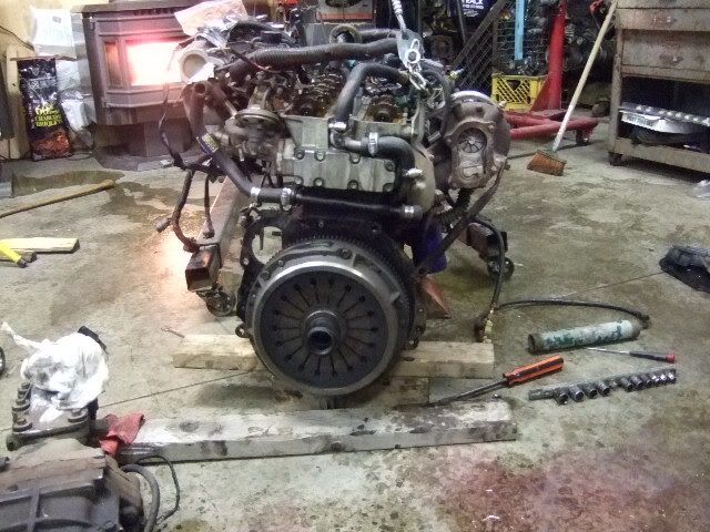

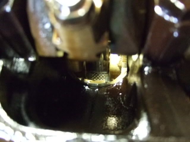

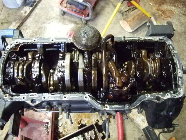

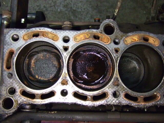

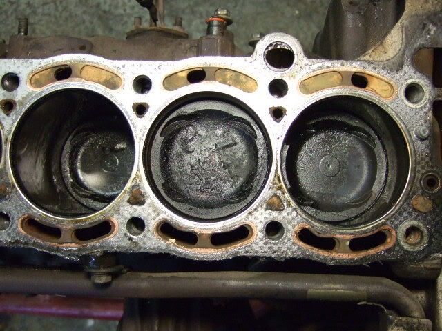

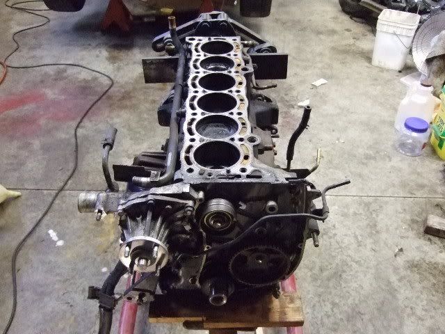

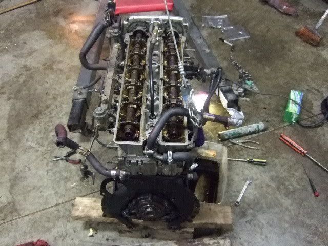

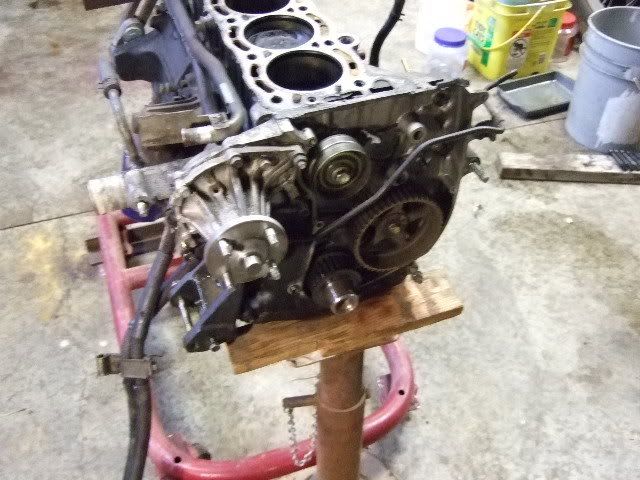

Made the trip home and got a little work in this weekend. I had to work all day saturday so I stayed up till 2 in the morning getting the motor on a stand and pulling the crank pulley, lower timing cover, timeing belt, head and pan. The arms on my engine stand wouldnt reach the upper two bellhousing bolt holes. the were too close together so I made a plate that would bolt up and provide wider mounting points.
can you spot where its blown?
heres cylinders 1,2&3
heres 4,5&6
heres a shot of whats under the pan, its looks really clean
gotta love those oil squirters, pistons so clean you could eat off em!
heres a shot of what the CCs look like
Next weekend will probably be devoted to cleaning, and theres definatly plenty to do.
