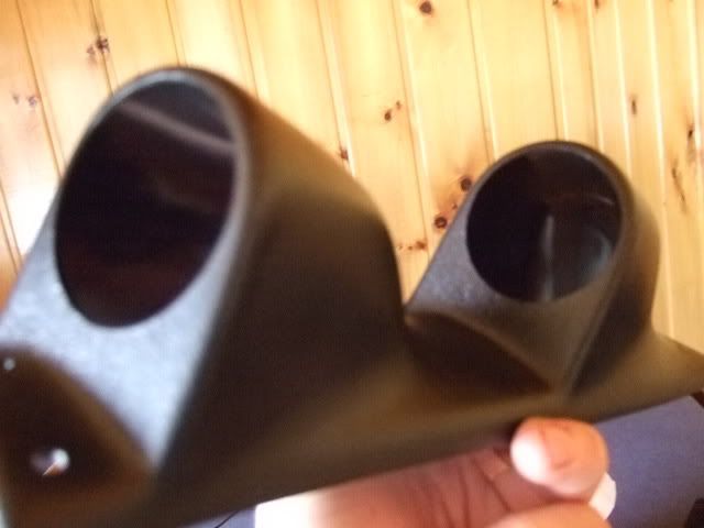

I got a few more parts in for the interior
and a few parts to use to make some fiberglass molds, for some custom parts

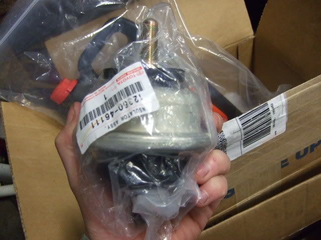

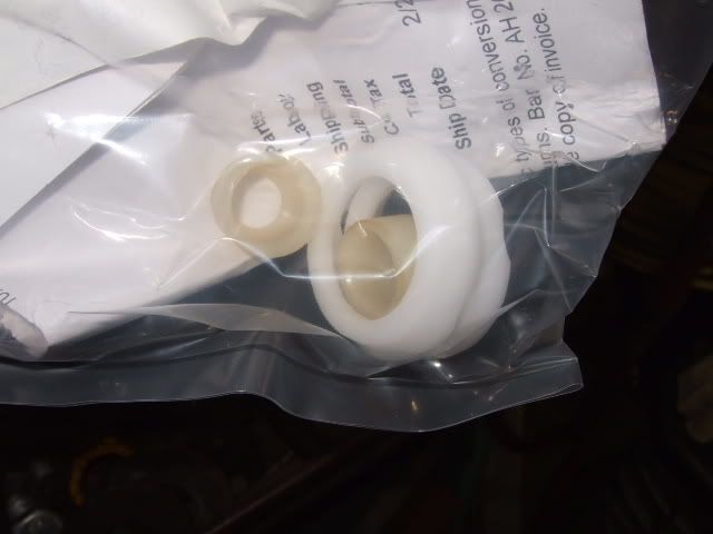

A few boxes containing some of the greatest things ever put on this earth; REDLINE and NEW TOYOTA PARTS!
Big thanks to Jeff at champion youv come through again
I wanted to go with the original mounts to retain as much of the "lexus ride" as possible but in the end the price just wasnt worth it. These should only be marginally stiffer and should hold up much better

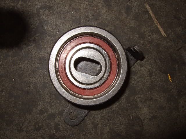

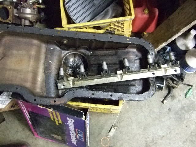

I found a NA in a junk yard, had a timing belt job done less than a thousand miles ago. Had the service sticker and everything. Looked like he had lost a valve retainer, cracked the head and chewed up a piston. someone had cut the timing belt to get the head off but I got the timing tensioner for a buck.

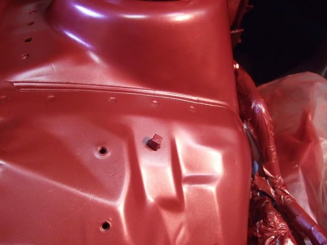

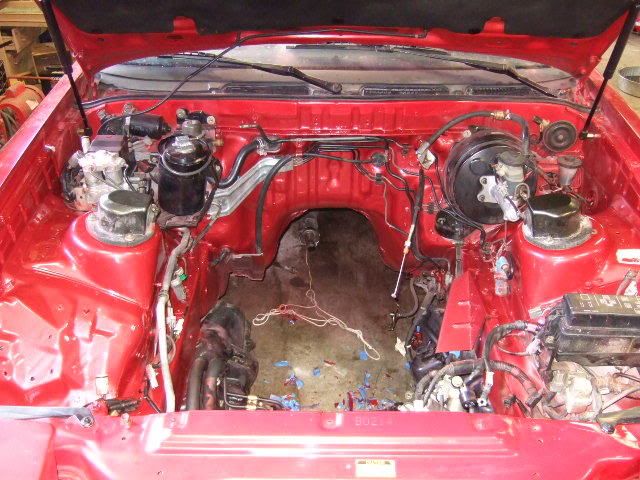

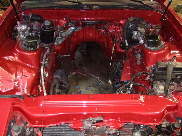

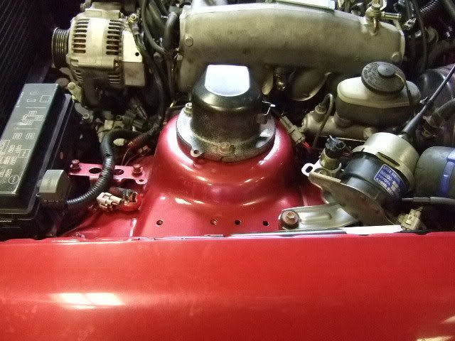

heres the engine bay after being hit with basecoat
I had to do a little sanding and some touch up on the basecoat. You can see in the top picture I didnt pick the best tape line just under the winshield cowl on the firewall. I had a pint of paint basecoat that the prev owner said was left from when the car was painted. It ended up coming out a little darker than the original paint. It could either be an extra pint he had mixed & the pigments were mixed incorrectly or the paint settle so much in the past 6 years that the shaker couldnt even remix it properly. I had to wetsand the tape line down smooth and reshoot it along with a few other areas. Heres what it looks like after its been hit with a few coats of clear.

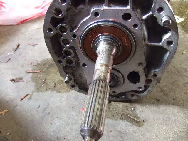

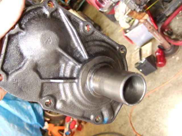

I had to replace the imput shaft seal on my tranny. Here's whats behind the front cover if anyone has ever wondered.

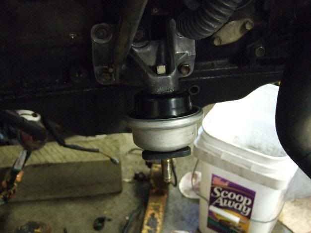

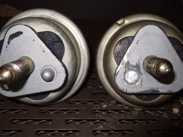

Motor mounts are ready to go in, incase anyone has wondered what pin needs to go to make MKIV mounts work, here you go
Group Buy FTW!

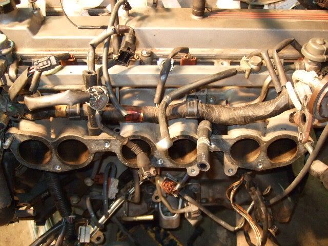

The wiring harness is on for the most part.
This motor is an 88 so I had to change one or two of the clips to put it on this motor. I have a guy who has another 5spd harness he wants to get rid of so I think Ill pick that up so when I go to swap back I can have a harness on the my original motor and ready to go in
The one that was on the motor was pretty trashed. All the injector clips were gone along with one or two other clips. It was for an auto so it wouldnt have been of much use anyways

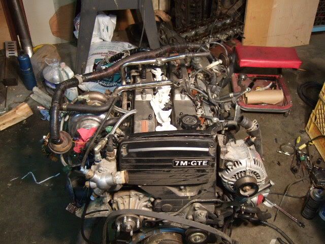

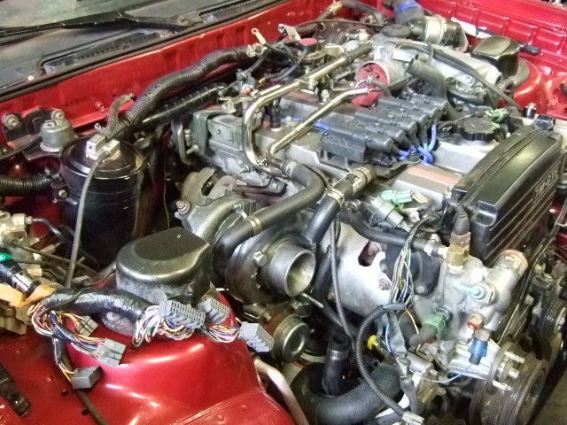

Me and Louis put in a lot of hours this weekend. We stopped and saw justin on our way through spokane and attemped to sort out his maft pro issues.(well Luis did, I watched and wondered why his car sounds like a Subaru :greddy:)
We didnt get started untill five or six on friday and had our work cut out for us.

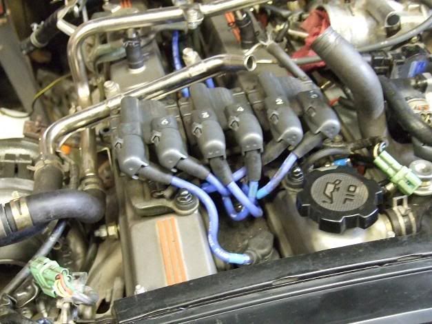

Finished up the wiring and put the plugs, coilpack, and wires on
Put the upper intake back on and hooked up the vacumelines and remaining sensors. We also had to swap another connection that differed between the 88 motor and 89 harness and had to reattach another that we pulled off in the process of putting the intake on. Luckily I had a spair with 8in of lead.
Swaped the boss for the superior ct26 :sarcasm:
Put the MKIV mounts on

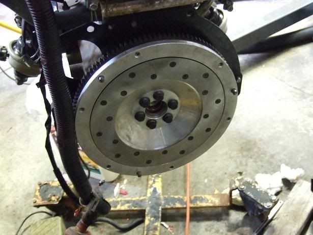

Got the flywheel on, locktited and torqued.
All that took quite a while due to the fact I had all these parts bagged and boxed up, so it took some digging. It doesnt look like all that much work from the pics but thats in part because we were so busy I forgot to take very many pictures. By this time it was about 2 in the morning and then we hit our major road block. After putting the flywheel on I realized this motor was an auto, why I didnt realize this would be a problem when we were taking off the kick down linkage I dont know but the crank had no imput shaft nose bearing!
So we did what we could that night in the engine bay, putting the cuise an misc sensors in and called it quits around 3:15.
Not bad exept I had to get up at 4 to go to work. So I slept for 45 min when to work, got off around 9 and picked up the bearing and some vac line. We got back to work around 11 put the clutch, tranny ect on. Motor tipped the lift almost killing luis you know the usuall.

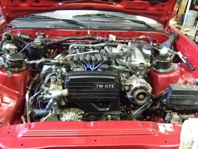

lone and behold by the end of the day
ITs IN!

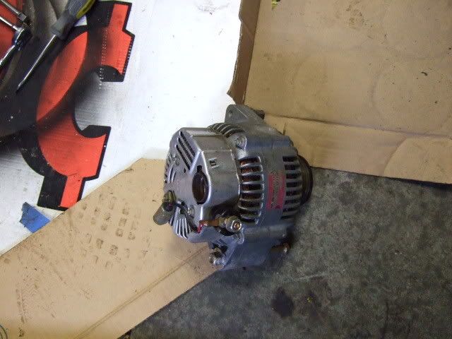

Got all the wiring, fuel lines, driveshaft, ect hooked back up. This went pretty smooth other than having to swap alternators because the studs were different sizes.
I opted to stick with the stock oil system for now as I dont have all the lines for my full flow/ relocation kit. Ill get it all figured out an put it in when I swap motors again in a few months. I am using a better cooler than stock though.
Picked up a spair pan and some fresh injectors from just for a great price thanks buddy.
So all thats left now is to mount the oil cooler and run lines, hook up the ps resivor and finish fabricating the intercoolerpipes. I am hoping I can finish all of these things up the weekend of the 19th. So it looks like shes GOING TO CENTRAILIA!!!
