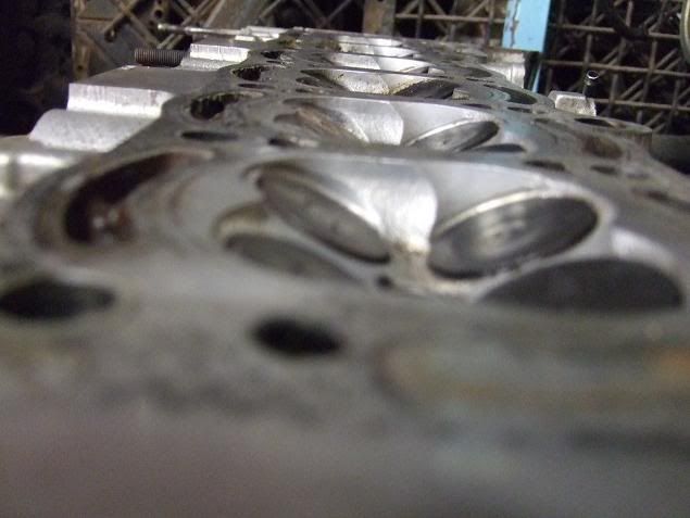

Heres a shot of the head surface and CCs after somecleaning. If you scroll back to before you'll notice the huge difference.
Heres the Intake side after a bit of cleaning
And the Exhaust, you can see where the exhaust gasket was leaking it was completely separated into two halves

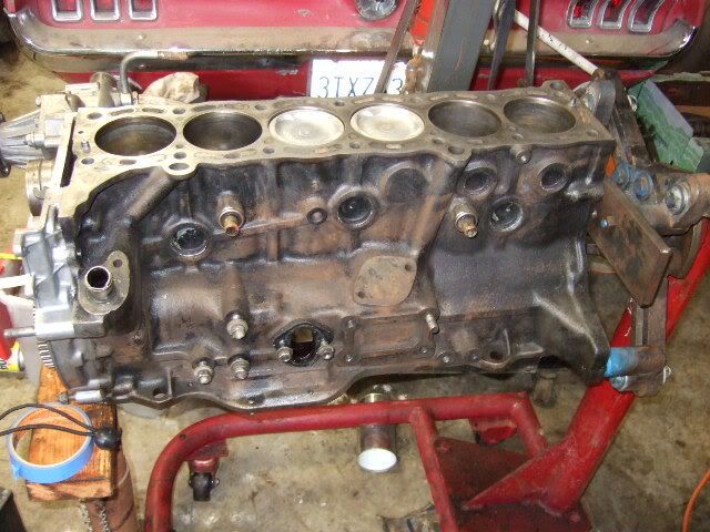

heres the gasket surface and pistons, the deck deffinatly needs some work to get the gasket off
heres the sides of the block, all the oil and grease is scrubbed off and any loose paint is gone, its pretty much ready for primer and paint

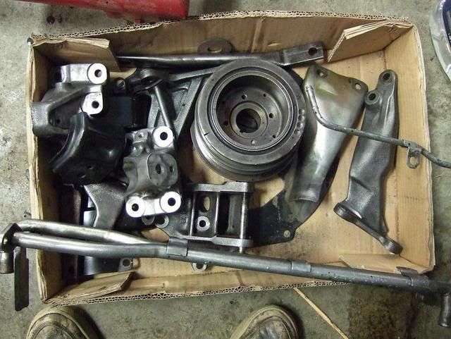

I also cleaned up the water pump and the under the lower timing cover

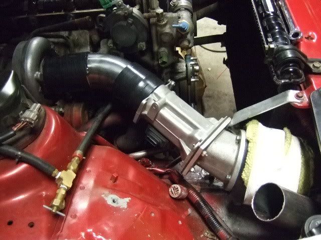

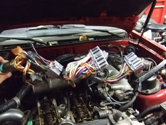

heres the next project to tackle, wrestling the wiring harness out of the intake manifold, taking the electronics off and cleaning it up.

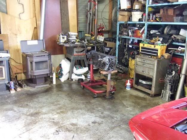

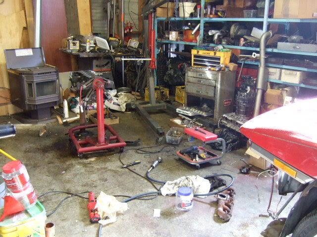

The worst part of only getting 1-2 days to work every 1-2 weeks is cleaning becomes the last priory. So I had to take some time and do that this weekend
I forgot how much easier to work in a clean shop

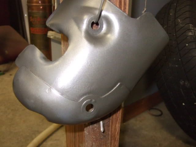

This is the cleaning stage of the build. Got these parts prepped for paint

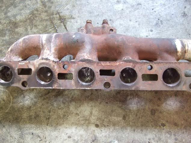

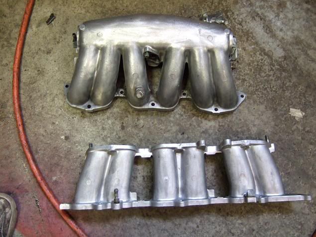

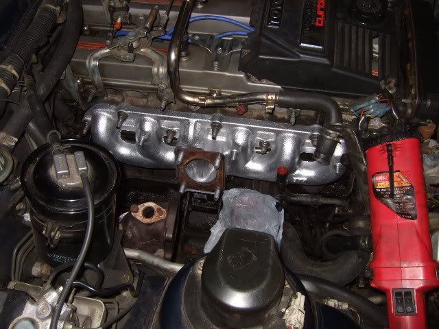

Shined up the intake mani
Began porting the exhaust manifold

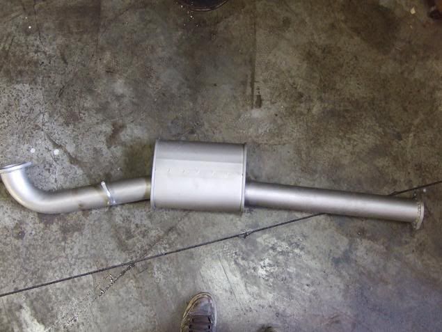

Picked up a partial exhaust for dirt cheap, Now I just need a rear muffler to go with it.

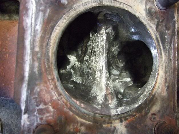

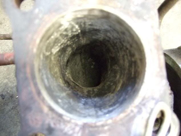

I was able to finish porting the exhaust manifold.

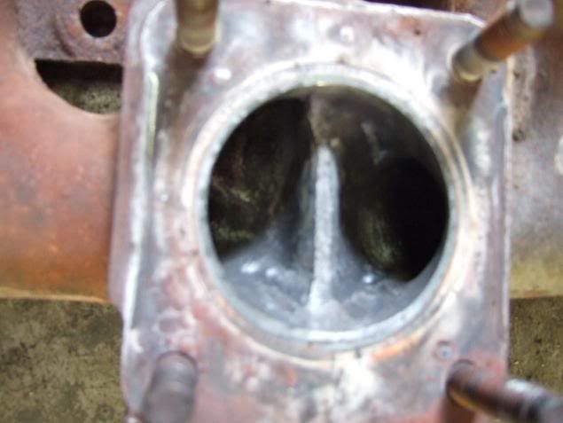

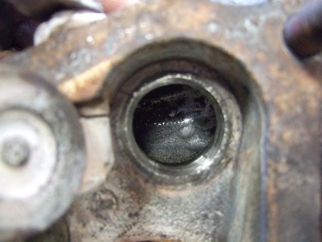

The turbo to mani gasket was about 3mm wider than either openings so I matched both to it. I also went over the inside of the exhaust housing to get rid of the carbon build up.

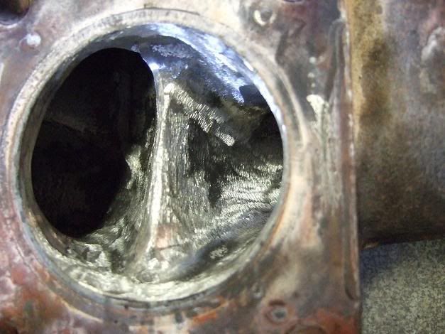

I ported the wastegate, theres room to open it up a good 5-6mm and still have good overlap with the flapper. This should give me a little more contol over boost levels and will allow me to set the boost all the way back down to the stock range if I choose.

Im a bit behind on upates but I got the motor back from the machinist and bad news. Well actually somewhat expected news, the block needs a little more than a lapping to pull off an mls. So its going to get completely tore down. Its just a shame to toss rings with 24k on them. Anyways Im going to put my spair motor in the car for now, so I can take my time and rebuild this one over the next few months. Now I have to find a good machinist in spokane, and figure out what rings and bearings to go with. Looks I can still have it back together for centalia so that is good news

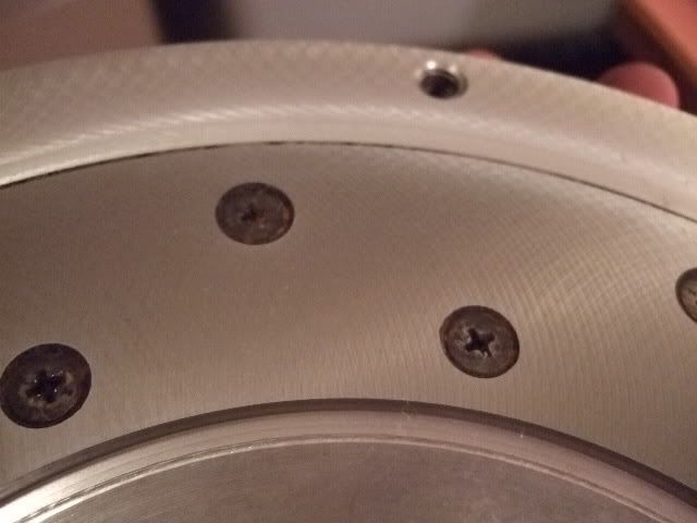

I also got my fidanza flywheel back from the machinist, I had him surface it and set it up so I could run the stock disc
you can see where he took out the inside diamiter out about 5mm to clear the rivets on the stock clutch disc. I would done it my self but I didnt want to have to deal with finding a way to center it on the lath. Plus he hooked me up

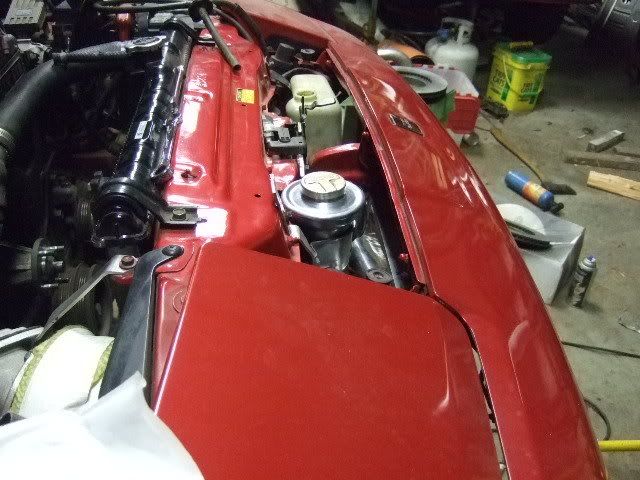

Im heading home this weekend if anyone wants to lend a hand. If all goes as planned I can get a few touch ups done on the engine bay, grind the pins off my motor mounts, finish painting some brackets, and get the tranny and wiring harness on the motor so its ready to go in.

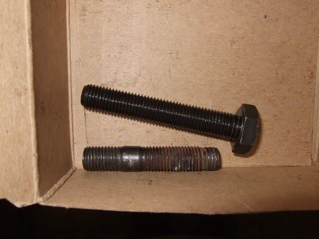

The exhaust manifold was leaking on my brothers car pretty bad so we decided to change the gasket. and cleaned everything up while we were at it.
3 of the studs stripped out in the process. We decided to helicoil it in the stock size rather than go to 7/16 so incase it ever happens again we can take them up to 7/16. We found that the threads in the head were actually twice as long as the threads on the stud, so we decided to get longer studs. The only problem is nobody in spokane carries 10X1.25 studs even in the stock size. which I thought was strange, if I recall correctly toyota has used that thread on different things all the way back to the 22Rs. The original studs that came out were corroded and toyota said it would be like 3 days before they could get them in. We decedided to make our own. I found some 60mm 10.9 grade bolts, the stock studs being 55mm.
We put them in the lathe and turned the heads down so next time the manifold needs to comeoff we can grab the ends with vice gripps to prevent putting any torque on the head.
Here you can see the difference in length between the studs we made and the originals.
