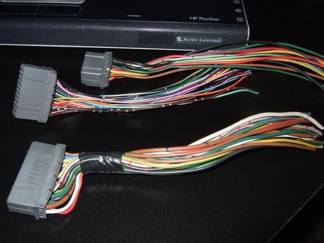

Rather than splice the maft pro into my harness I decided to build a jumper harness for it. I started with the board and harness pigtails from a cressi at the local yard.

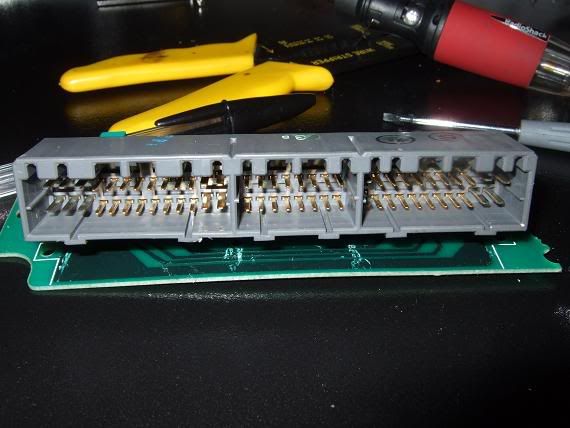

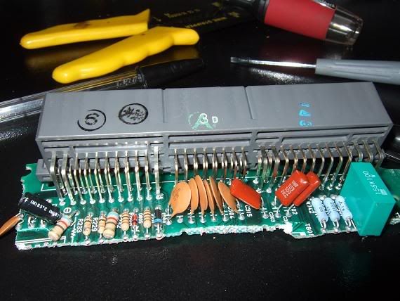

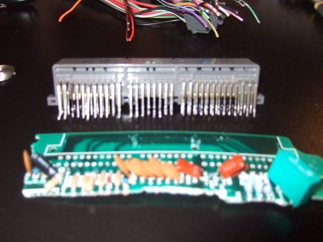

I then desoldiered every pin connecting the female plug to the board

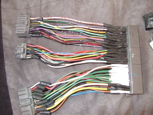

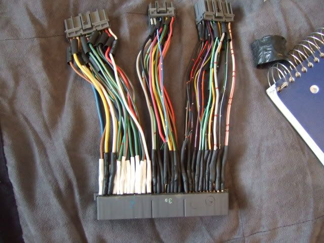

Next I straightened all the pins and soldered and shrink wrapped every pin to the proper lead from the pigtails.
Not to bad if you have alot of soldering and wiring experience but still time consuming. If I wasnt away at school durring the week and not able to do anything else on the car it probably would not have been worth my time and I would have bought one.
I then sliced in the maft pro harness and it was essentiall plug and play. Just have to run the harness in the engine bay and hook up the IAT and MAP sensors.
