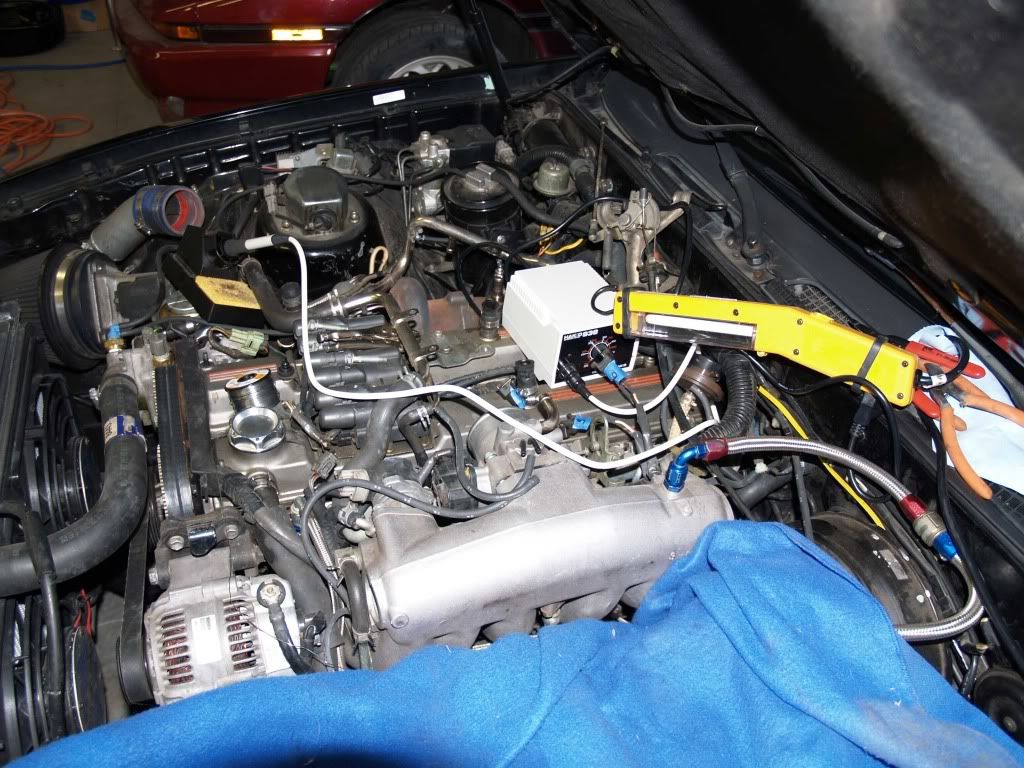

Ok. An update...
I now have the Maft Pro installed and running in AFC mode. It's pretty sweet; but, I can't wait to get converted to Speed Density.
Since I've pulled a little fuel out my clutch is BEGGING for mercy from the additional power.

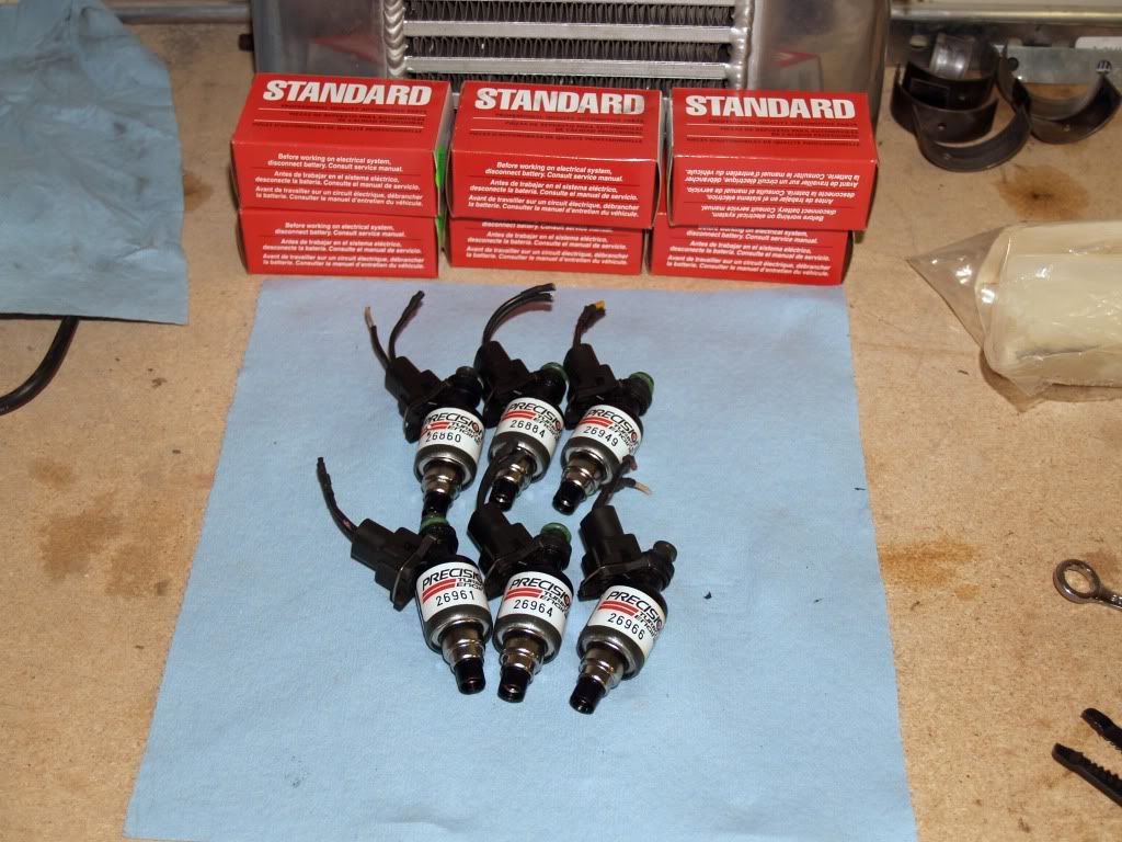

Ok. Here are my PTE 550's that are about to go in. Compliments of DrJonez's part out...
They're sitting next to a set of new o-rings. Tomorrow I'm off to Toyota to order the head-side grommets.
Time to ohm out the clips and start stripping and soldering!

OOOH Nice, I was looking into getting the same injectors, hopefully they work out well for you.
They are direct fit right? Other than the wiring of the clips of course..

Ok Ryan...here ya go! ;)
Progress at this point is that all the clips ohm'd out good and all injectors were cleaned and all grommets and o'rings replaced with new. What you see in the pic are three clips that have been soldered on and each one numbered to avoid any mix ups.
Next...finish soldering the last three clips on, re-install the tb and upper intercooler pipe, test for fuel leaks by running the pump via the diagnostic block, and get tuning... :)
